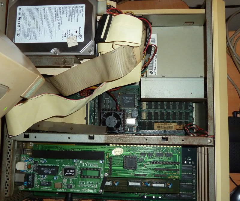

Here We go with a bit of the story about this A4000 since I got my hands on it, on 1996.
What started being an stock A4000/040 with an 120MB or so crappy HD (even for that times), nothing more than the original A3640 at 25mhz and 16MB Fast, soon after got all kinds of upgrades.

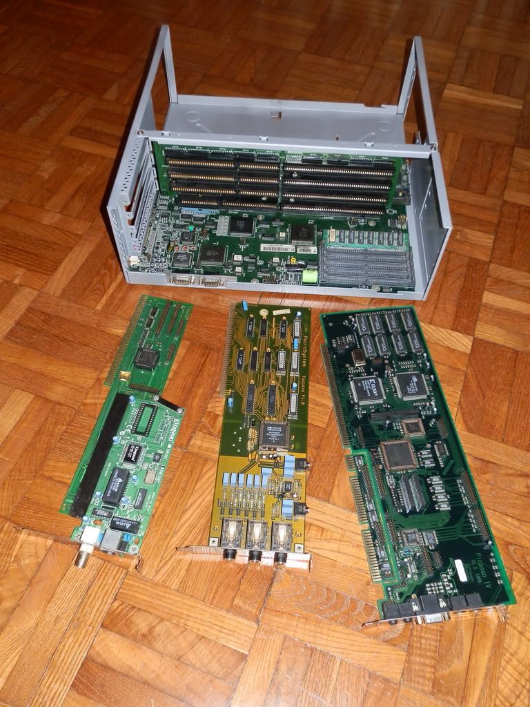

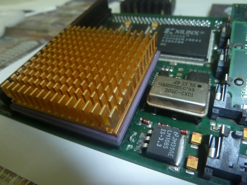

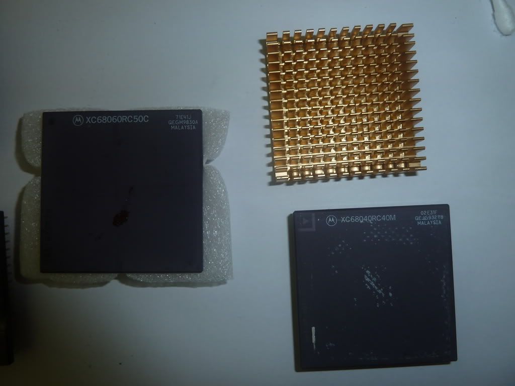

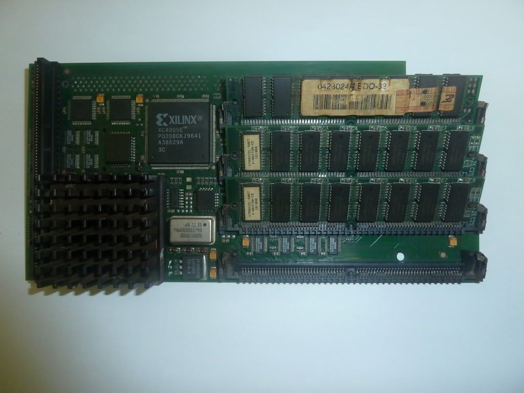

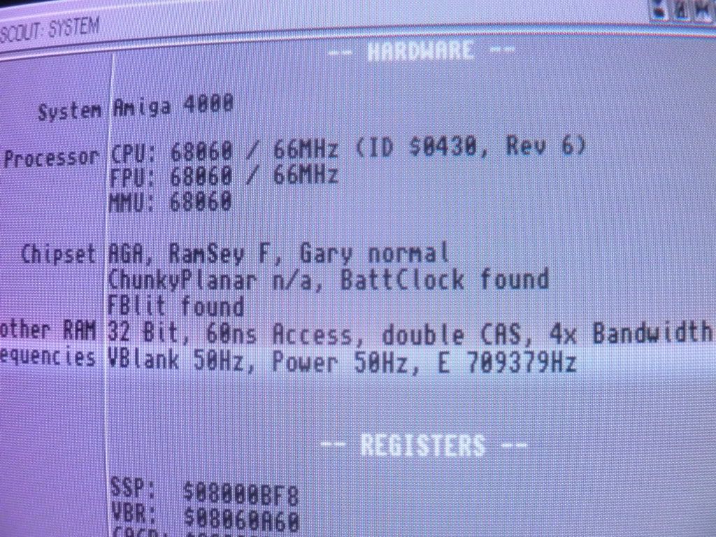

Finally what I have here is an A4000 with the following:

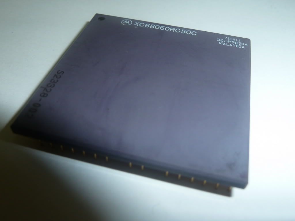

Cyberstorm MKII 060 clocked to 66 mhz (orginally an a 040/40 but then upgraded).
128 MB 60ns Fast ram.
Picasso IV RTG Graphics Board.

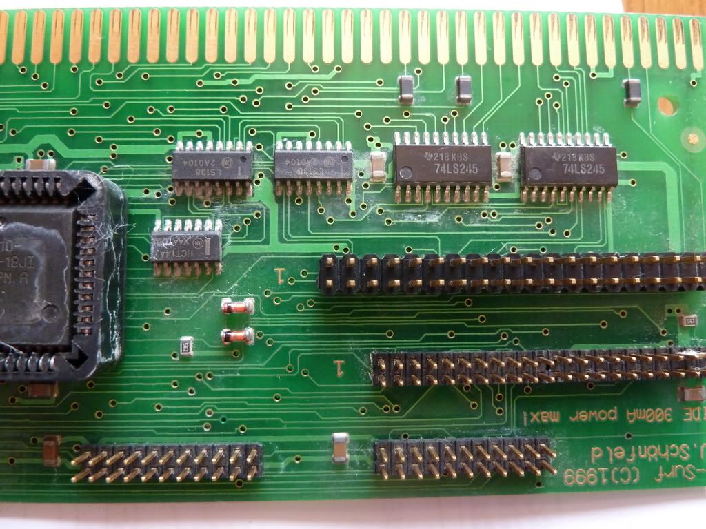

X-Surf ethernet.
Tocatta audio card.
And a 120GB ide hard disk.
This A4k survived a near-death experience years ago when I intended to replace a SMD soldered super buster 9 to a rev. 11 one and commissioned this work to a local so called "electronic repair shop" just to save some bucks. These people resulted to be nothing more than a bunch of cruel electronic butchers, which ended with six or so f****d up board tracks and a ruined buster 11 chip ... :mad:
Fortunately this issue got fixed later, needless to say that this cost me two or three times more money than getting it on more expert hands at a first chance.:(
Later mods included socketed CIAs and a weird/obscure IDE port hack to improve transfer speeds (this hack consist on reprograming a GAL of the mobo that drives the IDE port's logic).
Well, this Amiga was used an abused for several years and gave me hours and hours of fun. And although I used to do a regular maintenance and take well care of it, during the last seven years maintenance was none. So problems started to arose, like f****d up capacitors, rust, rust and more rust, and all kinds of dust and crap everywere. So it's time for me to mend all this mess up before loosing another classic!.

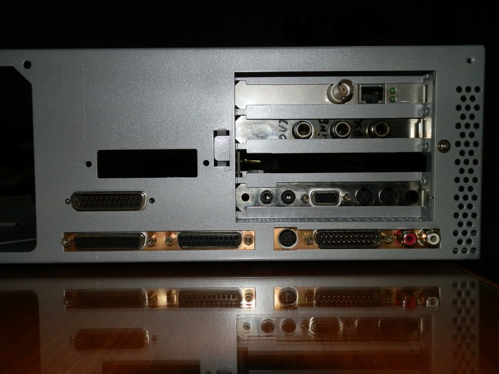

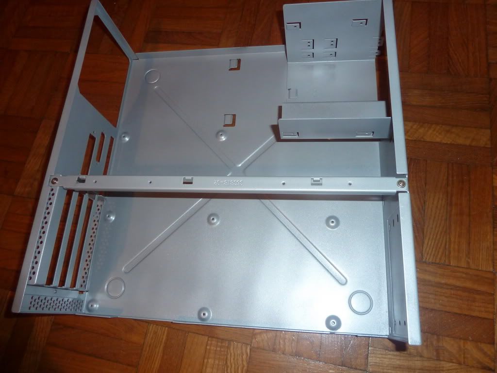

Well, after all this boring blah blah stuff from me :roll: here are the pics of the after state:

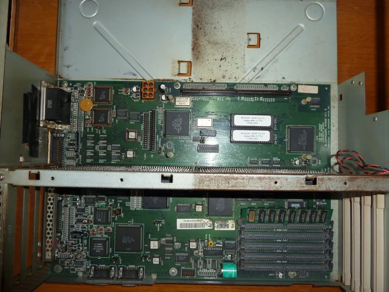

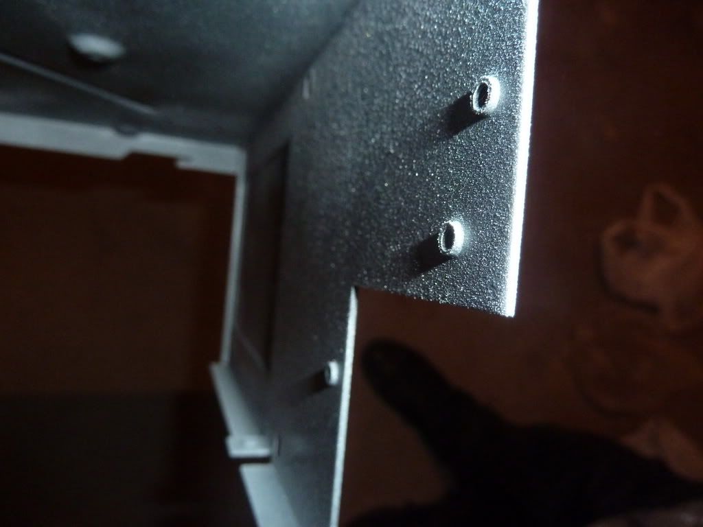

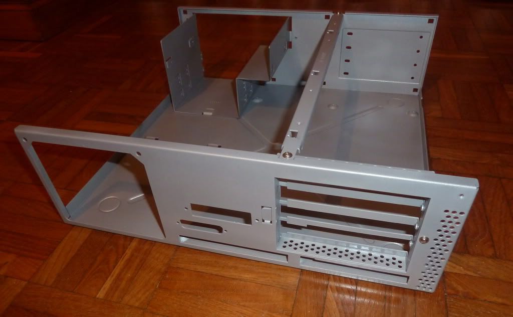

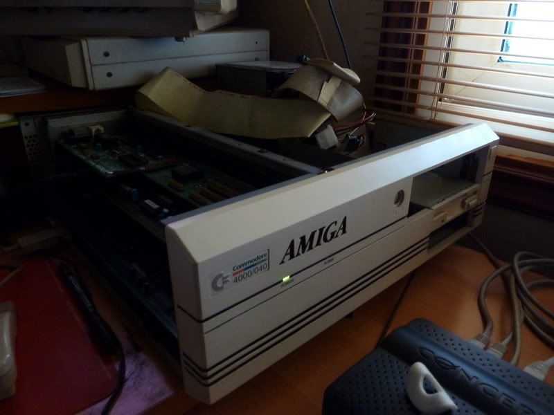

Outside view, well no very yellowed yet but with some ugly black painting done on a moment of stupidity long time ago:
Avobe View:

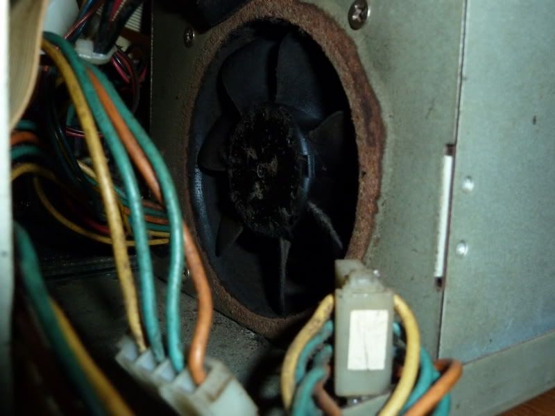

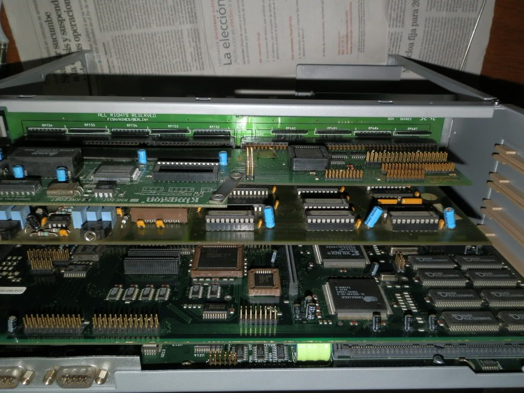

Is this an A4k PSU or a rat's nest? :
Dust, rust and crap from the inside and if you look closer, the remains of the SuperBuster 11 drama (well and a pair of eproms :whistle: hehe):
Well that's all for today, I'll post more interesting hardware pr0n later if you like it.

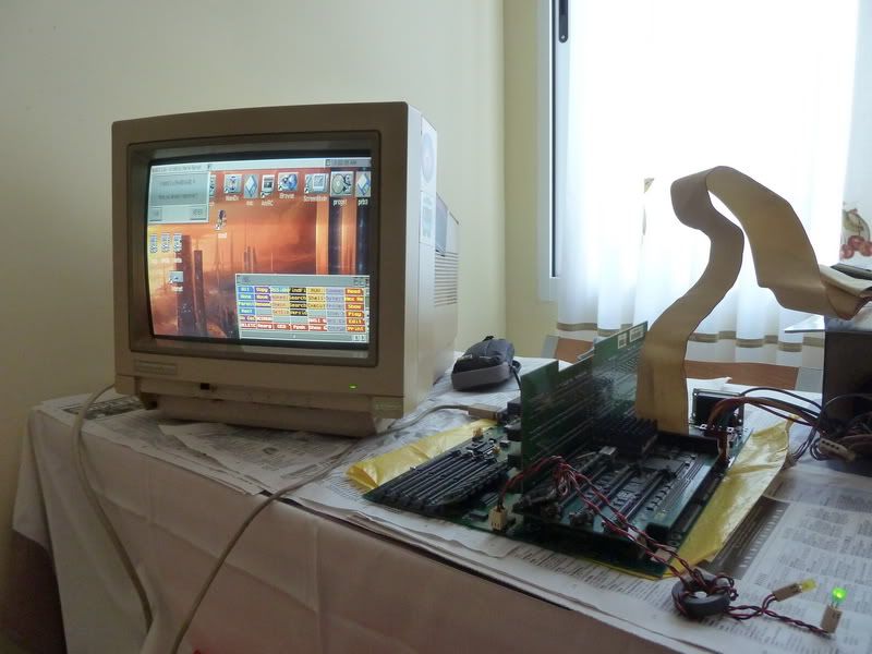

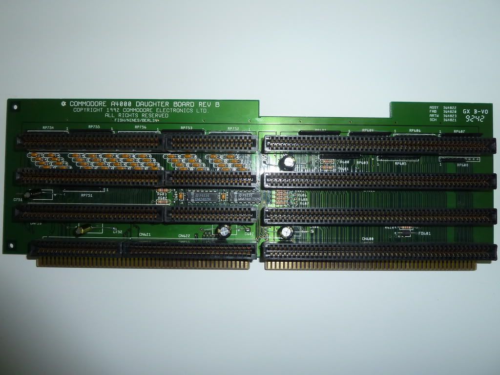

Actually I Fired it up again 2 days ago and runs like new :D , but still have a lot of work to be done, like changing capacitors on the zorro riser board, do the same to the PSU as it sometimes refuses to start and some other things that I have in mind...

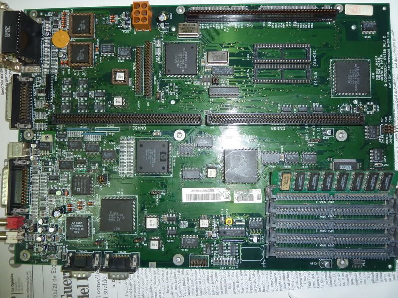

Well there goes an update as promised:
Most of this have already been discussed and shown on a thread that I've opened at the AmiOracle section:
https://www.amibay.com/showthread.php?t=15955
It's About a deep Mobo cleanup, caps replacement an so on...

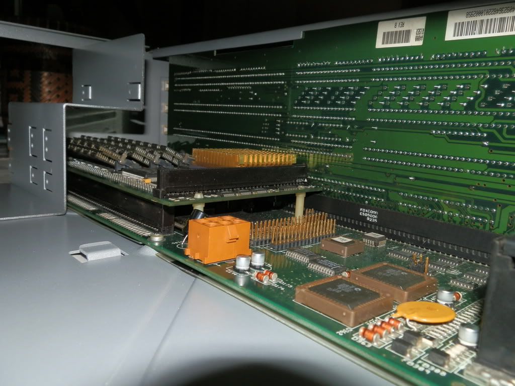

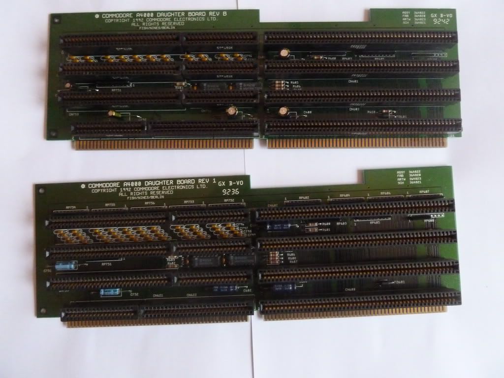

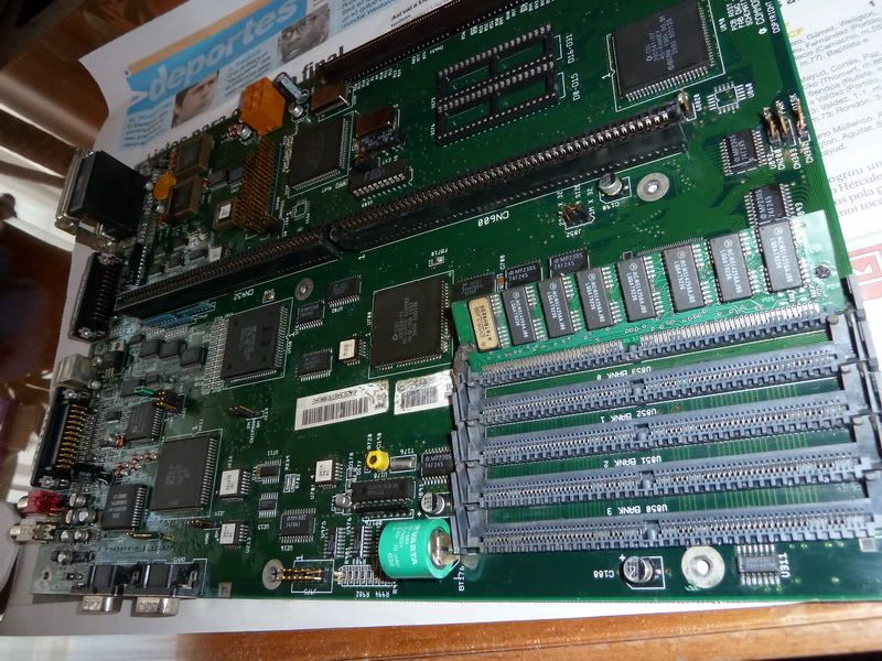

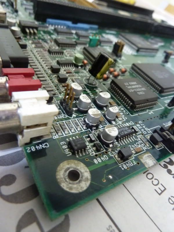

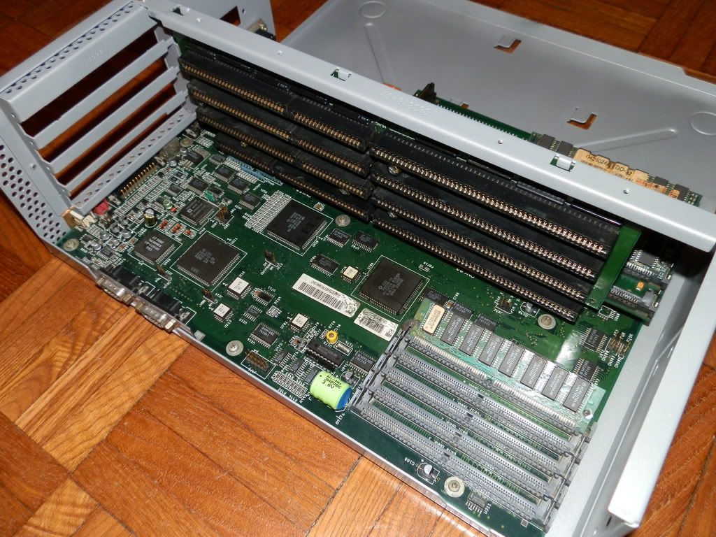

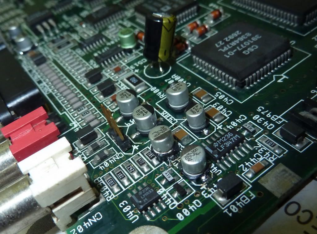

When I disassembled my A4000, one of the first things, and bad news, are that some of the mobo capacitors were in already bad shape and, as would have it no other way , with some nasty capacitor's electrolyte leakage included.
And for the good side of the story, no battery leakage/damage at all, as I was always aware of this matter. So I've replaced it through these years soon after showing up any trace of corrosion. After all, I can be a bit careless, but not enough to neglect this.
Mr. Leakage itself:
The "funny" side of this thing is that, yes, the Audio area seemed the worst of all in all this capacitors scenario, but the audio worked well! , for instance there were no fading at any of the audio channels and so, weird thing.

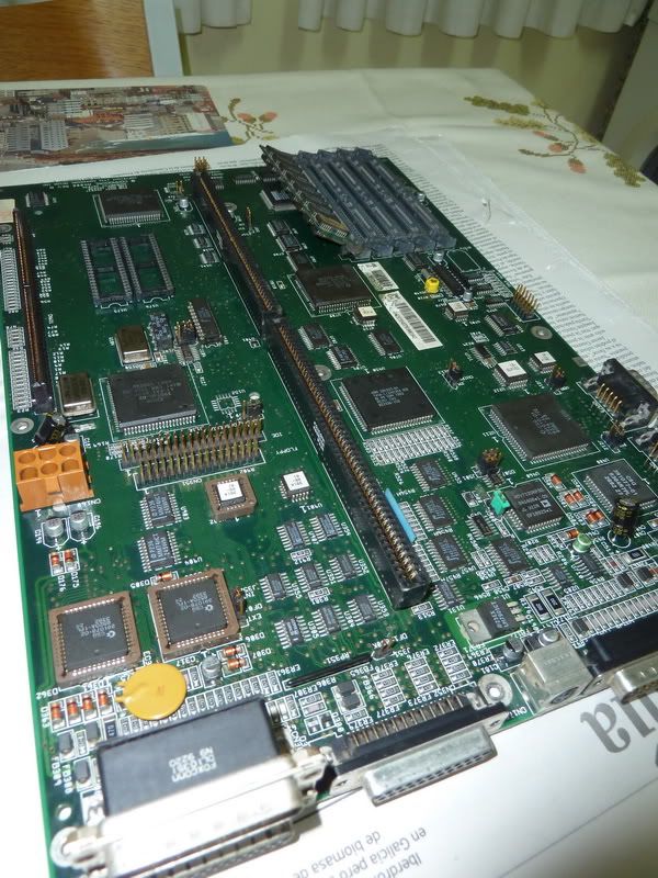

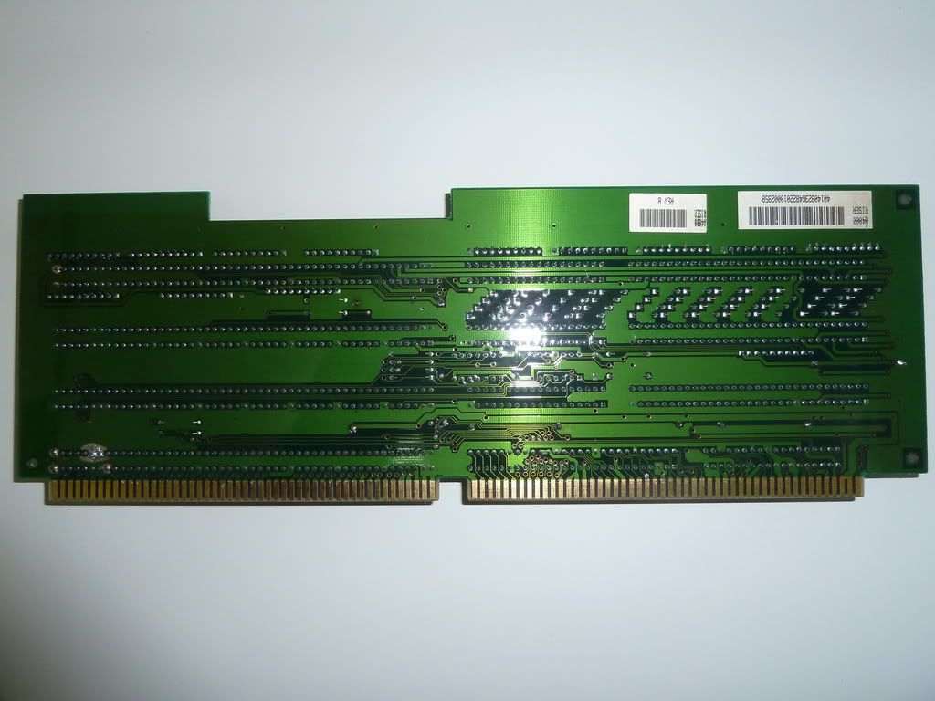

Well, once seen that I've started a general Mobo cleanup including cleaning it with IPA an with the aid of cottons swabs , tooth brush and a soft cloth.
Then I Cleaned it Again with distilled water and again bruishing it
etc... and finally letting it to dry for some days.
Note that I'm an smoker so a big part of dirt was caused by this habit, including some nasty and hard to remove nicotine all around the board (another good reason to convince me myself to kick the habit :unsure:)
After IPA cleanup:
Well I'll admit that I made a big mistake once I started to clean it with distilled water as the 3.6V RTC battery still there, so when I realized this error I just get rid of it urgently. As for, what I know, is not a good idea to mix live 3.6V tracks on the board with water running around, even if It's distilled water. Fortunately nothing got damaged. :)

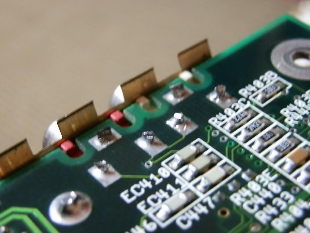

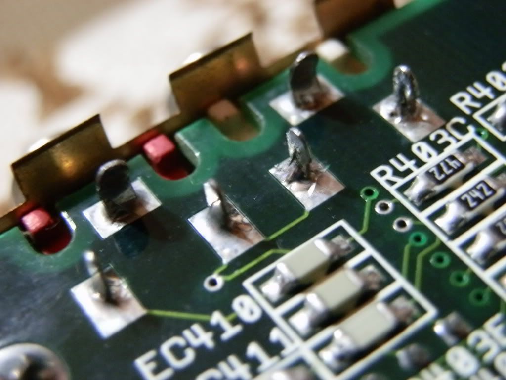

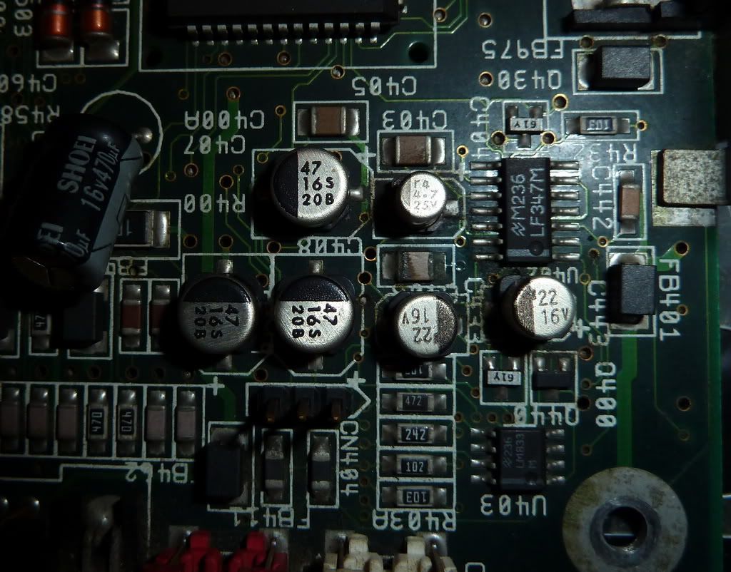

Then after all this cleaning process I managed to replace all the capacitors (besides cleaning it's locations with IPA) on the board with the help of a friend also interested in messing around with hardware and electronics.

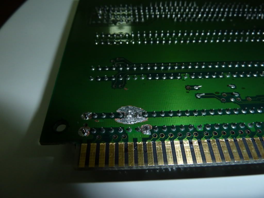

However the corrosion from the leakage around the audio circuitry made at least one of the track's pads became ultra fragile, as it was sitting nearly on air, so it broke. But nothing that a tiny wire to a nearby same track-hole and some soldering can't solve.
A pic of this particular area with all new capacitors:
And Finally two pics more of the overall all-things-done result:
Well after all, I've tested it last week, and works flawlessly. Audio is working ok, and the whole system runs with perfect stabilty after running some demoscene prods to put all the custom chips at effort for near two hours...
And Perfect! :D
Hope that you like it, I'll post more progress later if you want.

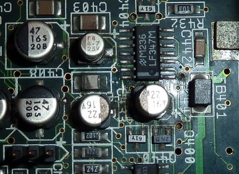

Hi,
I am not sure but I think I found a little mistake near audio circuit. I have currently no mobo for checking but maybe I am wrong.
Better you have a look :)
Best regards
FD

@Fieldday
Thanks for the hint but all seems correct. :)
To avoid this kind of issues, I've taken some close hi res photos of the board after the caps replacement, just to be sure, and I've triple checked them before testing the mobo up and all caps seem in correct position and orientation.
Perhaps, which can confuse anyone, is the fact that the way to print their values ​​varies from the 47uF ones to the 22uF others, as they seem from different brands.

Here goes some Before-After Higher Res. pics:
After:
Bye!
Hi,
great work, your PCB looks like new (y)
Could you do a better pic from the area of C433? I am not sure but I think there is something between pad and via.
Benchmarks are always welcome :)
Best regards
FD
@Fieldday
That track got broken in the replacement :Doh: , so what you see there it's that track fixed by a tiny wire and soldering, as this track goes to that via, perhaps don't look a very pro fix but it works, continuty checked and is ok :)
This pad was barely sitting on air, maybe due to electorlyte corrosion to the pcb composite, when we desoldered this capacitor the track got bent.

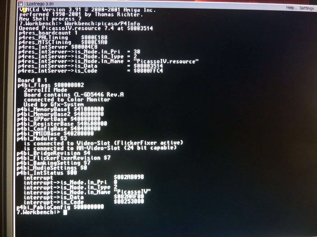

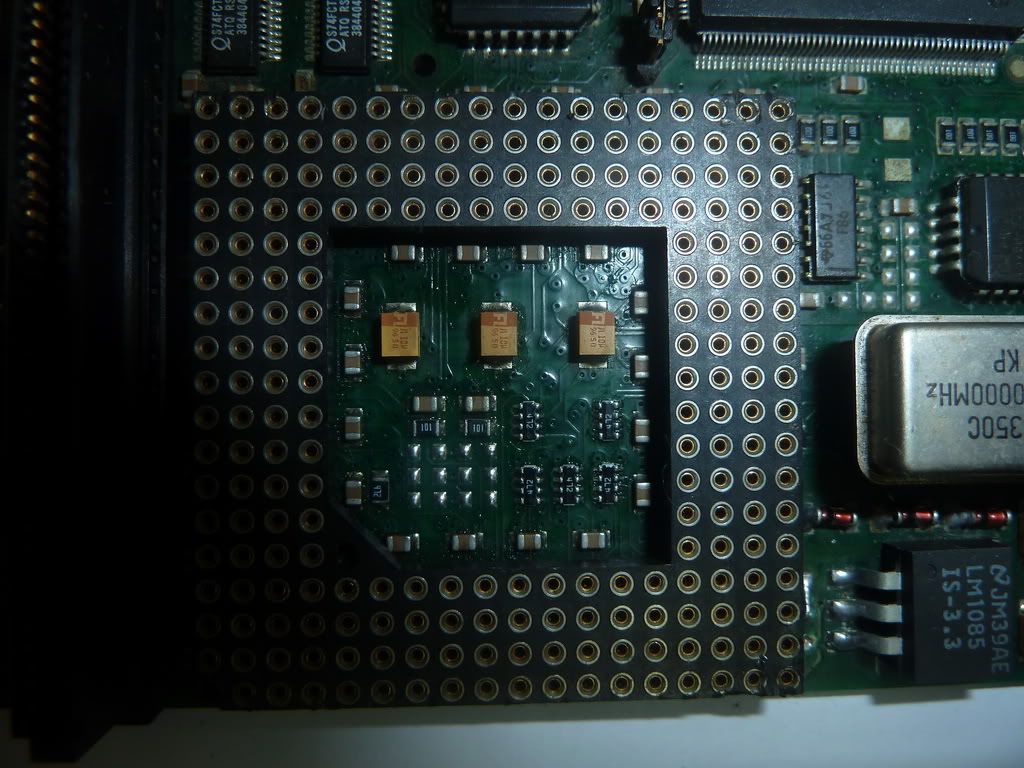

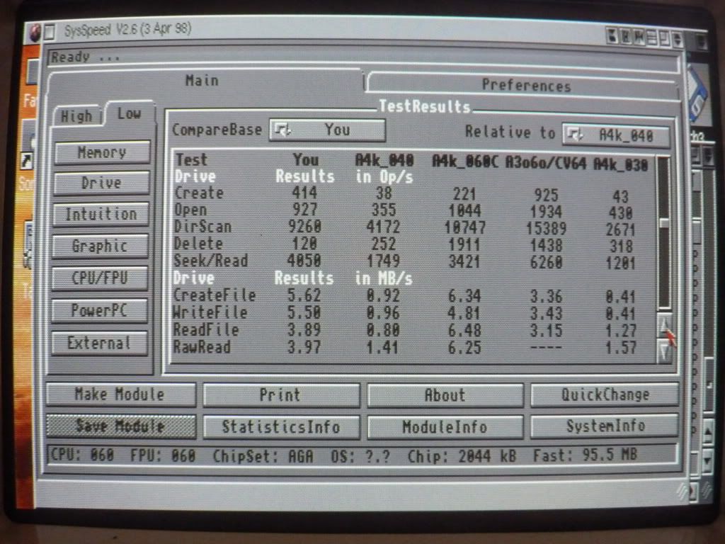

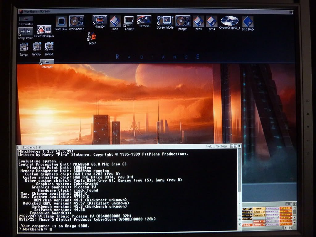

I just managed to do two quick Benchmarks today:
Sorry for the bad quality but I haven't enough time to mess with 1084S and camera settings.
Done with the so hacked onboard IDE and a seagate 120GB hard disk, under Amiga Os3.9, with Idefix software patch and on a SFS partition.
Sysinfo:
SysSpeed:
Bye!
