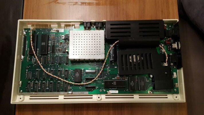

This one. It’s long board yes ?
yep,its a long board.the part your looking for is under the cia on the far left
Great, I already bought x2 7406 (they were €1.07 each) from electronics shop 2 mins walk from work.
I hope it will solve the issue.
let us know how you get on,i have one or two other ideas if it dont clear it
There are also the ESD protection diodes on the left hand side next to the 7406 factory soldered to the ground. They can also break.
