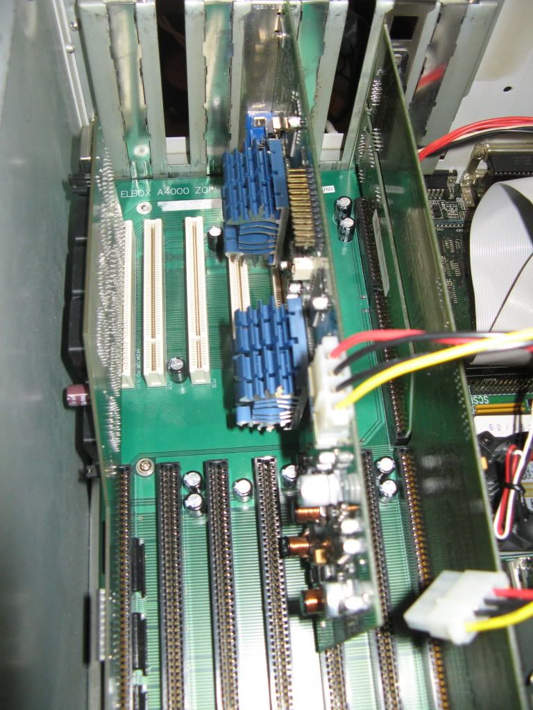

I finally got the time to modify my Mediator 4000Di MK-II to allow it to use my 3.3V Radeon 256MB (added a +3.3V line to "PCI2" only)
Had a bit of trouble getting it to work... "Radeon" crached when doubleclicking on it in Devs:Monitors/
But with a lot of testing and using merlinkv's archive with the needed files i finally got it working and Workbench is now on 1280x1024 through DVI on my Radeon :cool:
I've attached the MedReport file so you can compare all libs/variables.
And the Radeon is in "PCI2" (second from bottom) which is the recommended slot (at least for OS4.x Classic)

I've updated my Tower conversion thread with a few pics of it...
http://www.amibay.com/showthread.php?t=14561
It isn't very exciting to look at as it's only a cable soldered to the Mediator. But the result is very exciting :D
---------- Post added at 20:59 ---------- Previous post was at 20:56 ----------
The main thing that stopped "Radeon" from craching with "8000004" was to change the WINSIZE to CLOSED (512MB), but you've already tested that with no luck?
And the final touch was a mix och merlinkv's files and trial and error :roll:

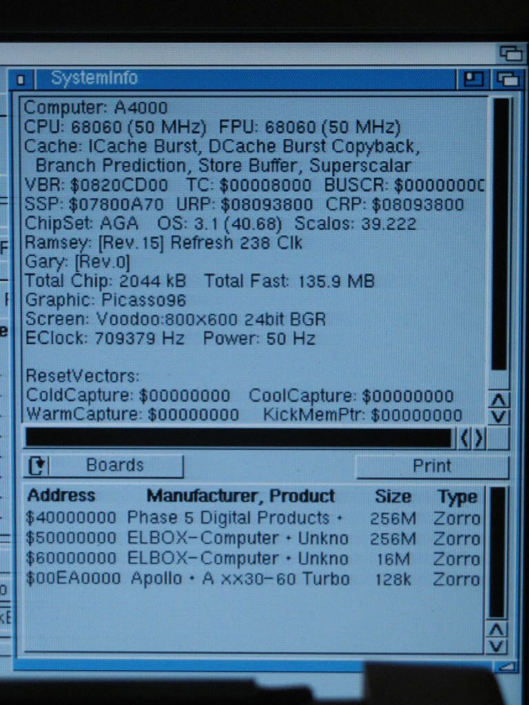

Hi!
I tested Bebek's riser card in my setup today with Voodoo 5 (I don't have any Radeon to try) but its working with the Voodoo:
http://i294.photobucket.com/albums/m...e/IMG_1191.jpg
http://i294.photobucket.com/albums/m...e/IMG_1190.jpg
@Bebek - more on PM my friend :thumbsup:
