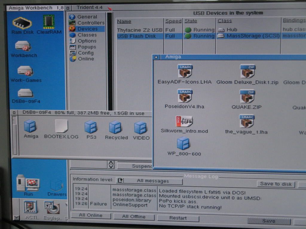

@Thread, (as I'm sure ya'll know) Poseidon 3.8 needs a registration key so I tried V4.4 from http://www.platon42.de/poseidon.html and its working fine with my setup, so I guess no need to use 3.8 unless you have an Elbox Spider :coffee:
Here ya go:
http://i294.photobucket.com/albums/m...e/IMG_1445.jpg
All working with 4.4 :thumbsup:
It *may* be that I had it working under 3.8 and then installed 4.4 over it that it continues to work, but all I can is its full working and I don't need to 'inject' a key :ninja:
Steve.
