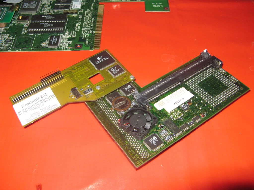

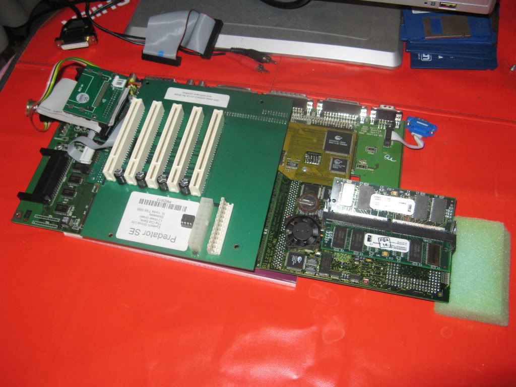

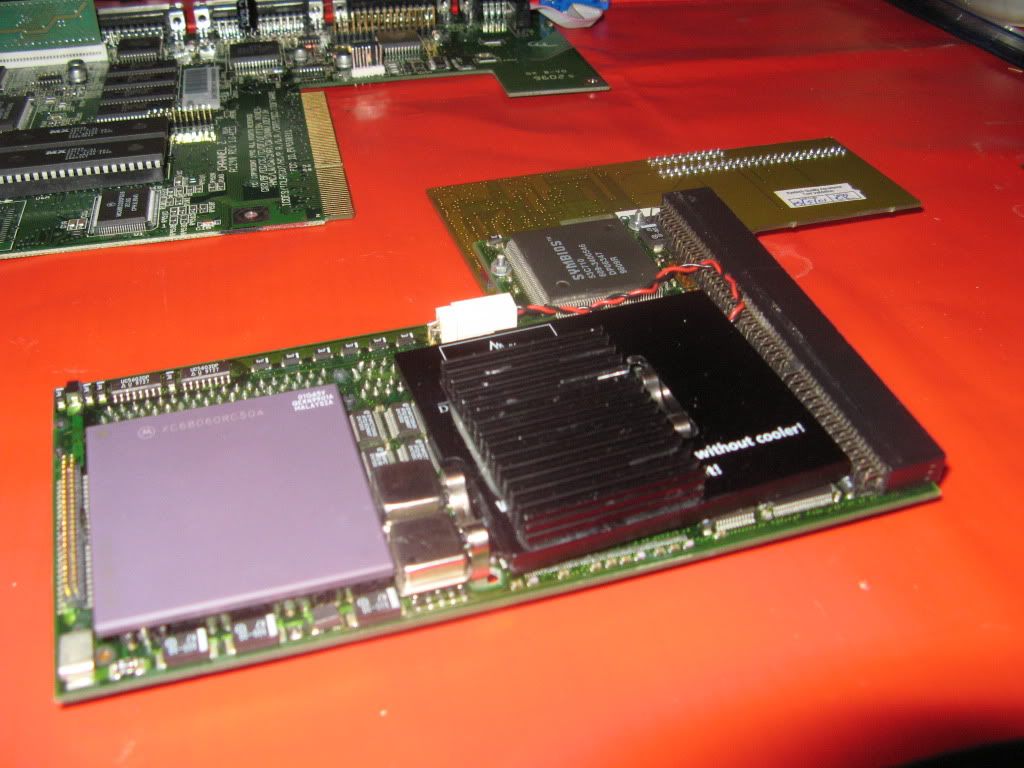

I bought/traded this from CosmiscFrog a week or so ago and finally round to setting it up for the first time.
Its a re-badged G-Rex PCI 1200:
http://i294.photobucket.com/albums/m...e/IMG_1517.jpg

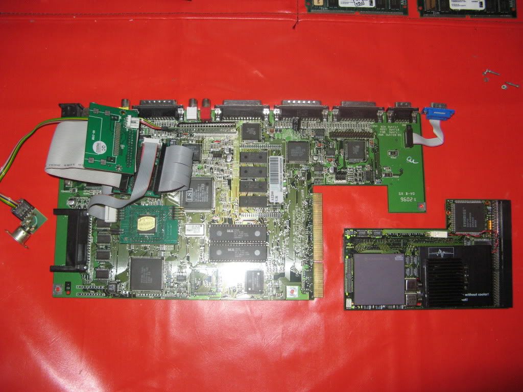

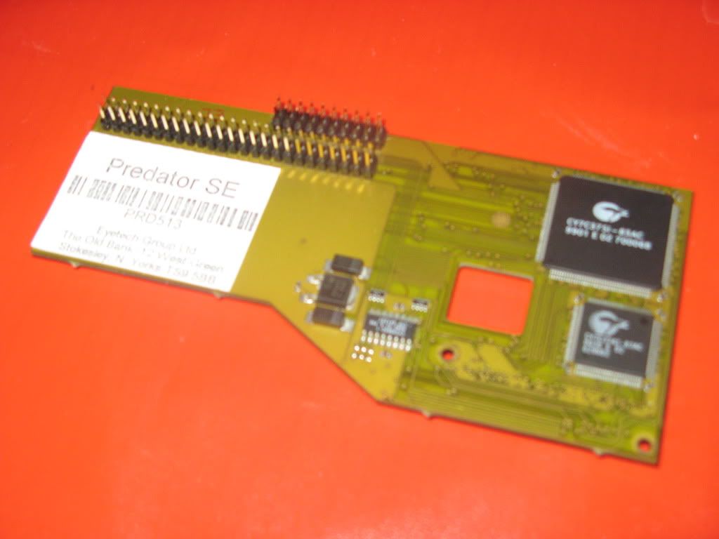

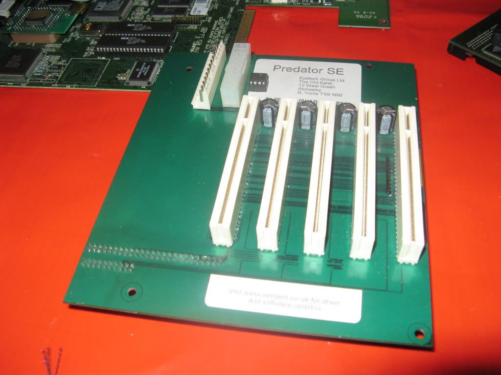

And the logic board which connects directly to the PCI slot on the BPPC:
http://i294.photobucket.com/albums/m...e/IMG_1514.jpg
As you can see here:
http://i294.photobucket.com/albums/m...e/IMG_1515.jpg
And here: :D
http://i294.photobucket.com/albums/m...e/IMG_1516.jpg

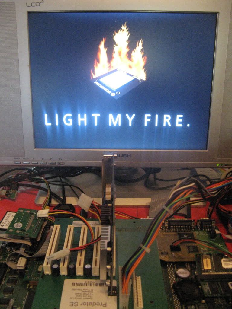

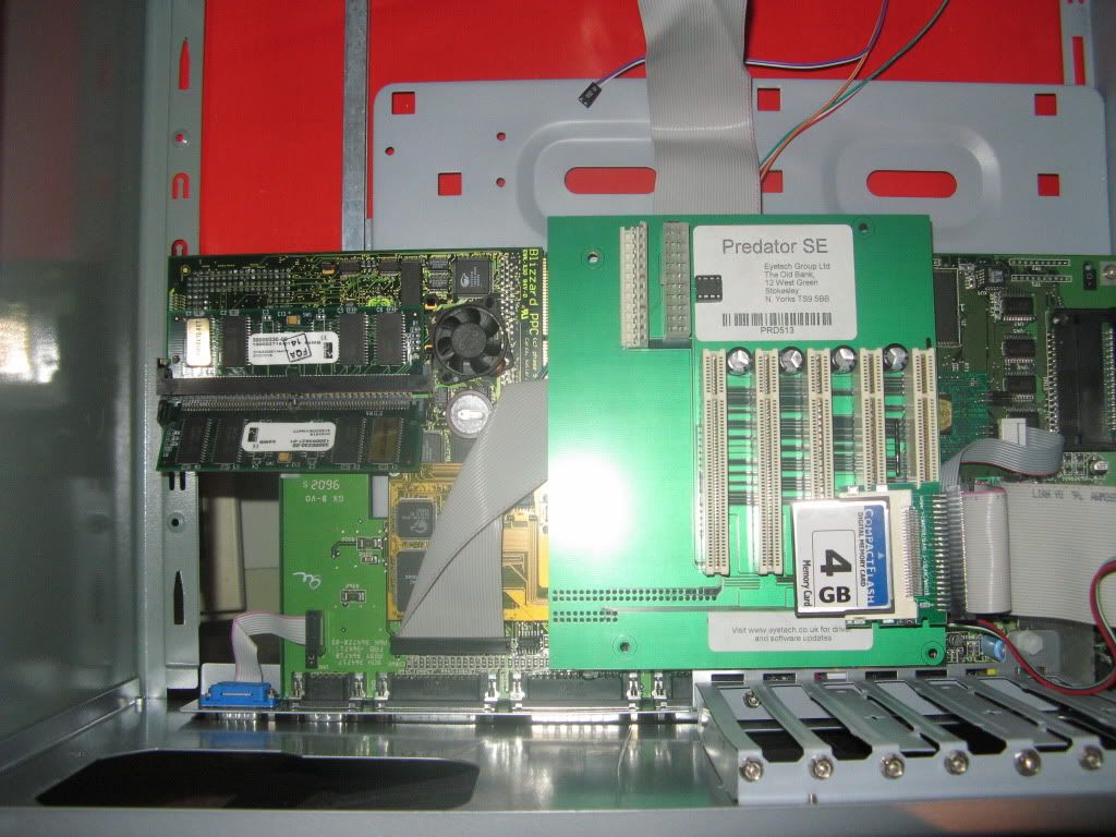

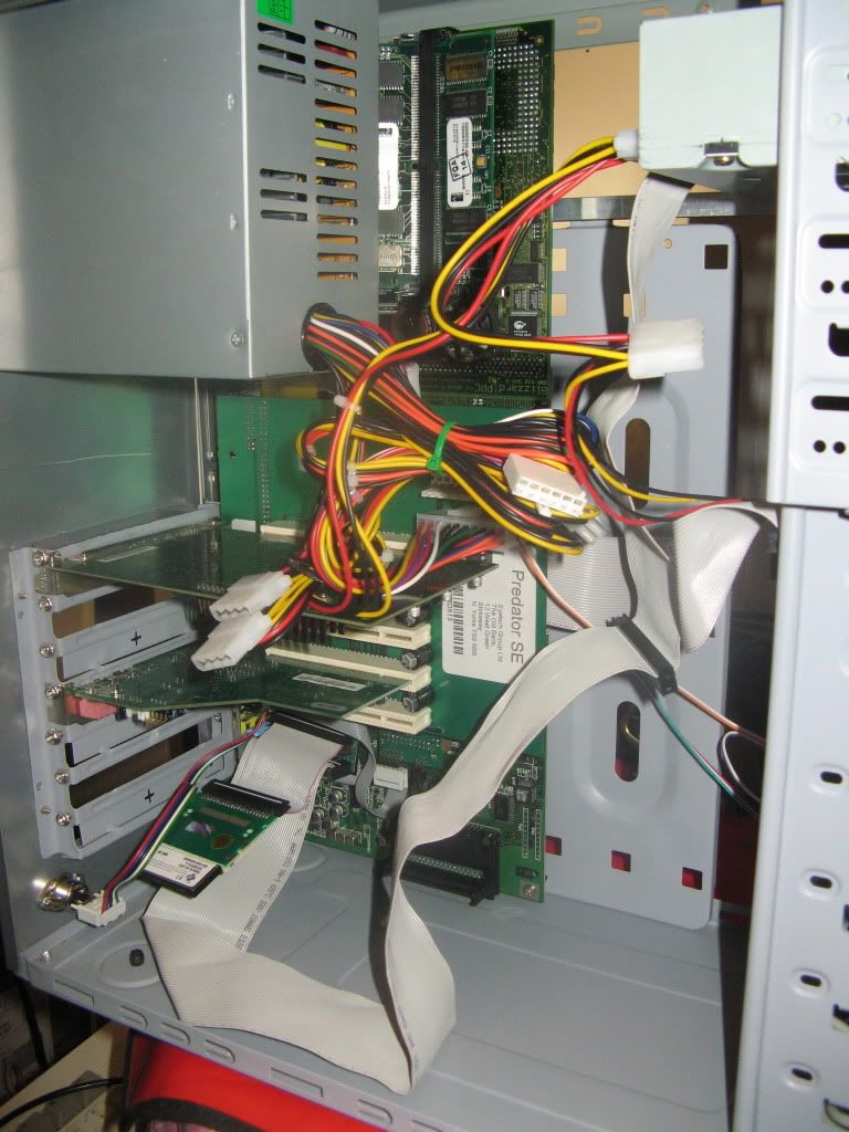

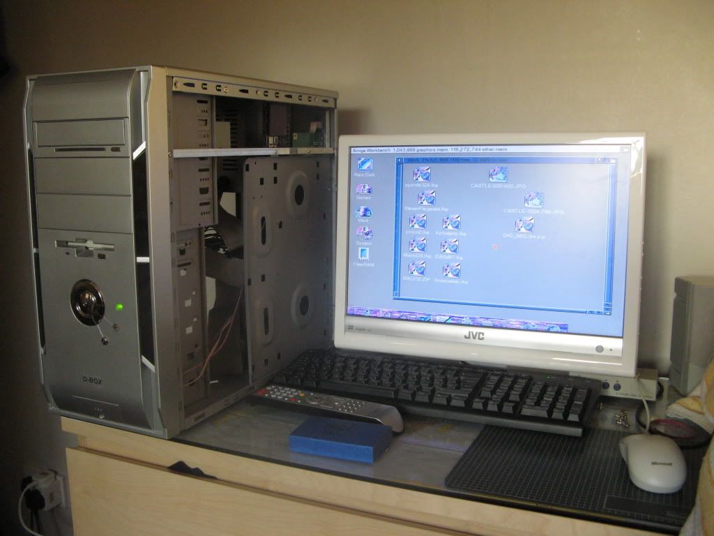

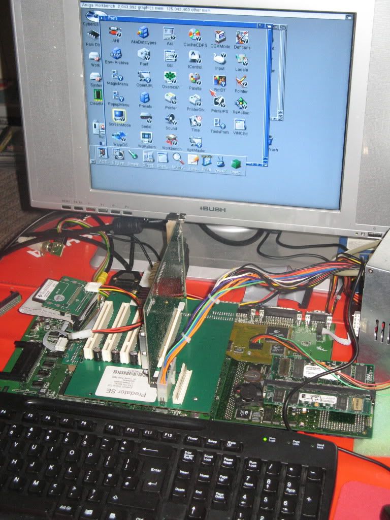

As usual I'm working outside the case on my Anti-Static mat hooked up to a TV by RGB Scart and VGA with a PeeCee Keyboard running of Elbox PCKey1200, here's a shot with the Busboard in place:
http://i294.photobucket.com/albums/m...e/IMG_1518.jpg

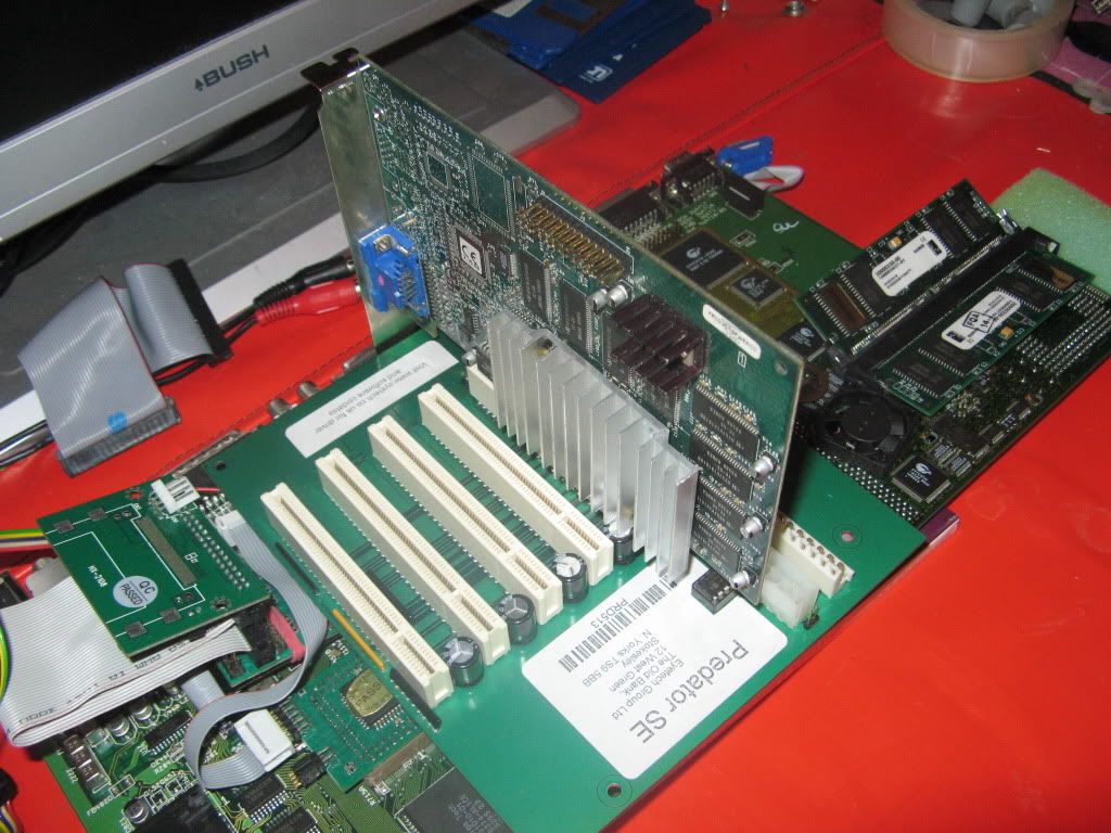

And with my trusty Voodoo 3:
http://i294.photobucket.com/albums/m...e/IMG_1519.jpg
It didn't boot first time, in fact it rarely boots from cold (not sure if this is normal) but after a reset it starts booting up, once you have the drivers installed you get this cool boot pic :thumbsup:
http://i294.photobucket.com/albums/m...e/IMG_1524.jpg
(The image on screen was clear, thats just the camera playing silly buggers)

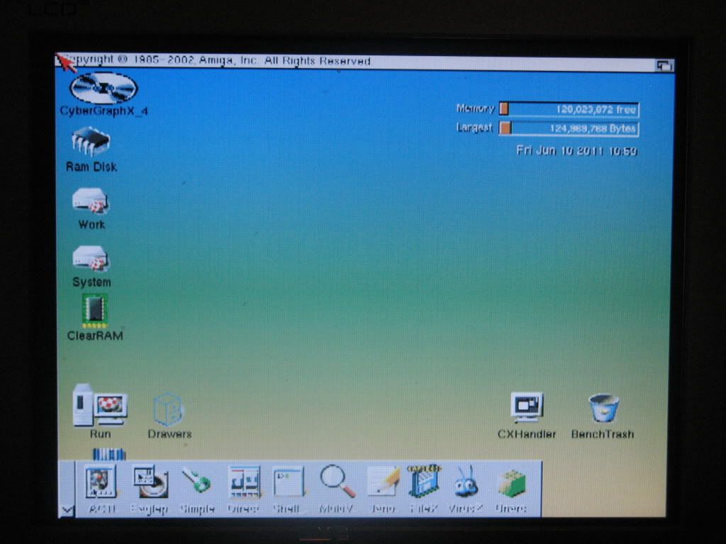

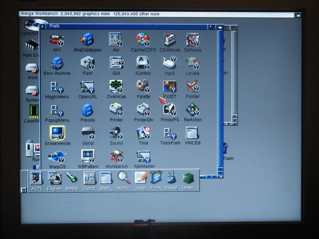

Here we are with good ol' CWB OS3.9:
http://i294.photobucket.com/albums/m...e/IMG_1527.jpg
Sadly the nightmare begins here, I tried three different workbench installations, OS3.9/CWB OS3.9 and WB3.1 but I get the same issue.
I can view the test screens and can select a screenmode but as soon as I click anything it crashes :(
I spent the whole day on this and didn't make any further progress. I'm using the correct libs (modified 060 libs for G-Rex) and I'm using CGX4 plus the updater/G-Rex installer.

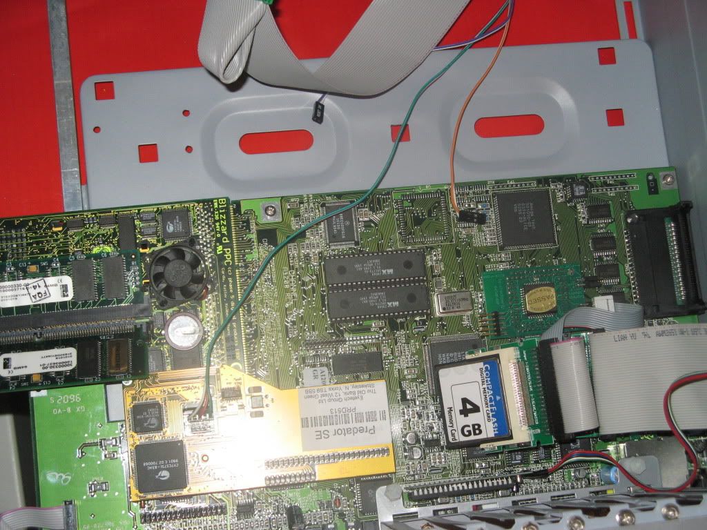

I disabled all the extra's in CWB in case it was that, but as I say it done the same with OS3.1, I may have damaged the logic board during install as I made slight contact with the PCB whilst fitting the screws, and there is a slight mark accross a track - I need to check it with a multimeter and see if I have done any damage.

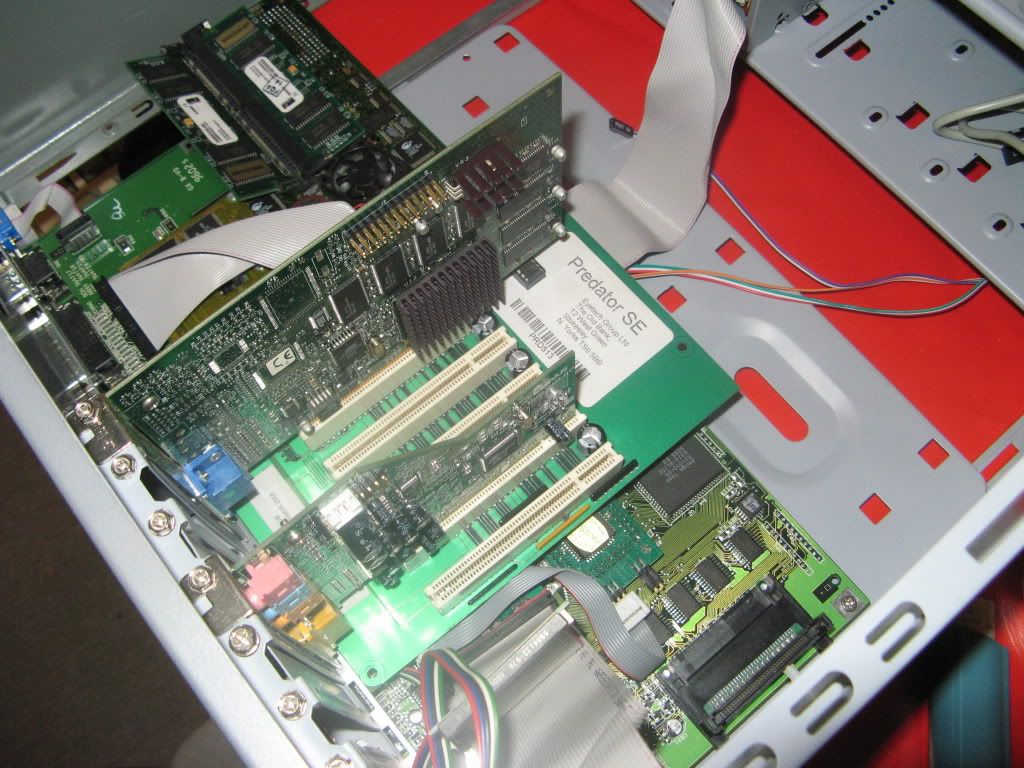

Anyway - I'll leave you with a few more pics :thumbsup:
http://i294.photobucket.com/albums/m...e/IMG_1532.jpg
http://i294.photobucket.com/albums/m...e/IMG_1530.jpg
http://i294.photobucket.com/albums/m...e/IMG_1511.jpg
http://i294.photobucket.com/albums/m...e/IMG_1513.jpg
Thanks for looking! Hopefully I can update some time in the future if I can get it going :whistle:
