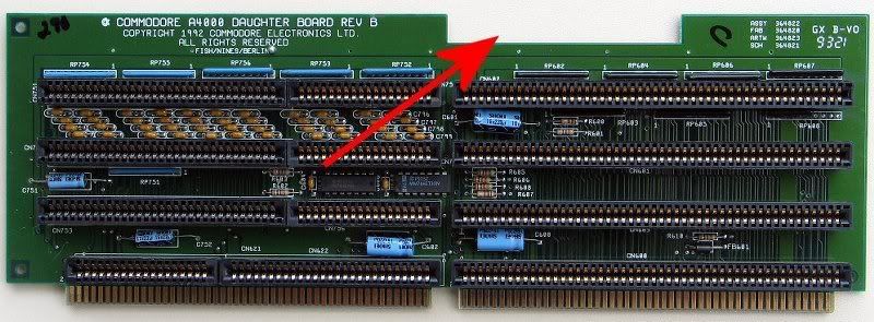

PS. you can avoid passing the IDE cables _above_ the busboard metal holder by using the special cut the busboard has for that reason (so the cables go between the holder and the busboard)
http://i125.photobucket.com/albums/p...ughterrevb.jpg
also may ask why you use a Buddha? for the clockport? dead onboard IDE port? I have one and it offers no speed increase... don't get me wrong, I am just curious :)

yes too bad about the buddha+idefix lock down... one other drawback is that if you do not have something connected to the onboard IDE (be it a drive or an IDEkiller) you just have to wait ~30secs extra to boot :evil:
PS. also another hint, behind the RCA audio outputs there is a header where you can connect the cdrom audio output (I did not knew it too, I saw it on one of the german A4000's I got over the years :mrgreen: )

@keropi
Well I'll be damned, I never noticed the slot in the daughterboard for the cables either :lol:
CD Connector at back is very useful, now that I did know :lol:

:mad:Did do the mod, it ads yellow and almost unreadible yellow screen for workbench,, can not believe that we missed a pin cound, the only possible explanation to me is that we misinterpreted the instructions.
Might have the instructions wrong - will post a pic for approval if done correctly :bowdown:
---------- Post added at 00:39 ---------- Previous post was at 00:28 ----------
Sorry to say, but we did after doing this mod had a couple of drinks :D
Probably I did made a good contact over Lisa, since the ristor soldered was a little in the way ;)
I refitted the card, and did a copy in workbench, (almost certain to produce some strange artifacts)
opened a lot of windows, but was not able to reproduce the strange artifacts problem. (if it stays like this) i will update this post anyway.
So well, only tested for 5 minutes (knowing wat to do to have the strange problems) it looks like a fix:thumbsup:

resistor fix
A couple of day's ago, I had problems with the colors, once more, refitted it once more, and yes, it works!
Strange that know there seems to be a bad contact problem.
Well the highfx mode is clearly fixed, no disturbance anymore, no complaints, exept the refitting is annoying.
Bought a mediator 4000 di, so.. that completely blox it of, so removing the daughter card is annoying.
I do not believe in heating issues, heat?? I don't feel a thing even after an hour.

What happend with my indivision aga? Well after the upgrade with 68060 and mediator pci, it needed extra airflow, since that extra airflow and the resistor fix no complaints.
---------- Post added at 12:57 ---------- Previous post was at 12:55 ----------
And yes Jens also comfirmed that mediator 4000di busboard generates heat.
I did not ask for a solution, since solved.
A little blob of silicone glue (the neutral type! Don't use the common one as it have acetic acid which can attack metal in the vicinity) between the Lisa chip and the Indy can make wonders, you know? ;)
