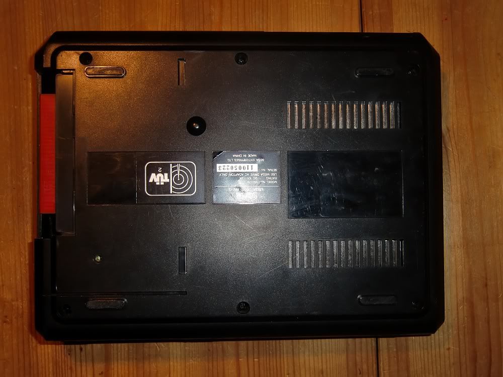

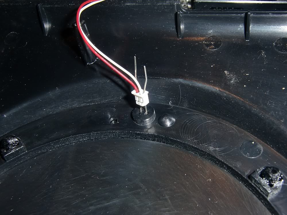

There are only 6 screws to be removed on the base and once these are out , you have to disconnect the LED in order to get the top off.
For this, straighten the legs and slide the connector down and clear. It may be a bit stiff, but it will come off...

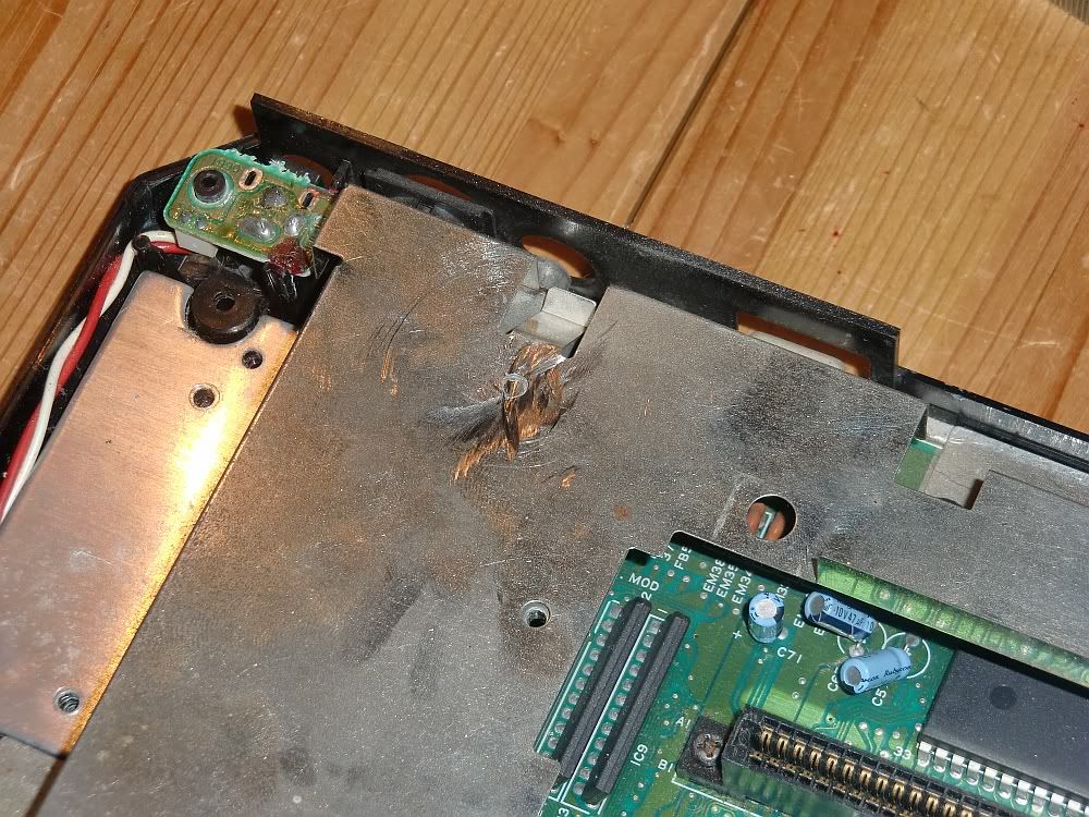

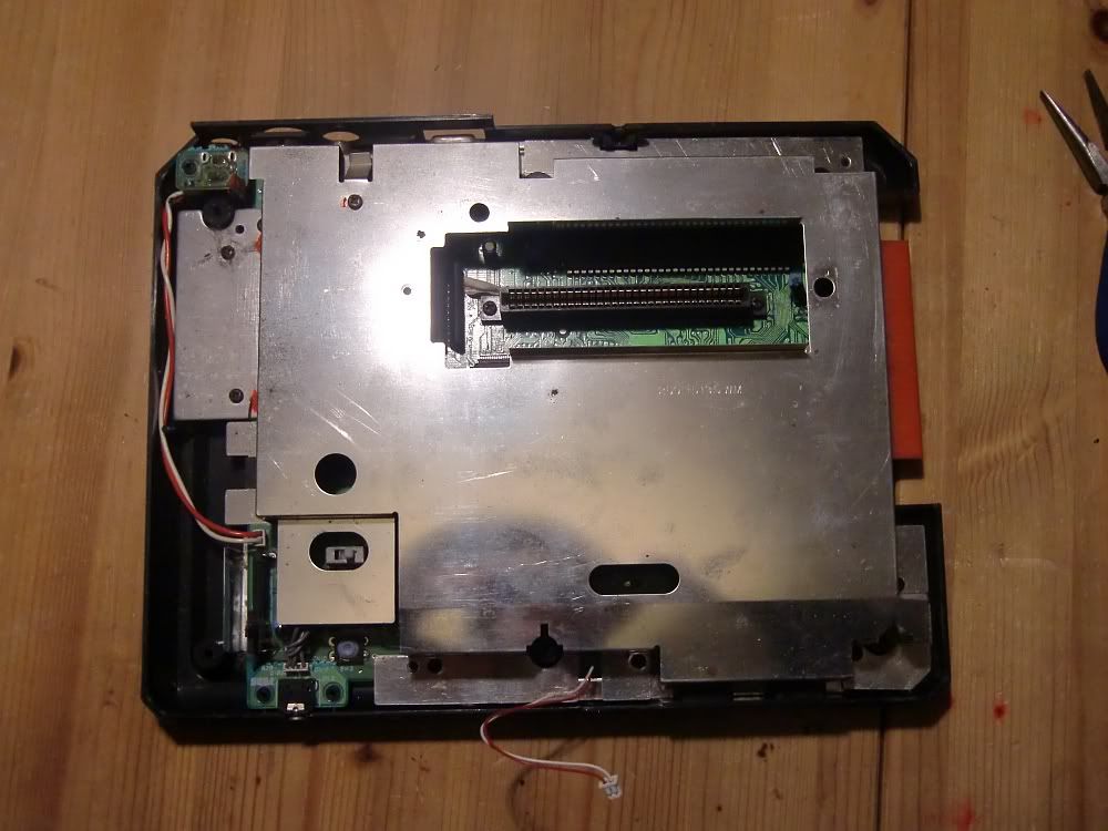

The RF shielding is next and was a bit of a problem to remove. There is one screw that is used to secure the shielding to the Regulators heatsink. Unfortunately it seems they drilled a hole, but didn't put in a thread. The screw was in so tight I had to eventually cut off the head using a rotary tool in order to get the shielding off at all.
http://i94.photobucket.com/albums/l1...verclock05.jpg
http://i94.photobucket.com/albums/l1...verclock06.jpg

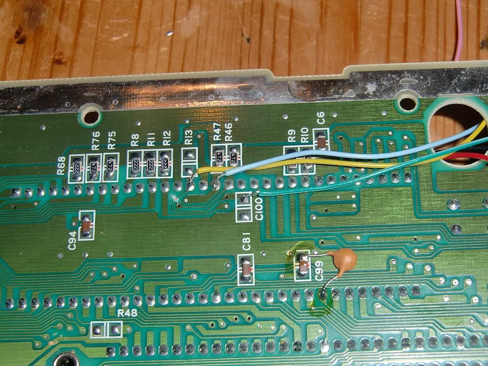

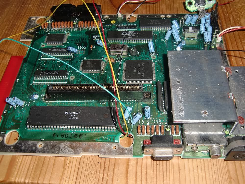

Once the motherboard was out, flip it over and find the CPU from underneath. You need Pin 15 and Pin 17. Pin 15 is for the clock speed and pin 17 is for the halt signal.
http://i94.photobucket.com/albums/l1...erclock07a.jpg
Cut the trace from Pin 15, this allows you to then add your own clock speed with a little soldering.
http://i94.photobucket.com/albums/l1...verclock08.jpg
Next was soldering some wires to the various points. Yellow wire to Pin 15, the Processor clock speed pin, The Green wire to the original 7 Mhz clock and the pale blue wire to Pin 17, the CPU Halt signal.

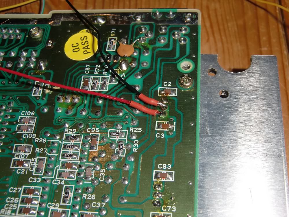

While the board was over, I took the opportunity to run a +5v and GND wire from the underneath of one of the regulators.
http://i94.photobucket.com/albums/l1...verclock10.jpg

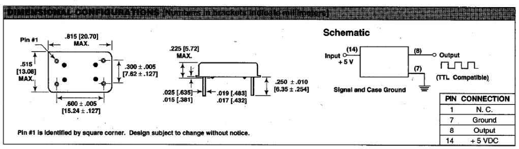

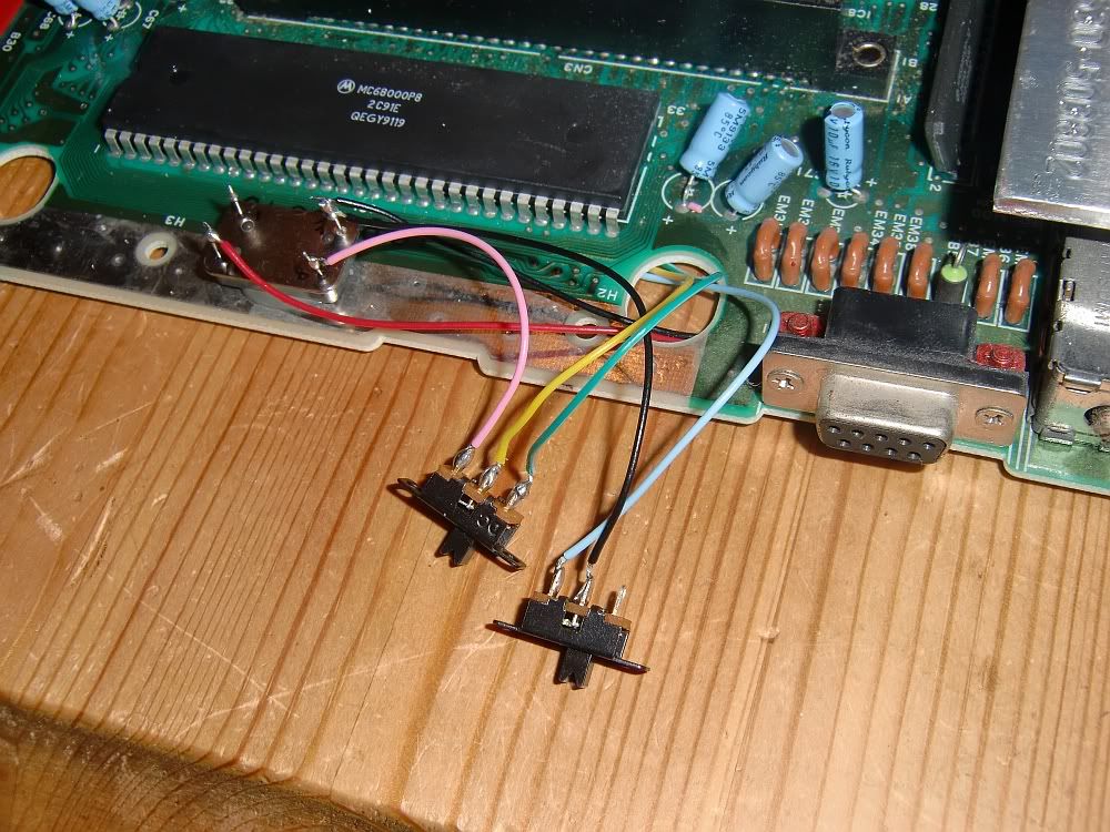

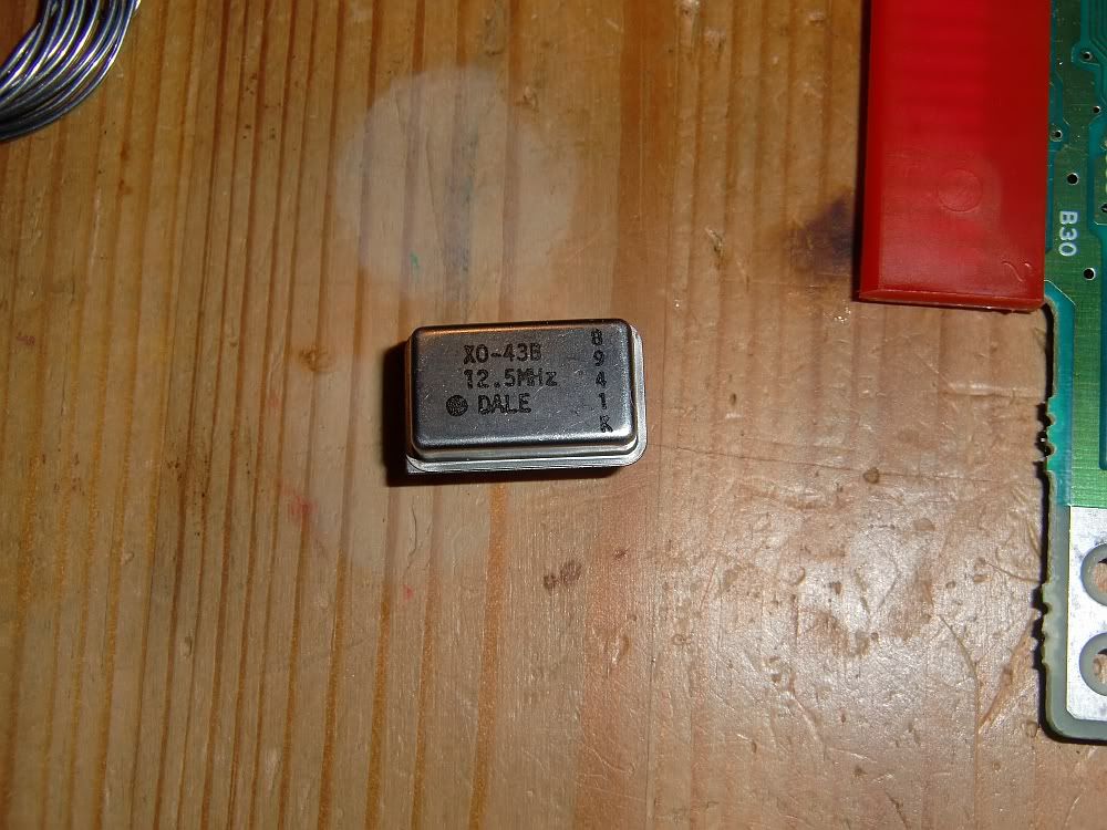

I then took my 12.5Mhz oscillator that will be used to create the overclock speed. It is a Dale XO-43B. I downloaded the datasheet HERE, but the part you need to identify what pin does what is below. Be careful to get these right, you don't want to send 5v in the wrong way. I marked mine up for when I came to solder it up. I hot glued the oscillator in place adjacent to the CPU. I was conscious of keeping the wires as short as possible so as not to introduce any problems.
http://i94.photobucket.com/albums/l1...verclock12.jpg
http://i94.photobucket.com/albums/l1...verclock13.jpg
http://i94.photobucket.com/albums/l1...verclock14.jpg

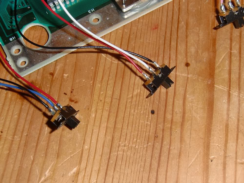

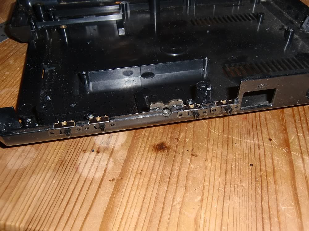

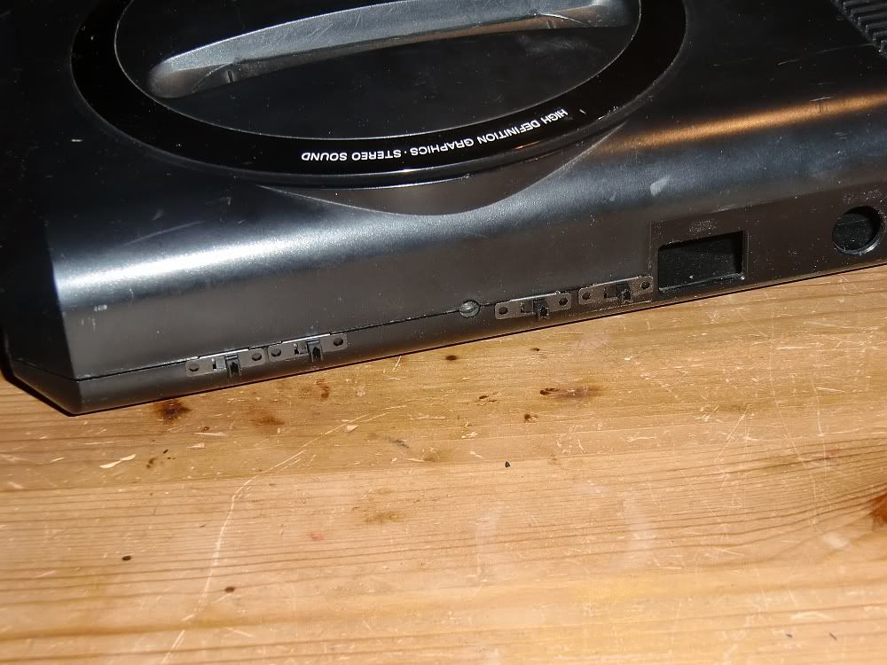

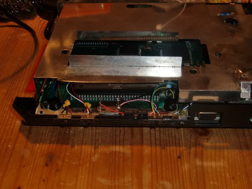

Then it was a simple case of soldering all the wires to the switches. I am positioning these so that having the switches all to the left leaves the MD in standard British PAL configuration.
Pink is the 12.5Mhz clock, yellow connects to pin 15 (CPU Clock), Green to 7Mhz (native clock)
Pale blue is the CPU Halt (pin 17) and Black is GND. The third position is unconnected, when pin 17 is grounded the CPU is halted, allowing you to switch clock speed. Make note, you will still hear music playing while the system is halted. That is perfectly Ok.
http://i94.photobucket.com/albums/l1...verclock15.jpg

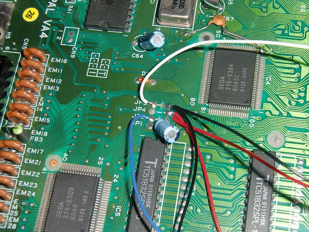

Next it was the 60 Mhz and Language Mods. Find JP2 and 3 and cut the tracks inbetween them.
JP3 (White) is the 50/60Mhz jumper.
JP2 (Blue) is the language jumper.
I also connected 2 wires to the +5v (Red) and GND (Black)
http://i94.photobucket.com/albums/l1...verclock16.jpg
I then connected them all up to the SPDT switches. When Blue is on Red (+5v) you have English, When White is on Black (GND) you have 50Mhz.
Again, I will orientate the switches so that when they are to the left they will be in standard configuration.

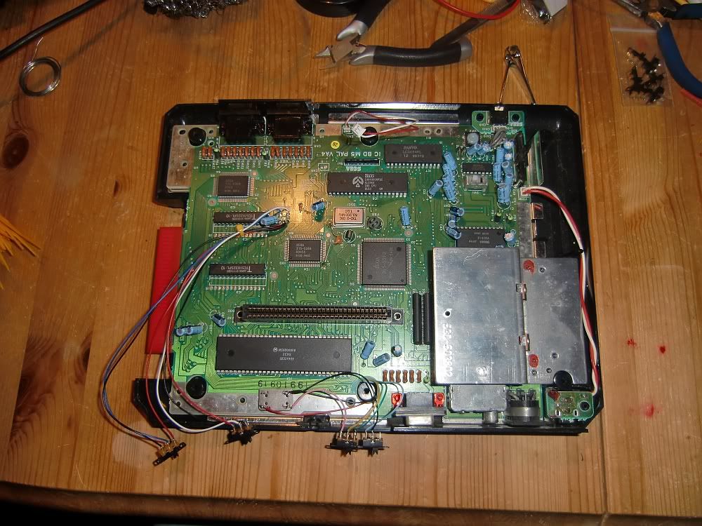

A quick overview of the project so far.
http://i94.photobucket.com/albums/l1...verclock18.jpg
I then hooked her up to the TV and ran her through her paces and all seems fine. I was interested to see how she responds overclocked, but I have to say I didn't notice a huge difference. But when I get her back together again I shall give her a good old test out with my son in both speeds and video whatever difference comes up.

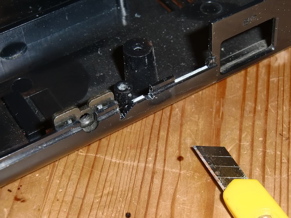

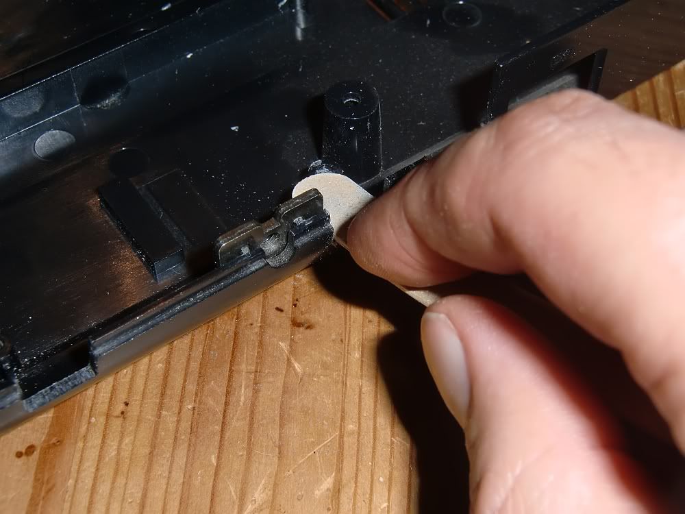

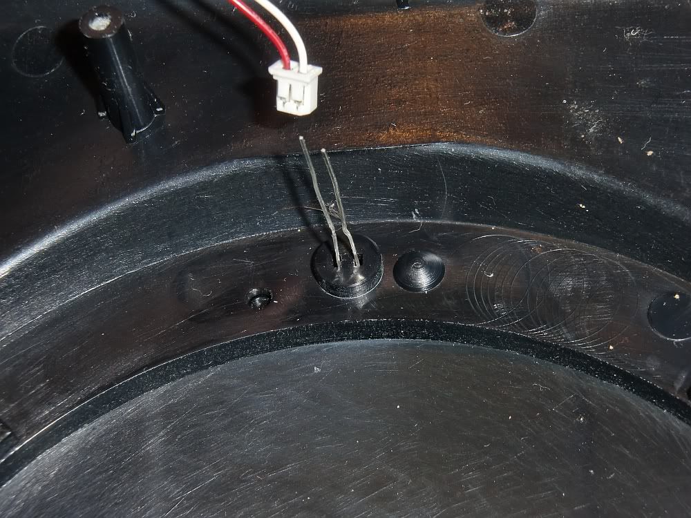

Just had time to start modding the case before bed.
http://i94.photobucket.com/albums/l1...verclock19.jpg
http://i94.photobucket.com/albums/l1...verclock20.jpg
http://i94.photobucket.com/albums/l1...verclock21.jpg
http://i94.photobucket.com/albums/l1...verclock22.jpg
The case has been washed and is now drying out in my airing cupboard. Hopefully I'll get this finished off tomorrow.

With the casing washed and dried, it was time to put it all back together.
I tidied up some of the wires, and secured the switches with a dab of superglue. Usually I would use hot glue, but in order to access the motherboard again in the future, superglue is a lot easier to remove and replace. The switches are quiet secure and firmly placed, so have no chance of coming loose unless you really pummel them. I had to trim some of the RF Shielding at the rear to be able to refit it. I know it's not strictly necessary, but why not if I am able?
