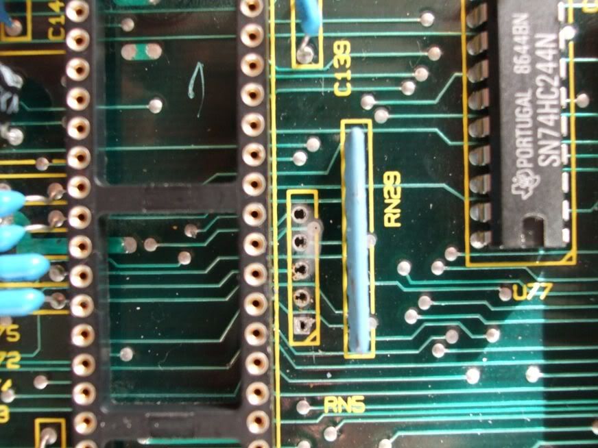

The 2000 will give a black screen if..
CPU not present / contacting
Agnus not present / contacting
Among other faults - power etc
Mine had a green and yellow too because of the damaged CPU & agnus sockets .
Try a pinout buzz ( continuity test ) with a multimeter if possible
