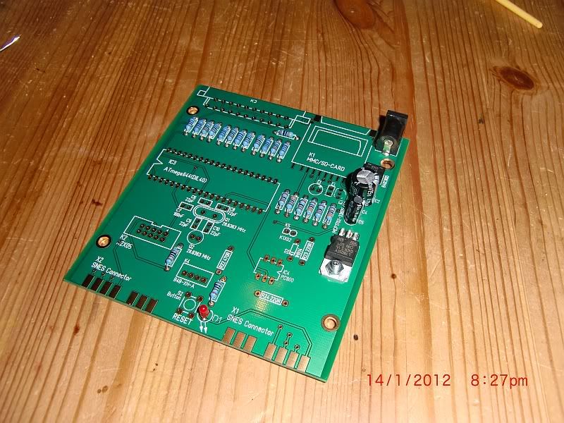

Opening the pack gives a couple of detailed spec sheets, one PCB and 3 bags if components.
http://i94.photobucket.com/albums/l1.../Euzebox01.jpg
There are a lot of nice easy through hole parts to solder in, and the board is really well spaced out and easy to work on.
http://i94.photobucket.com/albums/l1.../Euzebox02.jpg

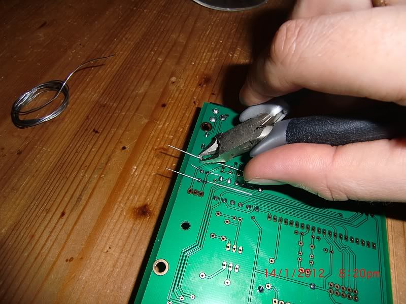

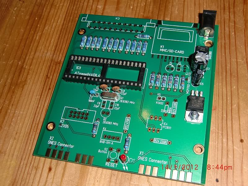

I built it in stages, first all the resistors and Power supply..
http://i94.photobucket.com/albums/l1.../Euzebox03.jpg
Next was the IC socket, caps and oscillator...
http://i94.photobucket.com/albums/l1.../Euzebox04.jpg

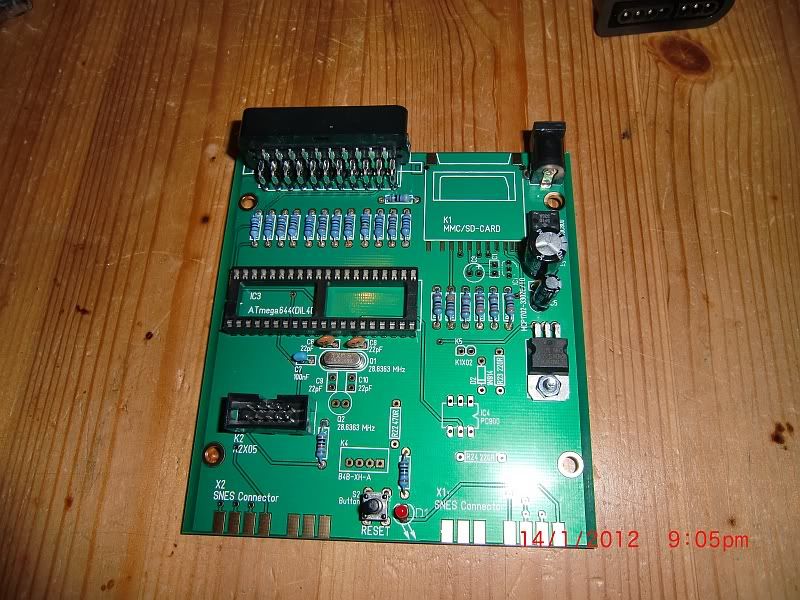

SCART socket, reset switch and ISP Header next...
http://i94.photobucket.com/albums/l1.../Euzebox05.jpg
Next was the only bit of surface mount soldering for the SD Card socket, which is much more straightforward than it would appear...
http://i94.photobucket.com/albums/l1.../Euzebox06.jpg

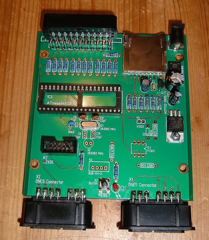

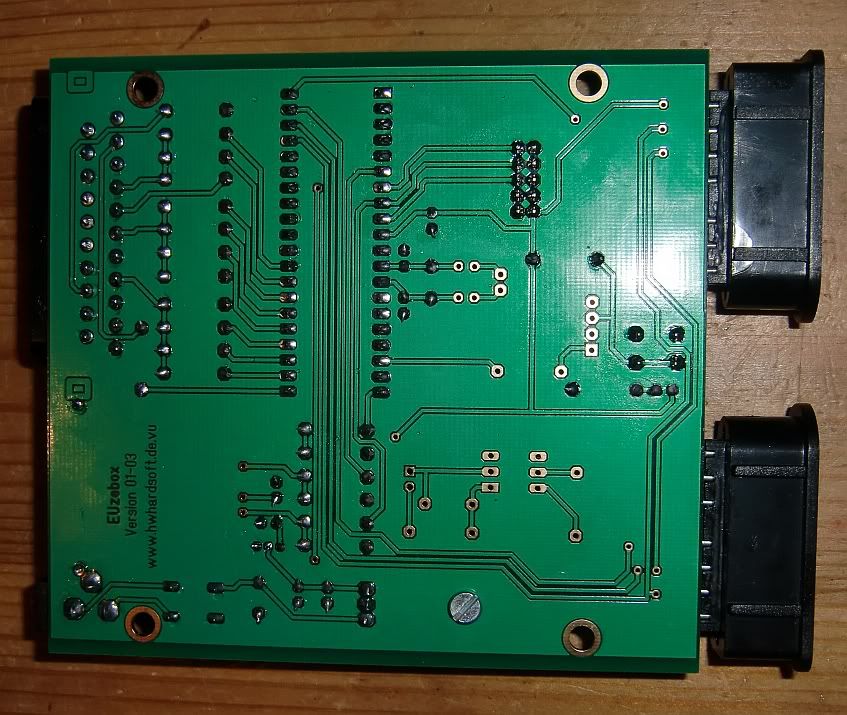

Finally, the SNES sockets at the front. Plenty of solder here to ensure a good strong bond able to resist the pull and push of regular use...
http://i94.photobucket.com/albums/l1.../Euzebox07.jpg

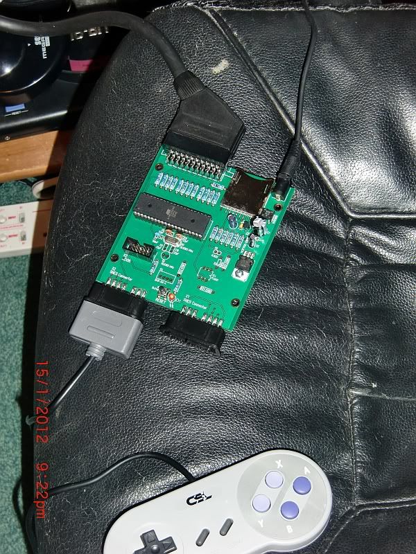

A shot of the base once all the components were welded in. Looks good to me, lets test her out...
http://i94.photobucket.com/albums/l1.../Euzebox08.jpg

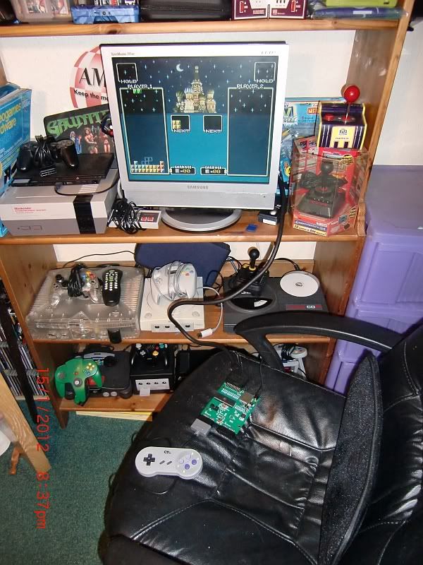

A power on test utilising a SNES psu (9v 1a), unconnected to the TV and left for a few minutes to check for unexpected behaviour. The LED is lit, as it should be, and there is no evidence of any shorts, heat or smoke. :thumbsup:
http://i94.photobucket.com/albums/l1.../Euzebox09.jpg

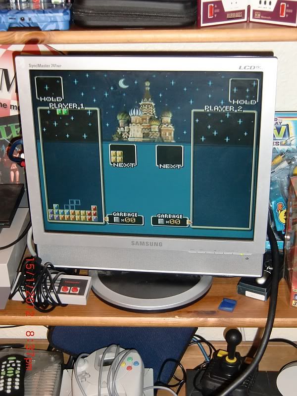

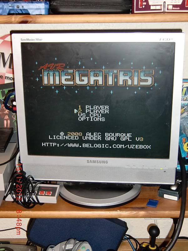

Plugging it in to the TV and she immediately came up with the startup splash screen for the built in Tetris clone. :)
http://i94.photobucket.com/albums/l1.../Euzebox10.jpg
It's a fun version actually, and graphically much better in real life than I was expecting TBH.
http://i94.photobucket.com/albums/l1.../Euzebox11.jpg
http://i94.photobucket.com/albums/l1.../Euzebox12.jpg
I really enjoyed building this, and I'm looking forward to putting a few more of the games available for it on an SD card and putting it through it's paces.
