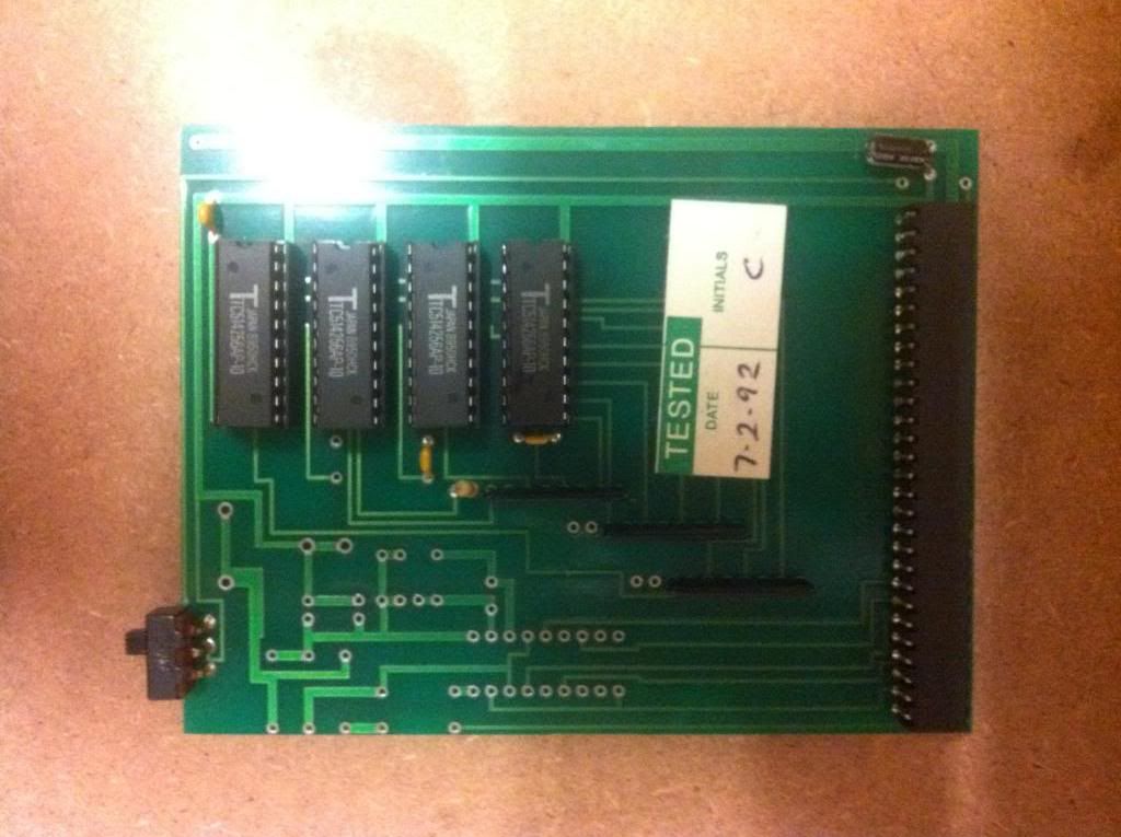

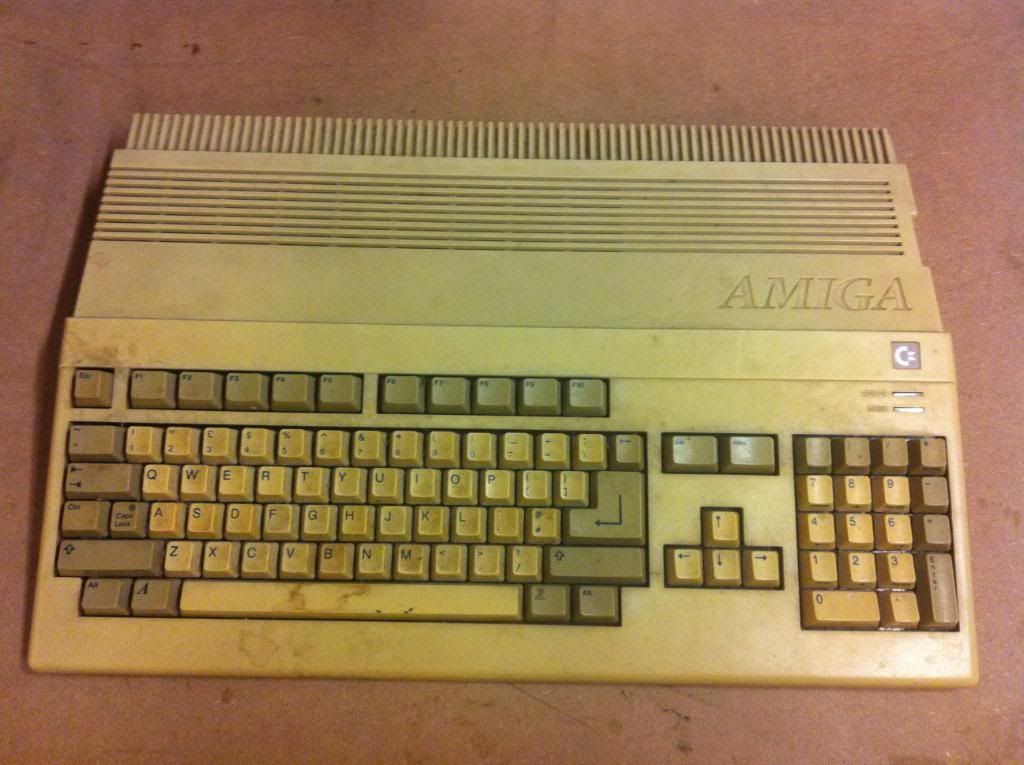

As you can see the case and keys are minging to say the least but you cant judge a book by its cover. When i stripped it down there was the usual ammount of dust in the case and floppy drive but under the keys was an utter disgrace. Once all that was out of the way i took the shield off and was amazed by how clean the board (revision 6b) was especialy for its age being manufactured in 1991. I gave it a clean down with a new, soft makeup brush and checked for the battery (now i know there isnt one) leak and checked all the caps for signs of leaks and damage. The board looks prety much factory fresh so i was very happy. Also the memory expansion was clean and didnt contain a battery so its just a case of performing the memory hack and cosmetic work.

http://i1269.photobucket.com/albums/...emoryclean.jpg

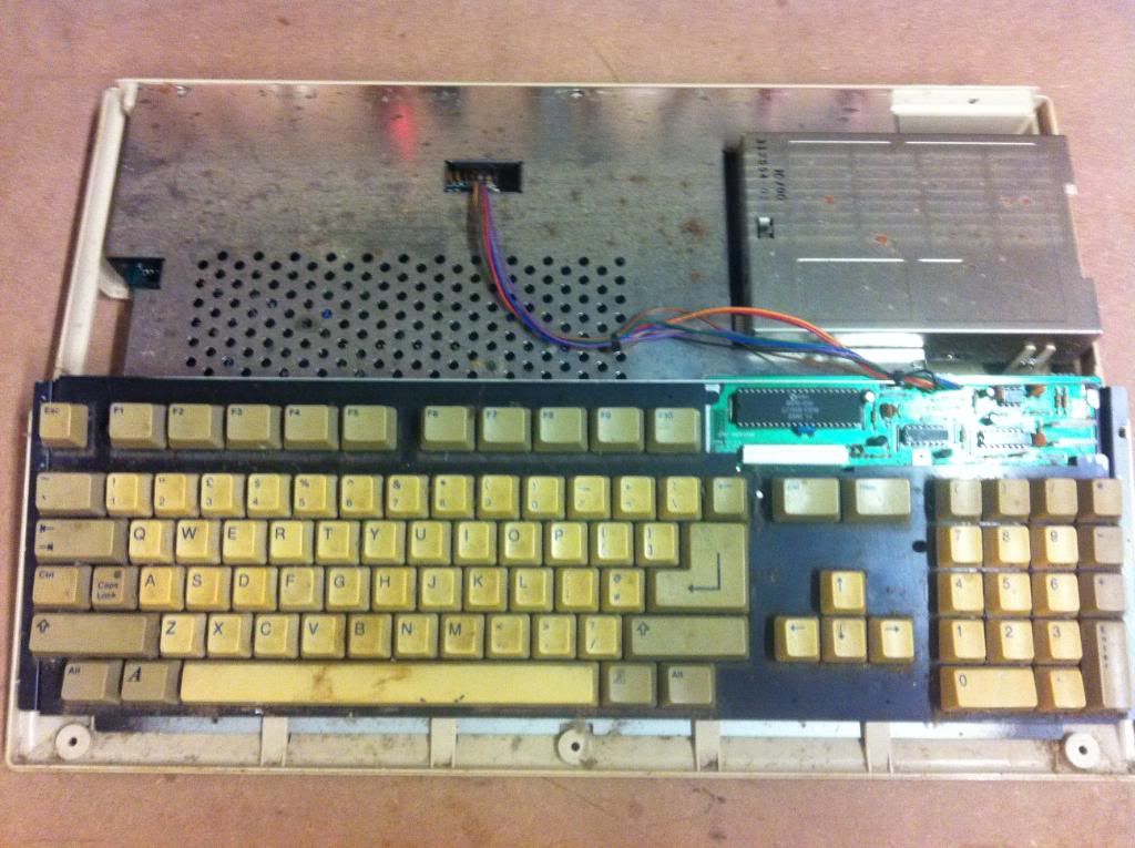

I then proceeded to clean up the keyboard and remove the keys (after taking a photo for placement) ready for retrobrighting. It was a fairly straightforward task provided you give the springs your utmost attention :D. Using a small flat head screwdriver and going corner to corner you cant realy damage the keys although the spacebar, shift and return/enter keys are a little trickier. Two of the springs on the spacebar assembly are a different size to all the others so keep these seperate to avoid confusion. I used a damp cloth to wipe away the 20 plus years of dust, coffee stains and biscuit crumbs and now it looks like new.
http://i1269.photobucket.com/albums/...boardClean.jpg
