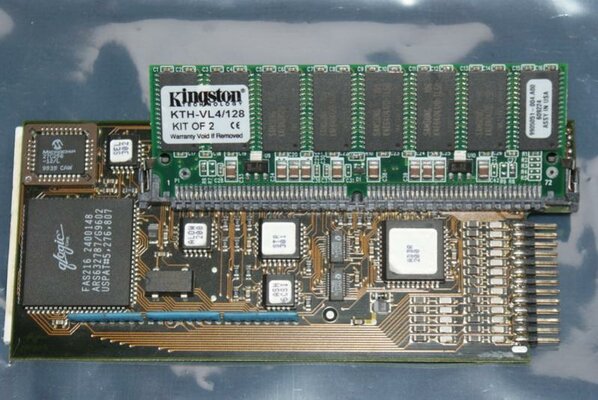

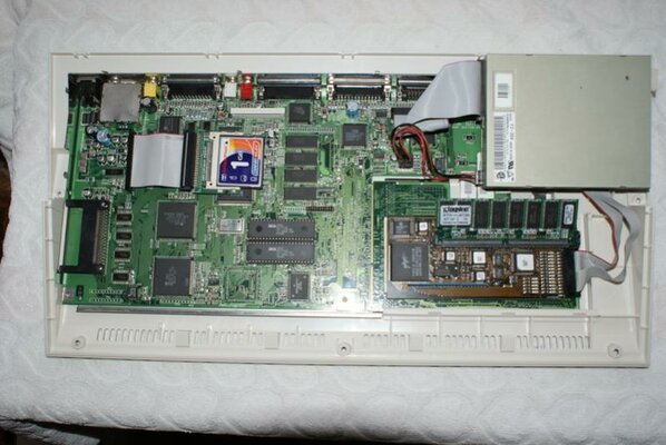

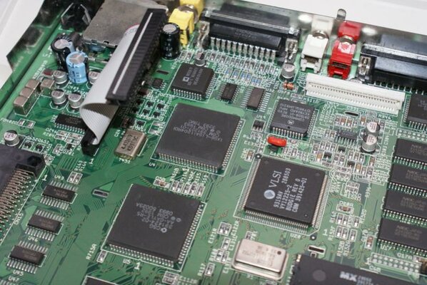

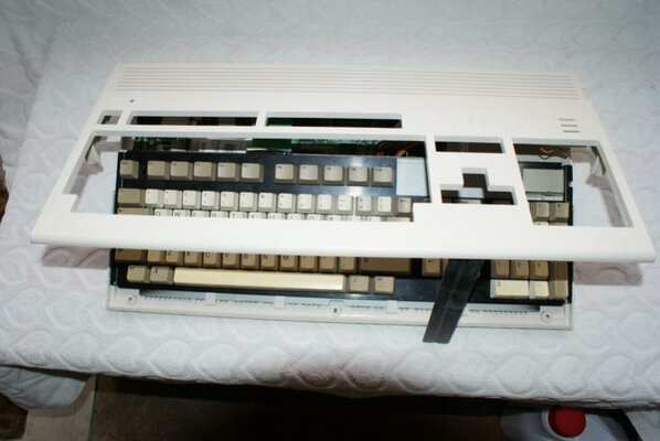

i have been sent an Apollo to test and fault find if possible , it arrived from a fellow amibay member and was DOA when it arrived.
the first visual inspection didn't look too good i must admit but hey ho..
first job was to clean the card properly and and examine the soldering. various untidy soldering was abound on this thing but on the whole it looked like it made contact. The more worrying things where the burning and scorching on and around the voltage reg.
as you can see a molex plug was added to the voltage reg and one or two components had or where in the process of being burned alive.
so i tided the card up and cleaned the burn marks as best i could and then resoldered any rough / burnt / damaged components.
i didn't touch the added extras!
first switch on .. dead / it even stopped the hard drive spinning.
so..
changed the voltage reg - dead same.
unsolder / change crystal - dead same
change to 68040 spec for testing & check the boot rom
BINGO - it lives with the following changed.
Regulator off.(supplies 3.3v) jumpered to 5v
crystal changed. (now socketed)
cpu changed to 68040 (5v)
so I'm running some stress tests at the min and then i'll change it back to 060 spec when my new motherboard arrives. my 2B hates 060 Apollos.
