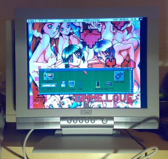

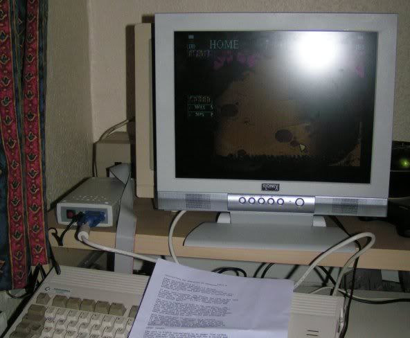

Hi, received this today. Sorry I can't get this to work for me on an A1200 PAL with a TFT monitor. At first I got a partial image on the screen, albeit the wrong colour. Now I don't even get that, just raster garbage.

I'm sorry you're having no luck with it. Did you try adjusting the gain?
As I remember it was a small adjustable screw near the end. If that doesn't work, by all means send it back to me, and I'll sort out a refund.

Some monitors will not work on 50Hz refresh rate (PAL output), so test the unit with another monitor, preferably a CRT one.
Re: FS: External Scandoubler for a1200's
Thanks rkauer and r0jaws, I found a monitor that can handle the frequency, and adjusted the gain, and it is now working as described.
