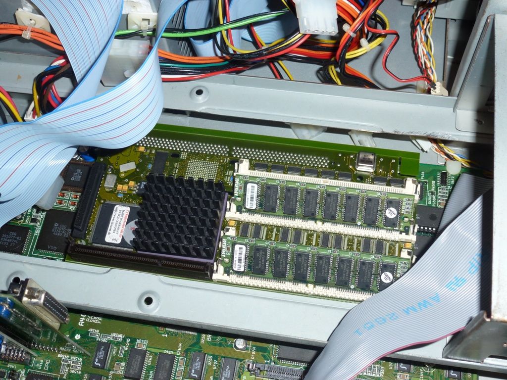

Anyway, I got a CSMkIII from a chap of at a.org a few weeks ago and it finally arrived today so I installed in my A4000T and it booted first time, I thought yay but it complained about the lack of 'workbench.library' since I was just booting WB3.1.
So I went to WinUAE and copied that onto my CF. Next time I tried to boot I just get a red screen and then black screen, it's done this since the last 10 or so attempts :(
(it does this even without the CF or any HDD connected so not related to the file I copied to libs)

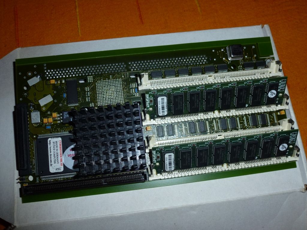

Of course the first thing I tried was to reseat the Kickstart but this didn't help, finally I tested another CPU and the A4000T boots as normal, so I guess the issue is with the CSMkIII, anyone have any idea's?
Next I thought about MapRom, but that is set in the boot menu which of course I can't access :coffee:
Anyone else have this issue before?
I would test in an A4000D but this MkIII is a bit strange, the PCB hasn't been trimmed down, so I don't think it would fit in a Desktop!
