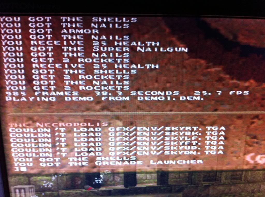

Quake Os 4 GL at 640x480 res Time demo Benchmark

25.7 fps is that on your ppc side? at 366mhz?
on quake in 640x480,is it in gl?
hang on i'll post a pic...
ok :)
i'll have to get a moderator or something,i tried to copy over a picture from my album and got a massive wall of text!!
You have to put some ware the picture like "image hosting" and after copy the direct link to it ...
Luigi
i have copied pictures from my album on here before mate with no problems,trust me something is wrong.
EDIT: ok one more time.
http://www.amibay.com/picture.php?al...pictureid=2506
hello,woopee,oh by the way its not ppc :) its in the same resolution 640x480. 16 bit.
i trust you mate ;)
what quake you use for make the tests?
I know my performances are low but this is the quakegl under Os4.1

no mate,are you ready?
its a real amiga,this is a 060@100mhz in gl on a voodoo in 640x480 in 16 bit

There it is.
And yes, it's Stan of course :cool:
