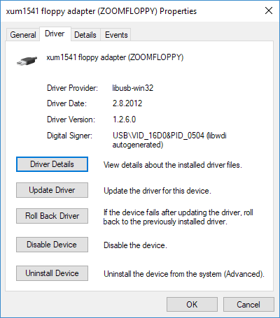

Got my mini xum1541 yesterday, thank you :thumbsup: But I didn't get it to work :unsure: I think the driver installation is correct (Win10):
Attachment 123878
The green light is on, but the 1541-II does not respond to any command like copy or format. No flashing light.
I'll check the driver details when I get back home. Does "cbmctrl detect" see your drive? It might be worth trying another cable, if not, I had some that just did not work for whatever reason.
Will try that when I'm at home .

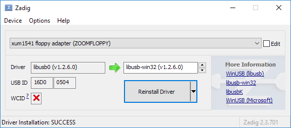

Looks like some update had again turned on driver signing for me and removed the old drivers. I used Zadig to install a slightly newer libusb-driver, and with this combination everything seems to work. Maybe you could try the same?

Got it! It is working now, thanks again :)
Great :)
