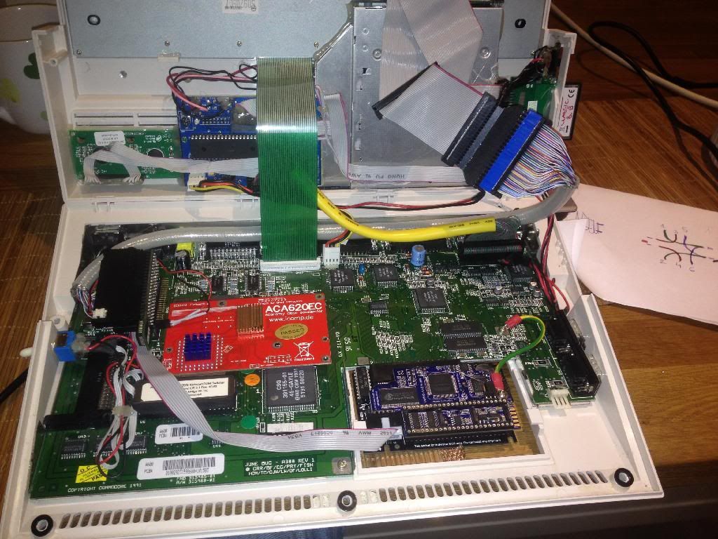

WHAT AN AWESOME MOD!!! AmmoJammo mate that is indeed some nice cable work and I can understand how time consuming it was!
I so love seeing such clean mods without excessive cabling around. Lotsa kudos.

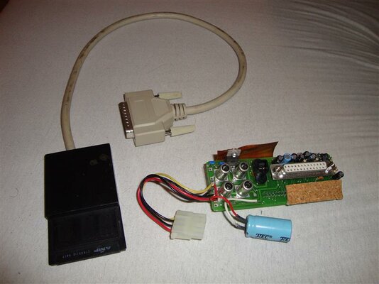

Pics of EIDE adapter as requested by AmmoJammo
Attachment 58905
Attachment 58906

http://i693.photobucket.com/albums/v...psjnaybhch.jpg
I installed on the right, that way accelerator fits. I now have ACA630 and A600 fully closes no problem
http://i693.photobucket.com/albums/v...ps2903eebe.jpg

Ok, things may not be quite as they seemed...
The "broken" adapter seems to actually work in the A600 today...
It will start to load workbench, (hdd light flashes) then just stop, never to start again...
The workbench install now has a version of IDEFix installed (was installed on real Amiga hardware, to an ide HDD, then copied to the compact flash)
It doesn't work!?!? I have had no luck whatsoever, with idefix, when using this compact flash card?!?
Now, I have to assume that the "new" cf-ide adapter also works, however, the CF card doesn't control the HDD light, hence it appearing to do nothing.... I assumed the HDD light worked, as the cdrom was causing it, and the light on the adapter itself, to flash as it spun up....
I now believe the old adapter is slightly intermittent, the new adapter probably works fine, and idefix doesn't work at all!
I can boot from a workbench 3.1 floppy, and halfway through booting, it accesses the compact flash card, without doing anything with idefix, and boots into workbench, giving me all the items that should have been on the desktop when booting from the cf card...
I think that A600 needs `Exorcising`;)
Ok, old adapter has taken up working again, (fresh copy of classic workbench again, so no idefix)
However, the new adapter won't work as slave, simply won't boot from the drive. As master, with no cdrom connected, it boots fine.
So! I have two new cf-ide adapters on their way from China, which I believe are the same as the first/bad/old one, so hopefully that works...
Now... to try and get the cdrom working again?!?

Tried an old 80meg compact flash, with the version of workbench that has idefix preinstalled (copied from a HDD)
And, failed...
Unless of course you boot with both mouse buttons pressed, then choose to boot without the startup sequence... then it boots just find to the CLI, or whatever its called...

Ok I have just got some more cables and guess what I changed nothing and no cdrom !, so the cable length is critcal regarding the power from the IDE header.
I had my cdrom on the secondary port (Unit 3) and the corresponding Dos driver in Devs.
What I did was go into the idefix folder ran the `Find device` and it could not find the cdrom.
So I put the IDE cable onto the primary port of the adapter (Unit 1) and ran `Find device` and Bingo yatzi said dvdrom showed up:cool:
So All I did then using a text editor was to edit the Dos driver file, CD3 by going it to the settings and changing the UNIT=3 to UNIT=1 and just renaming the Icon to CD1 (tidyness timothy),aso had to Edit the `eject icon` too to Unit 1.

The problem with the ide adapter you posted pictures of supaduper, is that there appears to actually be no buffering at all on the data lines...
It works! sorta...
step 1, find a version of idefix that can actually be patched...
step 2, find a program to patch it!
step 3, install idefix, which actually worked, and found the dvd drive.
step 4, restart, only to have CD0 not mount "cannot find scsi.device unit 0" or whatever it is...
riiight...
run "CD0" from devs/dosdrivers and the cd drive mounts every time...
so, how do I fix this? does having CD0 in the dosdrivers folder attempt to mount the device too soon in the startup sequence?
When you run ``Find Device` in the idefix folder what unit number is it ? if its 1, 2 try changing it in the CD0 settings
its 0 because its the master.
its all set right, it just doesn't seem to find the drive while workbench is loading.
