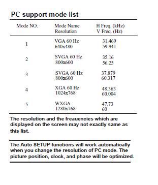

Card is detected fine (running in Z2 mode as you need a A4000 accelerator to enable Z3 on the Z3i) and the CGFX and Picasso96 drivers see the card just just fine. However haveing tried for 8 hours editing display modes and such I cannot get anything to display on my modern LCD's best I could do was get 'Out of Range' on my LCD TV.
What I am thinking now, is to change direction and go for a Mediator PCI setup and a Voodoo GFX card as I am hoping that I will have more joy on my modern LCD displays, do you think that would be a good way forward?
