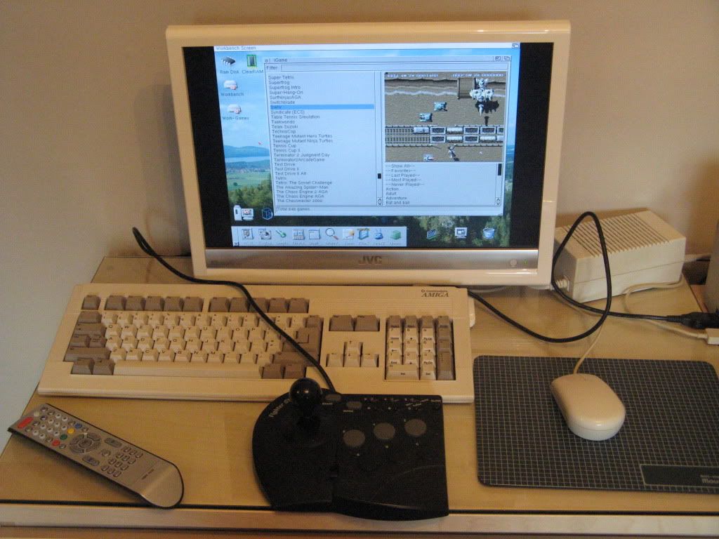

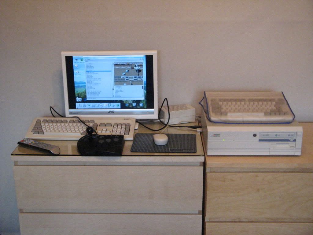

Anyway for now - this is the happy couple chillin out! (Don't worry they're fully covered from the nasty light when not in use!)
http://i294.photobucket.com/albums/m...g?t=1286234889
Thats not yellowing by the way, just the light from outside ;)

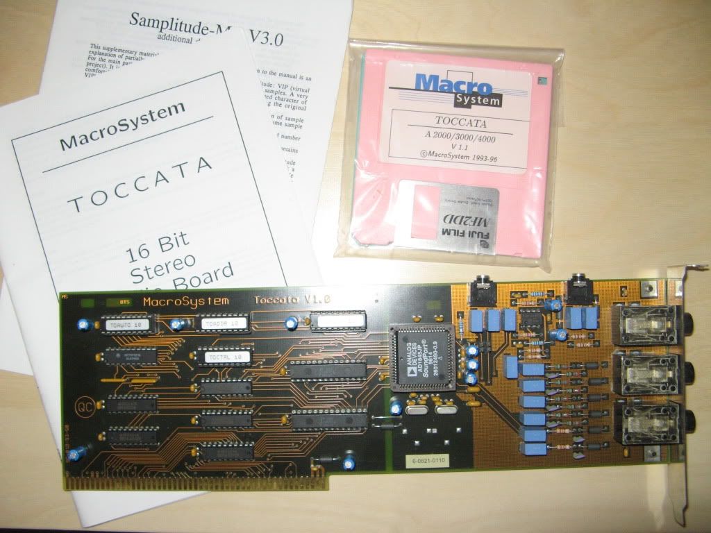

I installed the Tocatta Sound Card today :D
http://i294.photobucket.com/albums/m...g?t=1286749746

you havemy envy my friend, I have wanted a toccata for evers! lol
I remember having the idled dream that one day my A1200 with its Winer Z4 busboard would have one of these one day....
Irony is now I have PCI for that puppy with a nice choice of Audio cards to choose from.
still that does look a monster in that thing - remember 16bit recording direct to drive is quite nice - and a great way of creating sound files for use with MakeCD =D
This is all looking rather lovely :thumbsup:
Great machine - what software are you running on it?
nice machine and build mate, i wish i had the money to get a 4000 i have always wanted one maybe oneday.
Thanks guys, I really love this machine - I never thought I would join the big box club but when the opportunity came along to own this fabulous machine and so pleased I got it!
@chiark I'm running Classic Workbench OS3.9 and play CD games such as Doom/Genetic Species/Gloom and WHDLoad. Also like to mess around in workbench as the 040 @40mhz really makes its way round the OS very fast indeed.
Looking forward to having some fun with the Tocatta, I like the idea of the 16bit recording :D
There's some software bundled with the card that I want to take a look at.

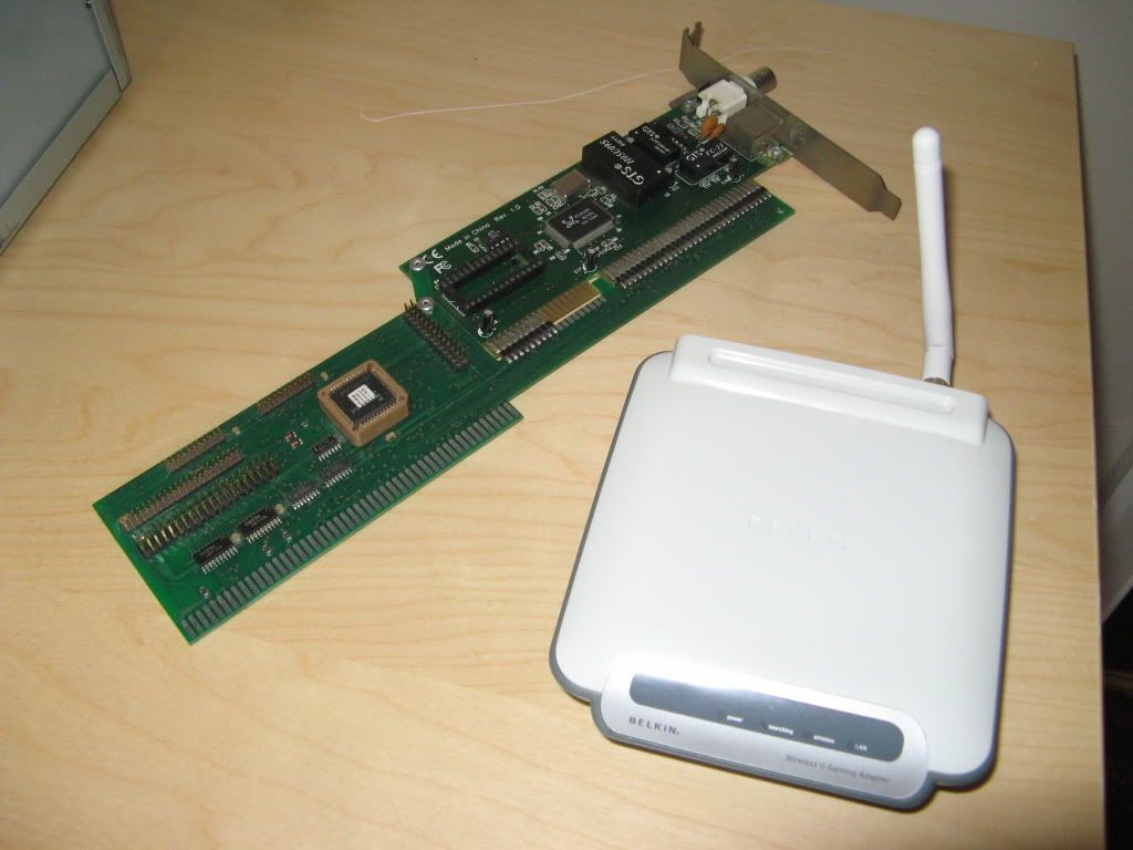

First I tried to install my X-Surf that arrived earlier in the week but it just wont boot with the card inserted, probably another Buster9 issue so I've started a help thread here
I have already asked missus Fitz to get me a Buster 11 for my Birthday so will just have to wait on that...
Here is what I was trying to setup:
http://i294.photobucket.com/albums/m...g?t=1287239038
I've already configured the gaming adapter for my wireless network, so in theory if the X-Surf was working I should be able to get online via WiFi with the Sana2 Driver and MiamiDX, but today it wasn't meant to be, shame because I wanted this ready for the R3tr0 R3play event.

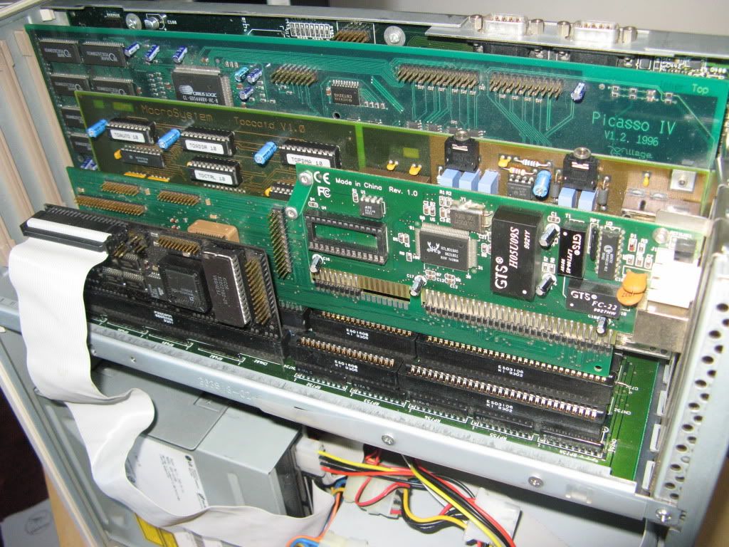

Its been a while on this one! But my A4000 is back up and running :D
I got my new daughter board today and as soon as I re-built the PicassoIV was working fine.
So I tried with the X-Surf again and she still wont take it, flashing power light.
And after removing the X-Surf the Picasso stopped working again (the scan doubler) :blink:
The problem seems to be that the X-Surf is too big and pushes the daughter board out of line, I think this may have done lasting damage to my old daughter board. As soon as I realized the problem the X-Surf was out and I re-built the machine again.
Thankfully the PicassoIV is working fine again, and I really hope it stays that way now :whistle:
Screws are back on and I'm not opening the machine again unless I really have to!
Steve.

think only one PC here has case screws one nearly every machine has easy access, that is no case screws :)
if it is pushing it out a bit, try taking the plastic runner of the back see if that gives it a little bit more room,

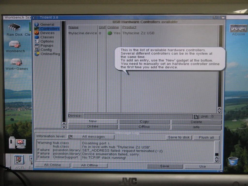

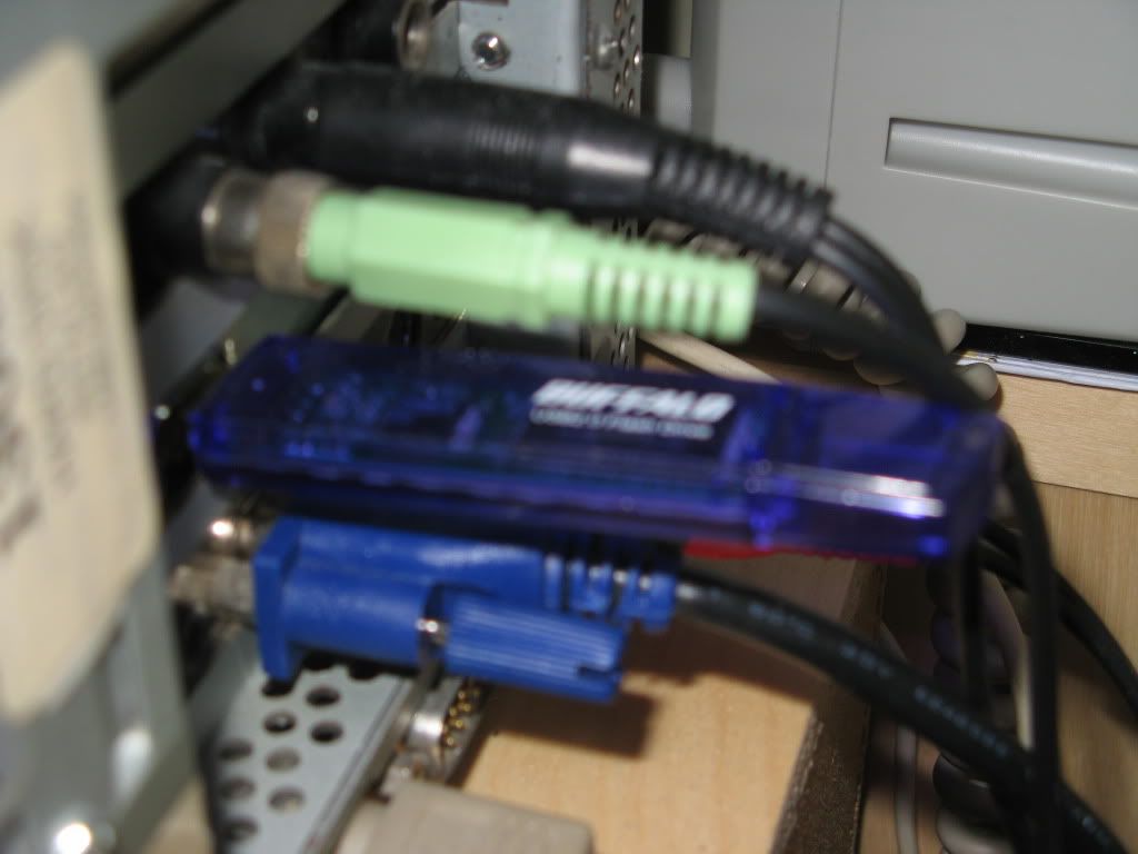

Finally got round to installing this little fella last night and tested this morning as I had the wrong files. I used the Siron stack first but realised it didn't support USB Mass Storage which was one of the main reasons I wanted simple USB on this A4000, the lack of a PCMCIA makes file transfers a bit of a PITA and I hate burning CD's etc... Also I'll get the benefit of USB Networking when I find a suitable adapter.
Well here she is, the card was a little too long so didn't fit at first - I had to take out the screws holding the backplane in place, but its secure enough.
http://i294.photobucket.com/albums/m...e/IMG_1438.jpg
And my little USB Flash Disk plugged in :)
http://i294.photobucket.com/albums/m...e/IMG_1441.jpg
And some shots of it up and running :cool:
http://i294.photobucket.com/albums/m...e/IMG_1439.jpg

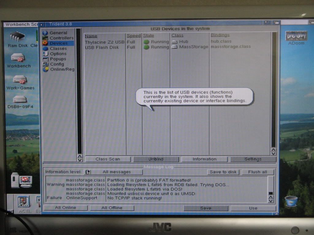

I get this set address failed error on first boot - but a restart fixes that, weird eh?
http://i294.photobucket.com/albums/m...e/IMG_1440.jpg
There we go USB working and Flash Disk detected :D
http://i294.photobucket.com/albums/m...e/IMG_1442.jpg
= One happy Steve :drinkin:

I see long time a go some bards like this one, but is the first time I see a working one.
Nice update and thaks to share pics :)

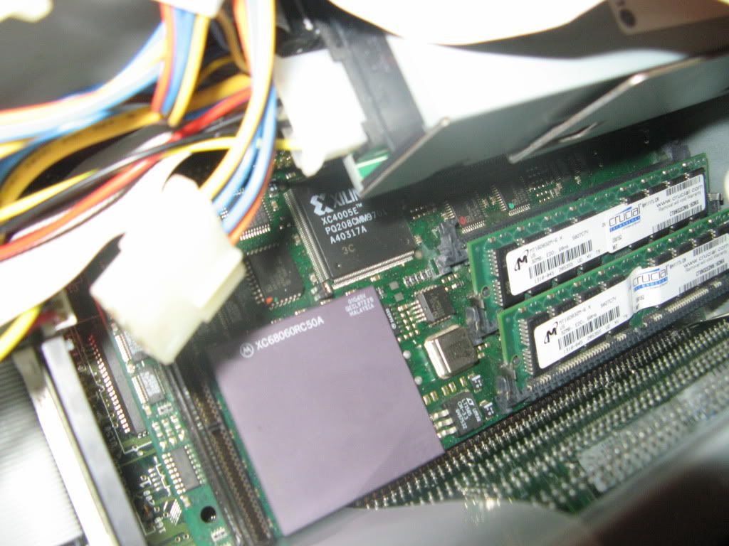

SCSI Kit will be going in tomorrow - its a CSMkII 060@50mhz by the way :thumbsup:
Hey! I think I see a Toccata!
Also, why "only" 64Mb in the CS?
