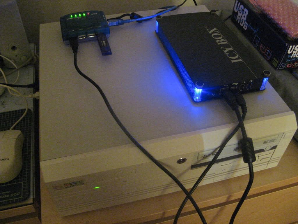

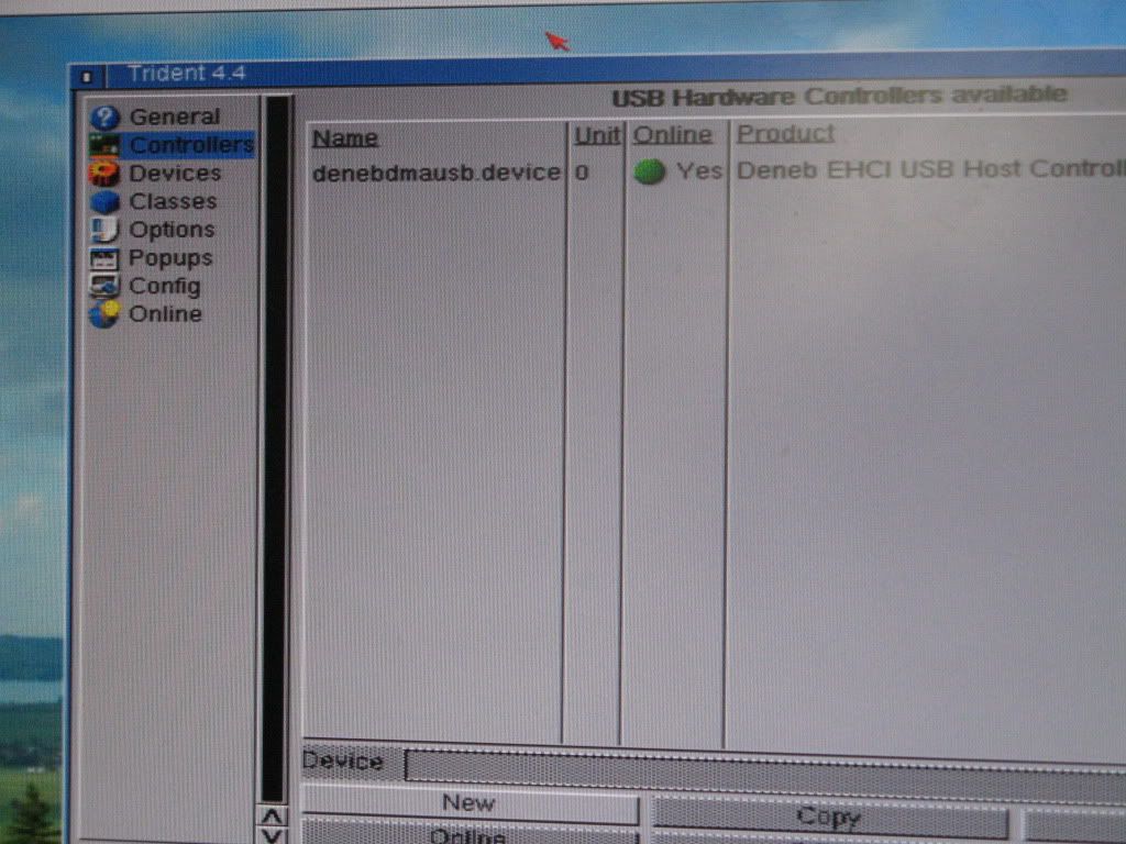

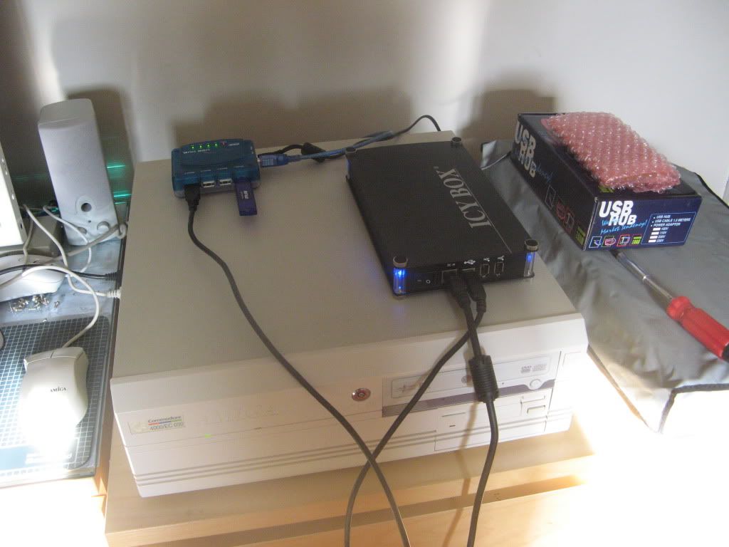

Just a very little update, I got some new toys this week that I have been playing with, useful to all my USB setups :)
I got an ICY Box external HDD enclosure which has a nice new 20gb ATA HDD inside, of course its also perfect for prepping up disks in WinUAE.
I've set this one up with a couple of SFS partitions to share between my Amiga's, on my Deneb its pulling 5.7mb/sec which I thought was pretty impressive :cool:

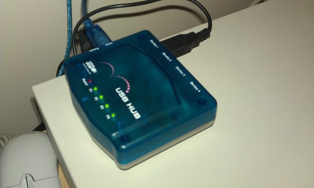

In the pics below its on the Thylacine in this A4000 so only USB1.1, I got a little Powered USB1.1 Hub of eBay for peanuts and its working a treat plus ideal as the Thylacine only has 1 USB port...
At some point I'd like a Deneb for this A4000 too :D

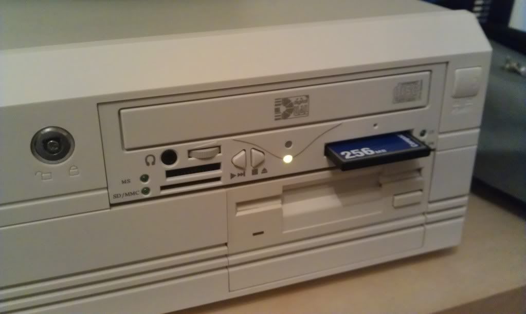

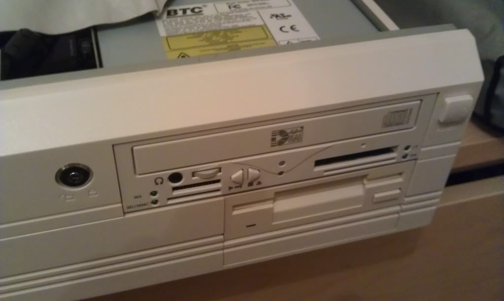

I got a nice addition to this project to share with ya'll!
Its a CDRW with built in USB Card reader :)
http://i294.photobucket.com/albums/m...e/IMAG0081.jpg

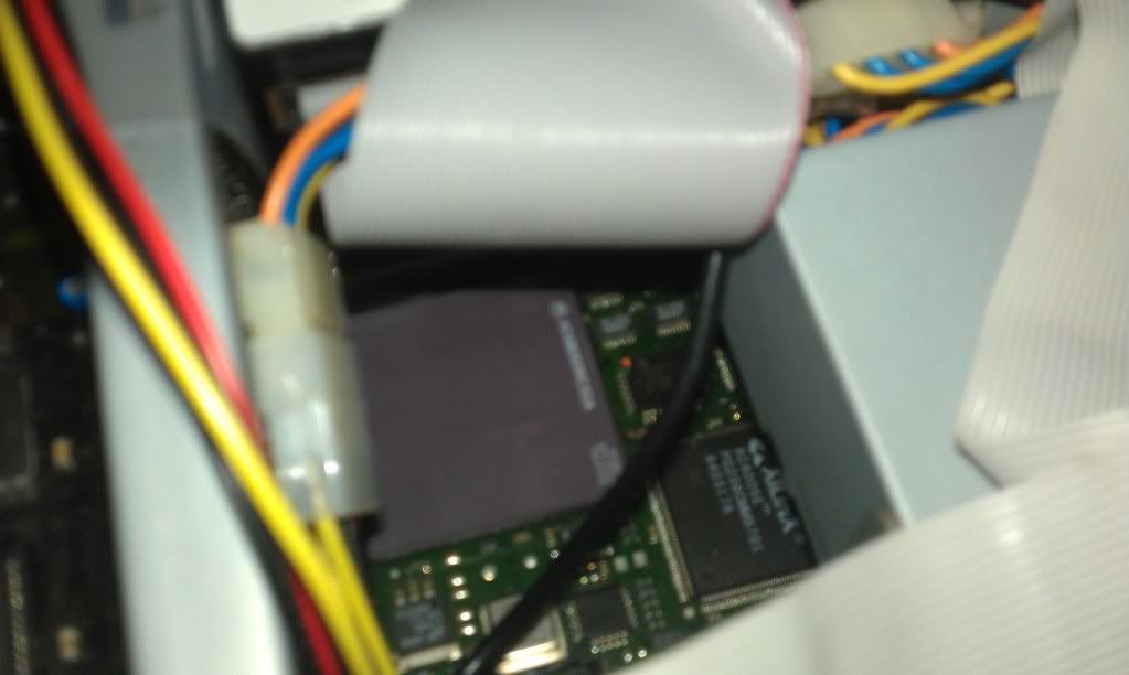

Its quite a large unit, but I managed to fit it inside by raising the HDD to the upper part of the bracket (else I couldn't push the drive all the way into the bay)
http://i294.photobucket.com/albums/m...e/IMAG0079.jpg
As you can see, still some room for the 060 to breath :D
http://i294.photobucket.com/albums/m...e/IMAG0080.jpg

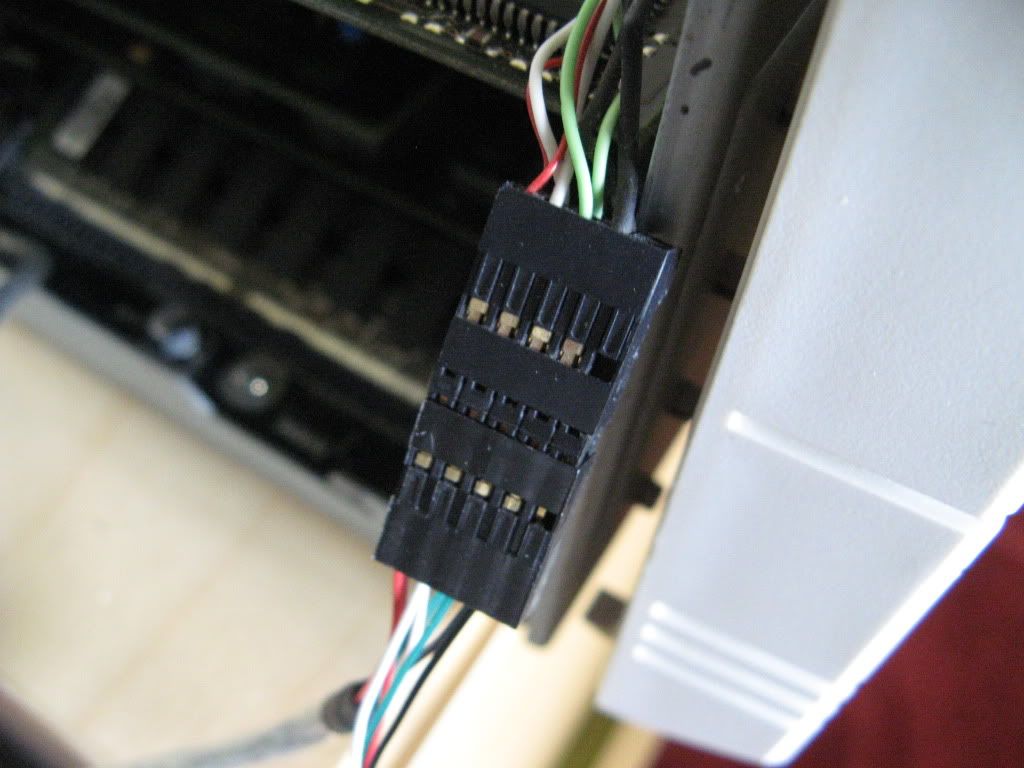

The USB connector fits a 5pin header and will be ideal if I get a Deneb for this machine, for now I used a converter to standard USB - A connector and ran the cable outside to my Hub as the Thylacine has no internal headers.

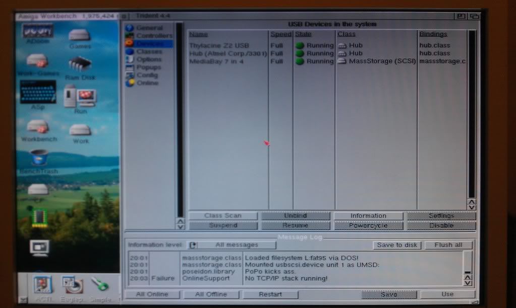

And all back together and working :)
http://i294.photobucket.com/albums/m...e/IMAG0092.jpg
http://i294.photobucket.com/albums/m...e/IMAG0096.jpg
I'm really pleased with this unit, its an ideal solution for this setup :thumbsup:

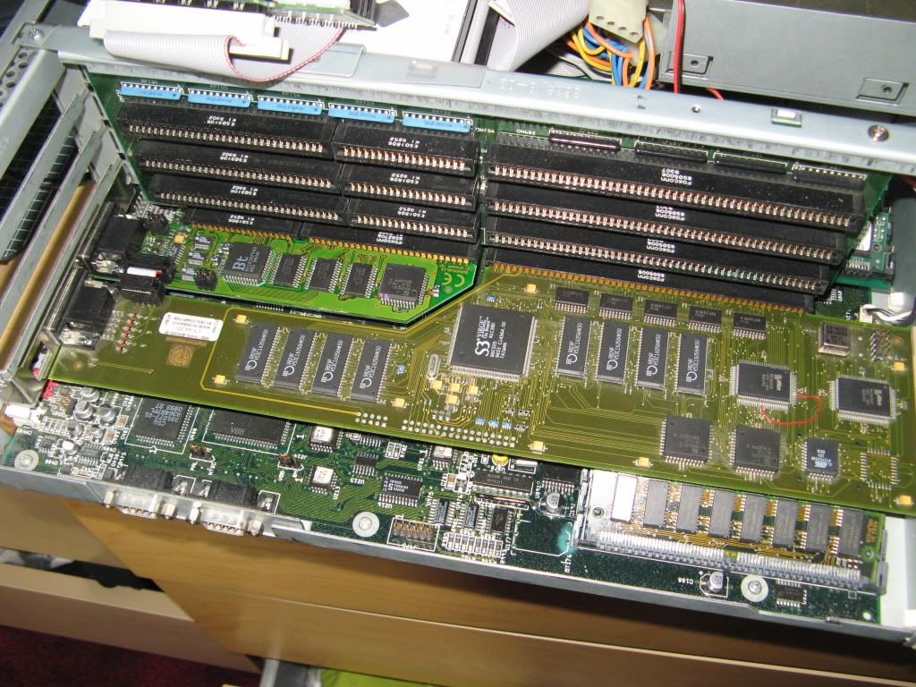

First change is I swapped out the PicassoIV for my CV64/3D, since I have a PicassoIV in my A4000T I decided to take a different route with this project for now, of course if I ever find a CVPPC for the Tower the Picasso might find its way back here :whistle:
http://i294.photobucket.com/albums/m...e/IMG_1960.jpg
And reinstall my Toccata and DenebUSB :cool:
http://i294.photobucket.com/albums/m...e/IMG_1961.jpg

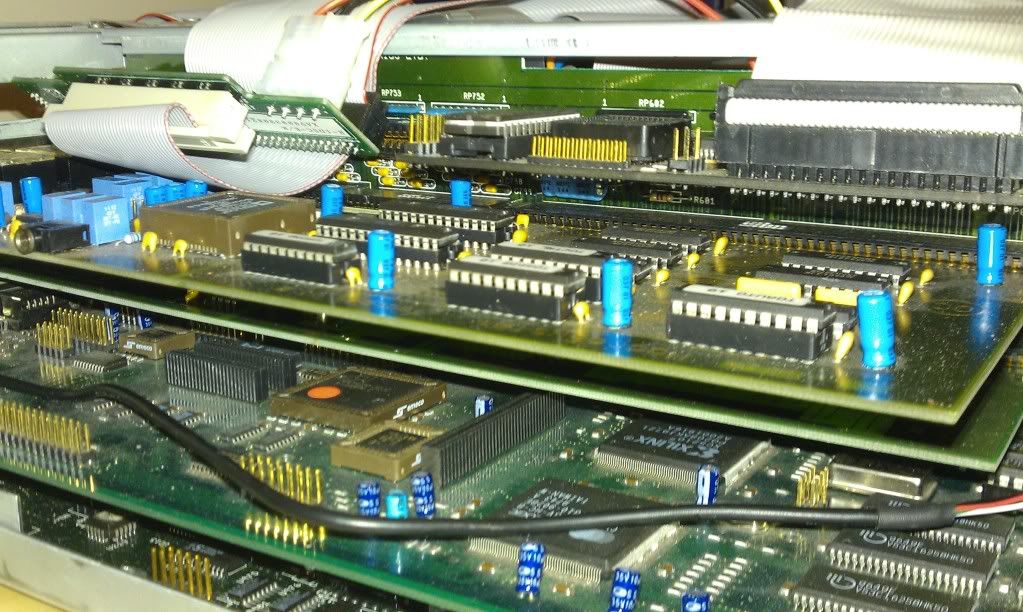

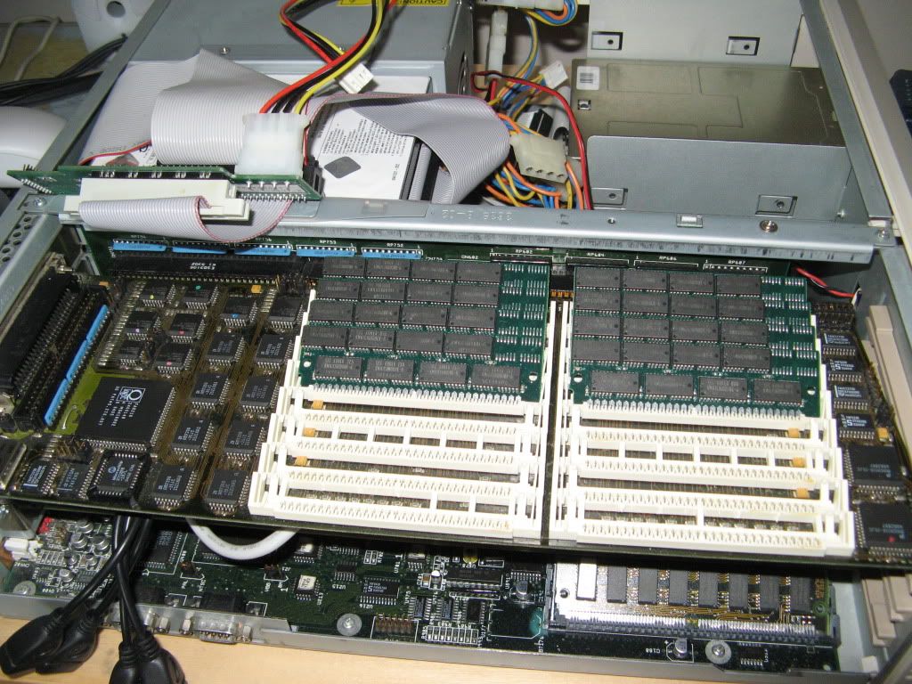

Since I have lots of Ram in the A4000T I decided to use the Fastlane Z3 in this project, and since this is Buster 9 I'm not limited to 1 DMA master I can have the Fastlane Z3 and Deneb running in DMA mode!
Also happy to see no conflict with the CSMkII/SCSI or CV64/3D which can be a known issue in this configuration!
http://i294.photobucket.com/albums/m...e/IMG_1962.jpg
http://i294.photobucket.com/albums/m...e/IMG_1963.jpg
http://i294.photobucket.com/albums/m...e/IMG_1975.jpg

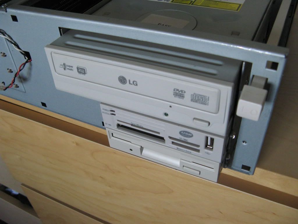

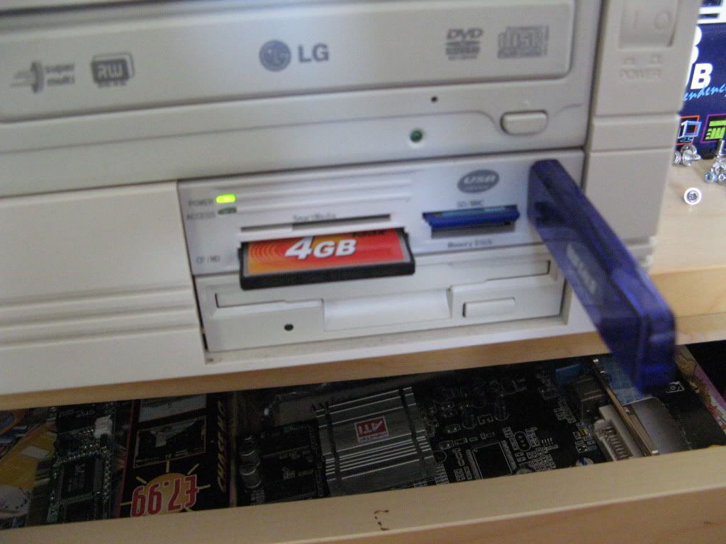

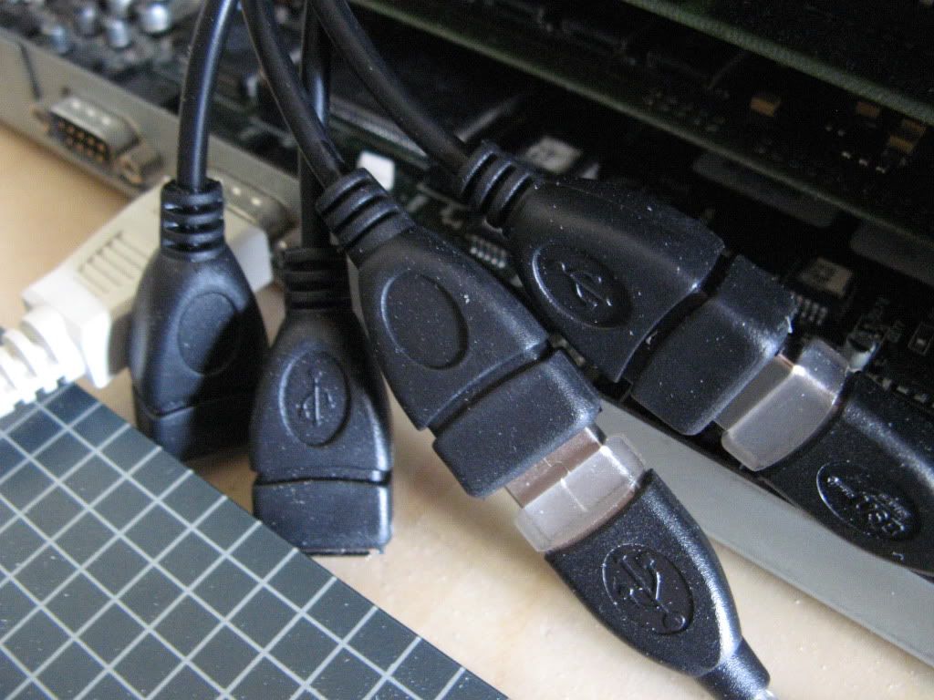

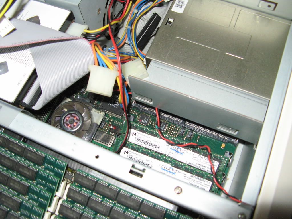

I also decided to switch the CDROM for a shorter DVD drive and also replaced the tall HD Floppy with a new FDD and USB Reader, plus custom adapters via USB2 Hub going into the Deneb.
http://i294.photobucket.com/albums/m...e/IMG_1966.jpg
http://i294.photobucket.com/albums/m...e/IMG_1968.jpg
http://i294.photobucket.com/albums/m...e/IMG_1969.jpg

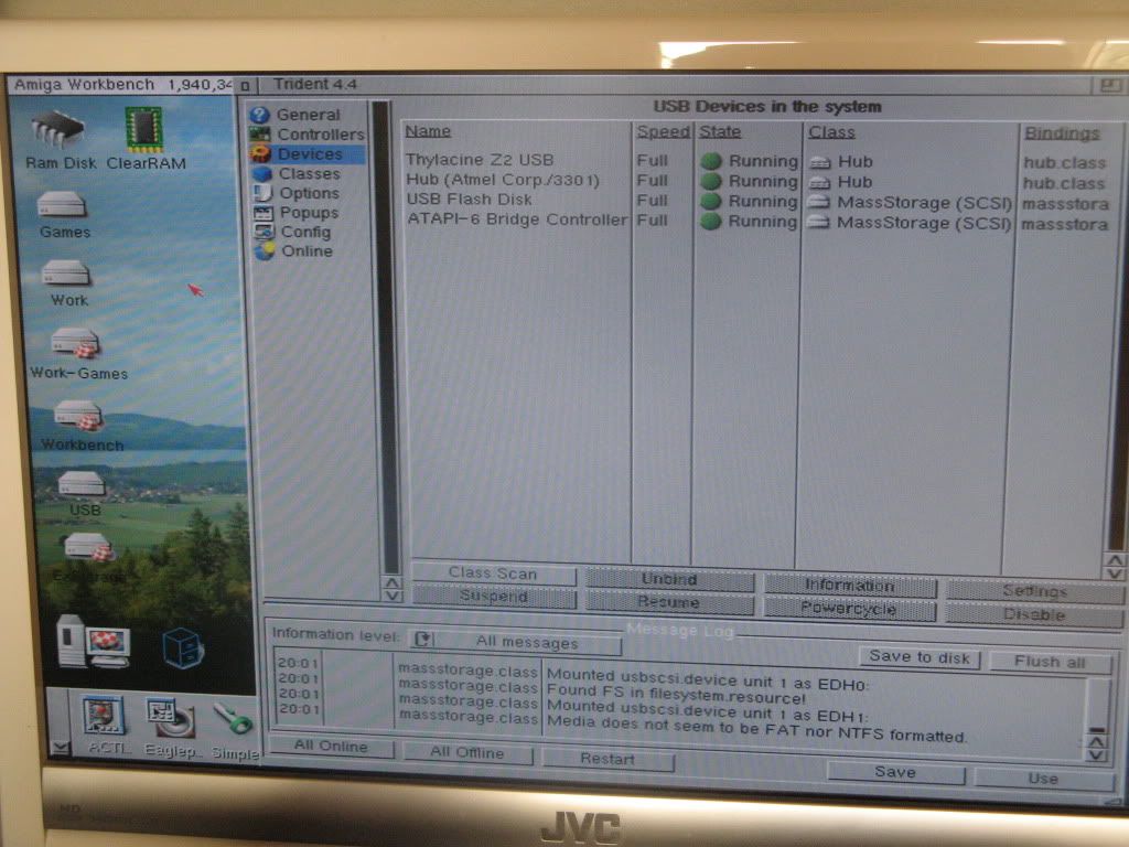

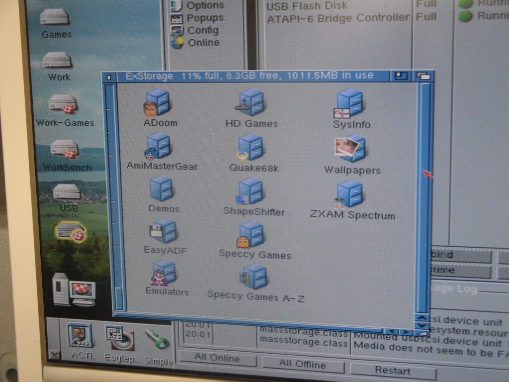

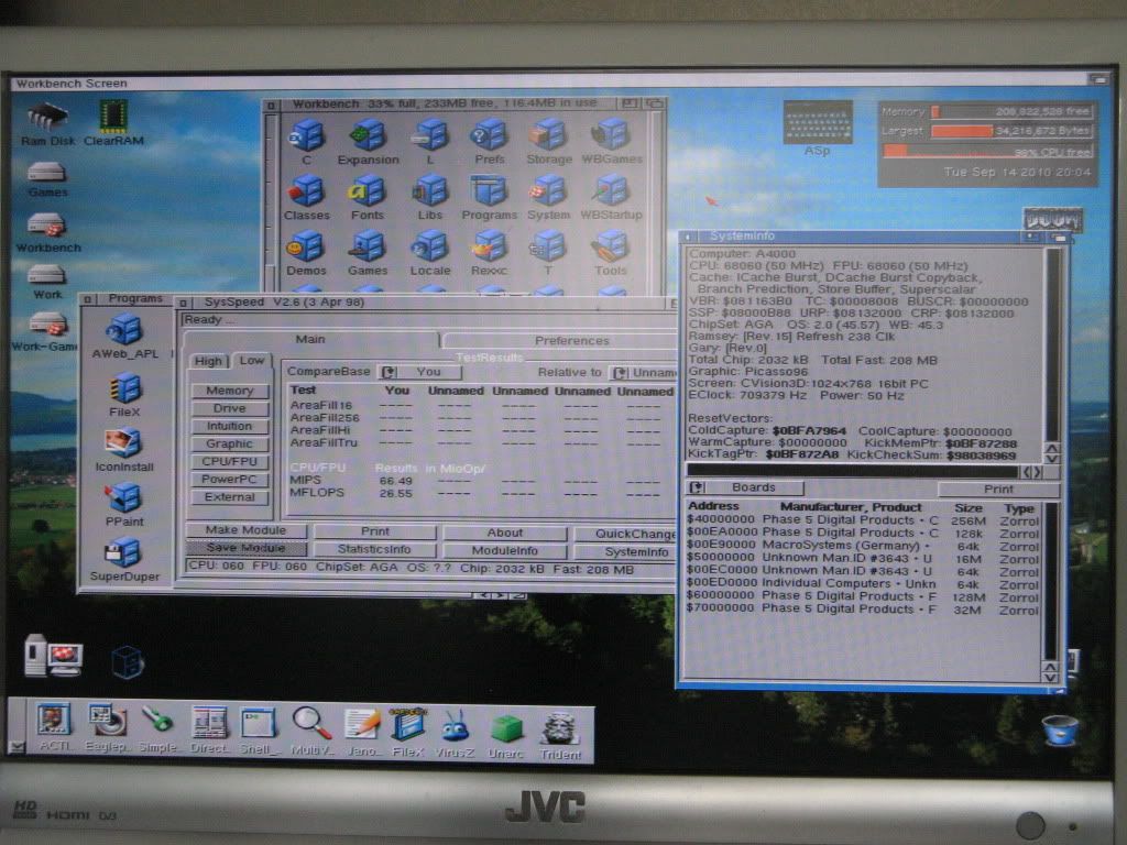

As you can see everything is working! (Not expected on the first attempt but it did!)
http://i294.photobucket.com/albums/m...e/IMG_1972.jpg
http://i294.photobucket.com/albums/m...e/IMG_1964.jpg
http://i294.photobucket.com/albums/m...e/IMG_1971.jpg
http://i294.photobucket.com/albums/m...e/IMG_1974.jpg
