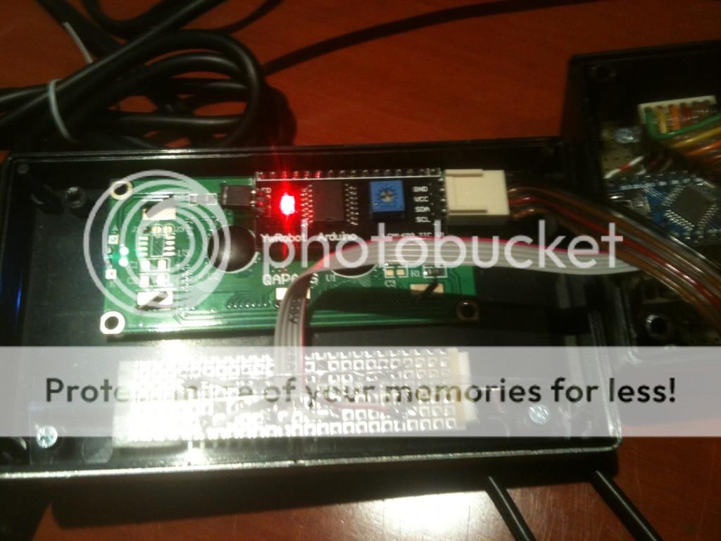

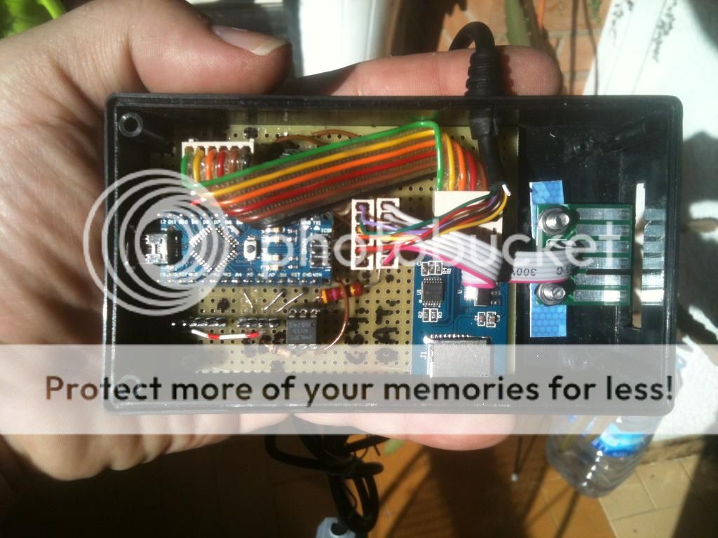

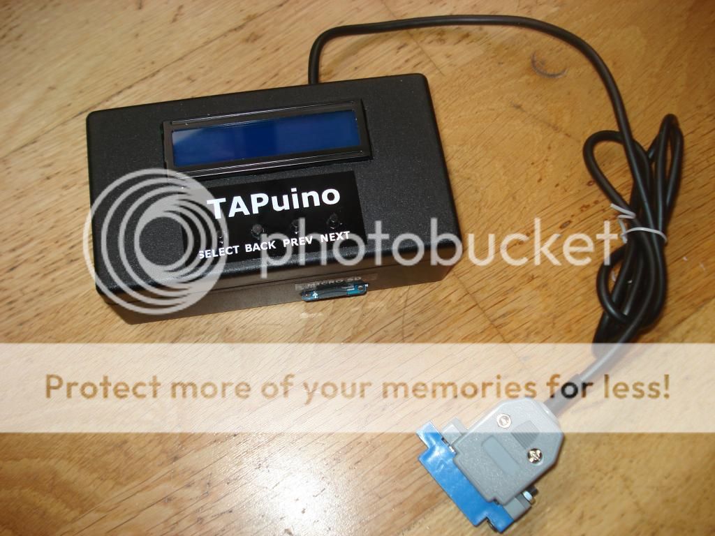

    I was on a retro event in Barcelona (Spain) last month, RetroBarcelona 2014.
    With Bieno from Commodore plus, and showing my Tapuino with info about the project.
    I finished fitting the Tapuino in the black plastic enclosure just the day before the event.
    It will be nice to design a PCB to make the assembly easier, if some people is interested I can try to make.
    I was trying to post some links but the post is lost??? So I put some pictures:

    Wow! I'm just blown away... Fantastic build and thanks for sharing the pics and the Tapuino with others!
    I'm in the process of getting a board made at the moment and have a design that I can share with you. I'll put the Eagle files up on github tomorrow.
    Again... Wow I would have loved to have been there to see your display in person.
    -(e)
