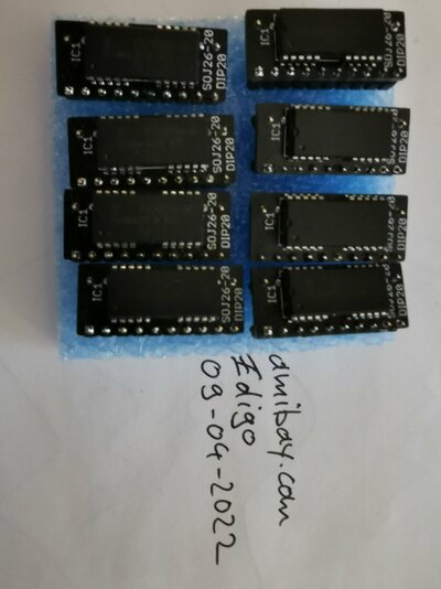

Hey guys,
I recently updated my Rejuvenator clone to an Agnus 8375 with 2 MB ChipMem and don't need the 1 MB ChipMem for the 8372 anymore.
The guy building the Rejuvenator clones (I've also got mine from him) gave me the hint to sell the memory here.
I will ship worldwide if necessary.
I'm asking for 40,- € + shipping.

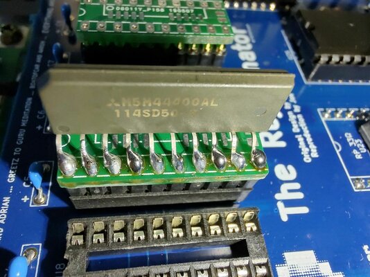

How did you make the 2MB chip work? I tried with SOJ to DIP and ZIP to DIP but I couldn't get it to work. Could have been my soldering skills or the VBB A3000 Angus 318069-18 isn't compatible (I got 2, neither worked). Power light just kept flashing and nothing else. I would pay a small fortune for someone to supply the right stuff to. bring my A1000 into a 2MB chip configuration but can't see anyone offering it.

A 318069-18 with 4x 514400 on SOJ-to-DIP adapters should work. To avoid stability issues, make sure to apply the VBB hack by removing resistor R14 and mounting a 100nF capacitor between pin 41 and GND.
I have the 318069-18 working together with the SOJ-to-DIP adapters to get 2MB chip. So the issue is on your side, which is a bit difficult to determine the root cause from a distance.
Did you apply the VBB hack as proposed by m0c?
Additionally, you can even use an 390544-01/02 or a 318069-10/11 using the A3000 390544 adapter.
