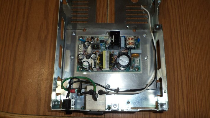

Guys, here's my Commodore Project. Replacing that old, and heavy Transformer in my 1571 Floppy Disk Drive , and fitting a cooler "Mean Well PD-25A AC to DC Power Supply".. Which has 5v 2.1 amp, 12v 1.2 amp output. It's very easy to do.. But the external fuse had to go because there's one on the board , so it was not needed... To finish off. I'm waiting for the connectors and pins to arrive, so I can attach the wires to the board. Oh, which input wire goes to the L.. White or Black.. Man this floppy drive will be a lot lighter.. Without that large and heavy transformer...

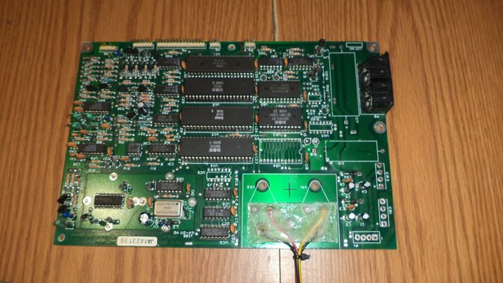

Oh, I did remove some components from the main board. Because they are on longer needed..
