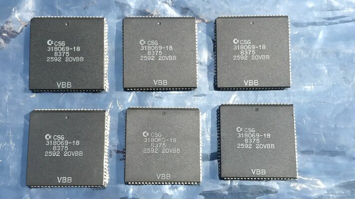

For sale 6 units of 2MB 8375 AGNUS 318069-18.
PAL version. For 3000 and 3000 Tower.

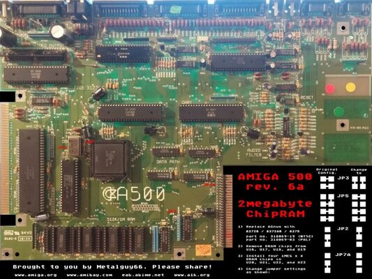

Can also be used onto A500 rev6a with mod to have 2MB directly onto the motherboard !
Mod described in pictures below.

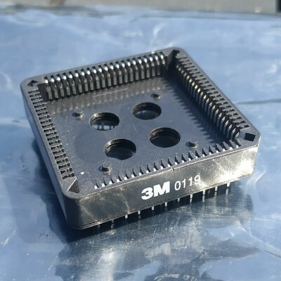

Amount for one unit + one smd 1206 100nF capacitor + one new 3M PLCC socket : 150€ + tracked shipment.
Paypal payment only "for friends and family".
Shipping costs for France: 2.82€
Shipping costs for the rest of countries for the list below: 6.45€
Amount for France: 152,82€
Amount for the rest of countries for the list below: 156.45€

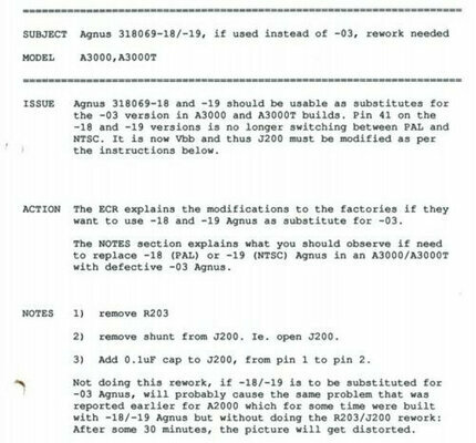

@PropBlast
318069-19 = NTSC
318069-18 = PAL
Note that both are VBB and therefore require the "VBB hack", i.e. a 100nF capacitor between pin 41 and GND. Agnus 318069-03 uses pin 41 to select between PAL and NTSC.
I am successfully using a 318069-18 on the A1000 Rejuvenator, the design of which is more or less identical to the A500 rev.6a
While refering to the picture you posted from this thread - https://www.amibay.com/threads/2megs-chipram-on-rev-6a-amiga-500-motherboard.89654/ MetalGuy66 says that 'Only an actual A3000 Agnus (one of the two part numbers listed in the picture) will work so I take it that the adaptor is required to use these in a A500 rev.6 motherboard?
As said m0c, 318068-18 is PAL version of 2MB AGNUS which works onto A3000(T) as explained in the first post of this thread, and also on A500 Rev6a thanks to mod explained into the last picture of this same post.
So, AGNUS 318069-18, can be used onto A3000 and A3000T with 100nF capacitor connected between pin 41 and GND, and can be used also onto A500 Rev6a with mod.
