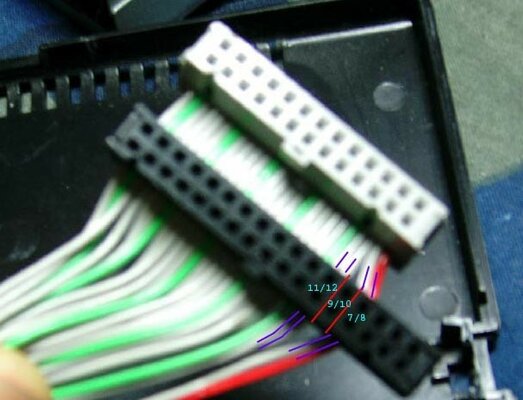

Can be replaced by a 3.5" with some modding skills.
IMHO the best choice are the samsung SFD-321B because has a solder point to convert the used by PC signal DiscChange (DC) to Ready (RDY) used by CPCs, ZX+3, MSX, some XT-PCs...
Then just a little mod to the data cable and flip the power cable (pinout is reversed 5v and 12v are swapped, but you only need the 5v and ground).
Also some internal modding is needed for the case...
Edit: I have an image for the data cable
Just leave pins 1-6 and 9-10 free as the image.

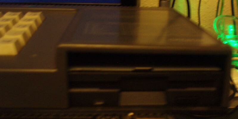

To give you an idea, this is how the mod looks on my CPC6128 after I picked up one which had no 3 inch disk drive in the bay.
Hope this helps :-)
