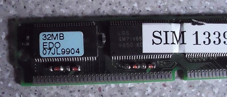

One of the Blizzard 1230 MK-IVs I have came with 16MB of fast ram. However, when removed, the simm is double sided and has a sticker on it saying 32MB EDO.
I've replaced this SIMM with a new 32MB one and that is being correctly recognised and showing as 32MB.
Anyone got any ideas why this other SIMM is only showing as 16MB? Or could it really be a 16MB SIMM and the label is just wrong?
It doesn't have any make or obvious model numbers on the SIMM. Just 8 IBM chips on each side and a sticker saying "1095789 26266 32MB EDO". And some writing at the edge of the ram saying "B7340C 94V-0".

@ Harrison
I believe we both have SIMM's that exhibit the same symptoms.
This SIMM is labelled as 32mb but is actually a 16mb. The only thing I can conclude is that the 32mb moniker is for the entire amount of a matched pair.

Only another 1230. I don't have anything else at the moment that accepts 72pin SIMMs that large. It isn't a huge problem as I have enough other 32MB SIMMs now. Just wondering if this one really is a 32MB simm or not. Maybe it is just that the 1230 can't see it fully, whereas the other double sided SIMMs I've tried it can.

The other gotcha with 72pin SIMMs is the size descriptions:
1Mx32 = 4MB
2Mx32 = 8MB
4Mx32 = 16MB
8Mx32 = 32MB
This might not be the issue in your case, but it's worth bearing in mind, especially when naughty eBay sellers claim 32MB on SIMMs that aren't... :dry:

No mate, the ones I have are 4 chip single sided, but I have had simillar SIMM's in the past that were lying about their size and double-sided (labelled as 64mb but 32mb's). All mine were found in a job lot about a year ago from ebay.
