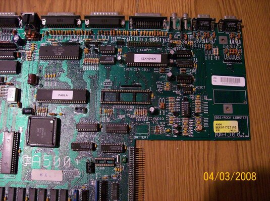

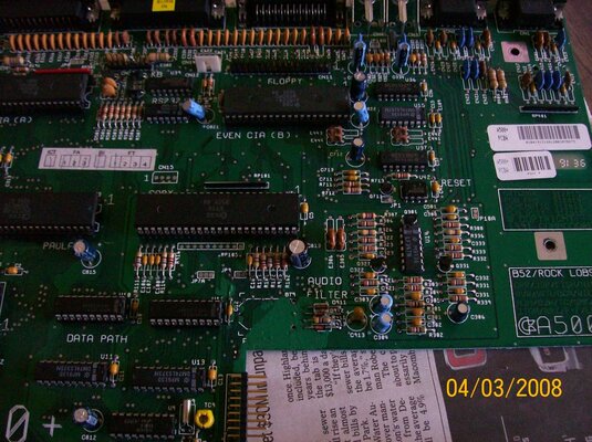

Guys I bought this 500+ Motherboard with a black screen..I had to replace the Denise socket, and the Gary socket too, as they had that green guck in it. I fitted another Denise and Gary chips too (The old ones were in bad state). I had to clean up all the area where the battery was, and soldered in a new socket for the new 74LS244N IC and the 5 resisters below the Gary too (All new). I also re-soldered the 2 diodes and that resister. Now the screen has gone from Black to White. ALL the custom chips have been checked out (CPU too) , so whats causing a white screen now..
Any help would be greatly appreciated, as I have never been able to bring a 500+ (Black screen) back to life yet (I have another one with NO corrosion at the battery. But black screen)

Hmmmm, well, as you are no longer getting a black screen the CPU and Kickstart ROM should both be initialising correctly.... hmmmm, when you first power on the power LED will be half brightness and after a second or so should change to full brightness - does this happen? If not it could be a faulty CIA (which can cause the system to halt at the white screen).
James. Thanks for your reply. Though I don't have the keyboard connected, so But I'll do that to see the LED, as for the CIA chips I have lots, so I tried some of them and still a white screen.. But could there still be a problem around the battery area, to cause the system to halt at the white screen...
Update. I plugged in the keyboard and now a black screen and both LED's just barely lite up (Together).....That's weird eh???
Very weird, seems to point more to a short than to a faulty custom chip. When you unplug the keyboard again does it go back to the white screen on powering up?
Yep removing the keyboard. The board goes back to a white screen...

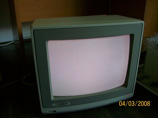

Update. Silly me LOL. I had the keyboard plugged in backwards. The Power Led is now bright, and the screen is still white... Though the caps lock led is working.... but no kick-start showing up....

Guys I beeped all the connections from the five resisters and the cap plus the viols too, and all the tracks checked out fine (Not broken), so I tried all eight of my CIA's (I don't think they are all faulty). But still the board gives me a white screen (The caps lock LED is working, and the power LED is bright too), so I'm now at a loss to what's wrong with this bloody board, after doing all this work to get it working again, so to what more can I do.. Does anyway know what else would cause the board to halt at a white screen...
Update Guys. I changed the ROM from 1.3 to 2.04. Now the screen goes from black to very light purple, and keeps switching back and forth ARRRR!!!!!!
sounds like a cpu exception error if it gets to the final stage and reboots ??? according to google.
copy paste from here
it looks like from what you describe anywhere from 14 to 21
as this is a 500+ check the connections from U10,U11,U12,U13 and the Gary chip

Thanks for the link. Though the board reboots, or resets before it gets to the dark purple screen..
Update: I connected the keyboard and the power LED is blinking (It stops at the reset) and back to blinking at the very light purple screen....
Oh Caps lock LED is not working when the power LED is Blinking....
