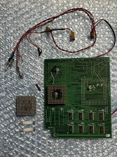

We have 68060 adapters for 68040 socket, why don't we have a 68040 adapter for 68030 socked? Seems to be technically possible as per below. Is anyone working on one perhaps? I can see serious interest from the Amiga community in this option for their 030 cards, as long as the orientation fit in 500/2000 for starters.
Came across this little 68030 to 68040 adapter thing for I think X68030....
Seemed to be for something specific, but it exists. Immediate thought of all the 68030 that would be replaced by this in an Amiga.
Searched the subject quickly and found this:

How awesome would such a thing be? And it was clearly done and worked as a finished product already and even Motorola thought about it...it appears. Hmmmm...I wish I had the skills!
EDIT: ....and here it is! I wonder what the connections are all about. At first glace looks like power plus perhaps a by-pass and indicator. Meaning, this board looks all fully self contained "plug-n-play" type of device.
X68030 040turbo MPUアクセラレーター - Yahoo!オークション
X68030用 040turbo MPUアクセラレーター です。動作品から外しました。LEDケーブルは再結線お願いします。取り付け等のサポートは出来ません。
