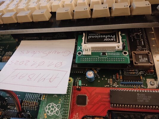

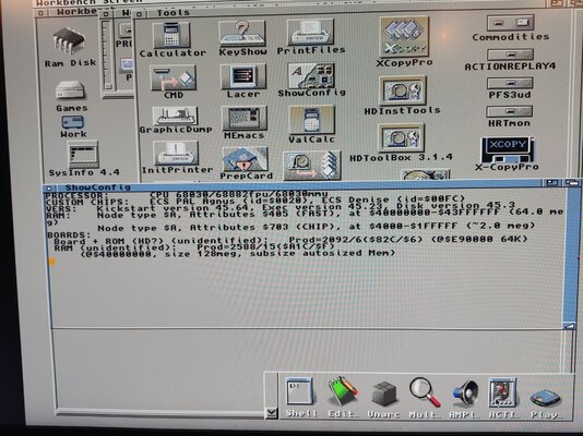

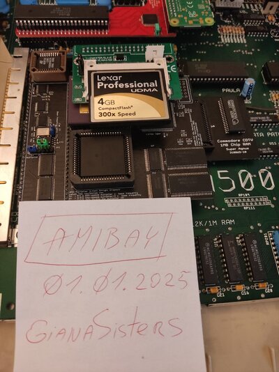

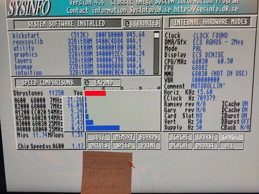

For sale a very nice accelerator for A500.
- almost 12 MIPS on 60MHz
- also works on 30, 40, 50 MHz
- FPU
- 64MB Fast Ram
- Octagon IDE Controller (works even with KS1.3)
- black PCB
- no relocator required to close amiga 500
Price for a set with CF adapter and fast card ready to boot Amiga: 210 EUR + shipping
set from my private collection

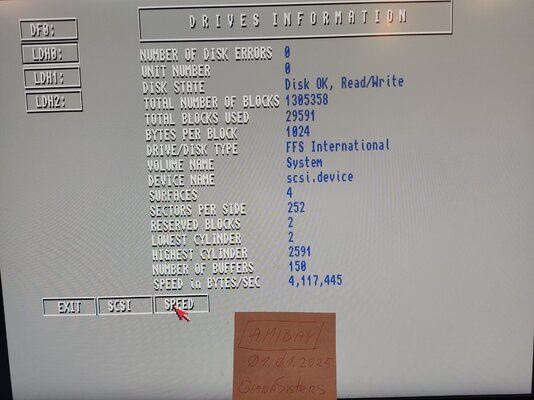

Hello, how fast is the IDE (Sysinfo Drive speed screenshot, please).
How can the processor speed be adjusted?
The entire CPU + FPU clocking setup is set using jumpers.
You can run the FPU at half the CPU clock speed, or at full clock speed.
The data bus can also be run at 7 or 10MHz
Of course, it's not like every bus will run with every multiplier/divider, etc. But the sold copy works at 40, 50, and 60MHz
I'm attaching a test screen for a system partition formatted with FFS.
