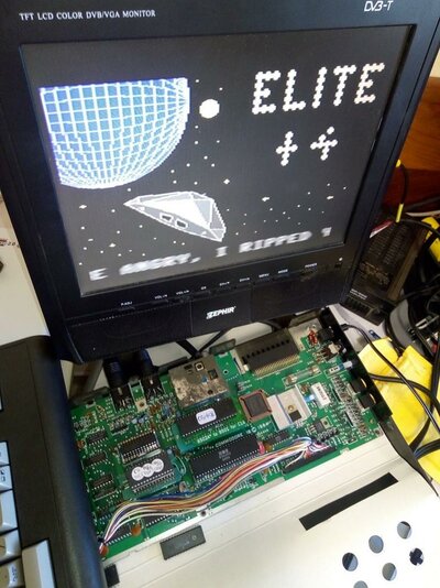

Tested also with "metamerism", "pets rescue",2 versions of "Elite","krill's loader", jiffydos, ......

1- This new solution works good for example with Elite+4, Total Eclipse II, Sgt Helmet, Zombi, Gunfright, Knight Lore, Head Over Heels, Hazian Demo, Zennit Demo, Dream Time 2K17 and 2k18 demo ?
Read the starting post: there is no reasons for sw incompatibilities, also the illegal opcode is well executed.
I found 2 versions of "Elite", both of them work (see new pics into starting post), if you want that I test it with another pair of sw please PM me a link for downloading them.
