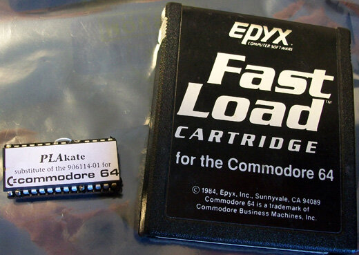

Yes, the photo was just the first random picture that came up when I typed "C64 PLA EPROM" into google, which is why I said it looks "something like this".
Actually, that was some guy trying to insult me on Lemon64 who posted this to give the idea that my PROM based PLA subs are junk stuff.
I'm not sure what brand EPROM I used, but it's most likely quite an old one as I have a considerable stock of 27C512 (mostly from ST I think) that definitely aren't new. I have heard that there can be problems with the EPROM solution, but I very much doubt that the instability could cause damage to any other part of the C64...
I concur with you there. Groepaz and Jens Schönfeld have been beating the "bus contention" drum ever since I've been selling PLAkate (the predecessor to PLAnkton). (E)PROMs which generate glitches can cause the 64 to malfunction, especially with various cartridges but I have never seen any damage occur as a result.

Mine looks more like this:

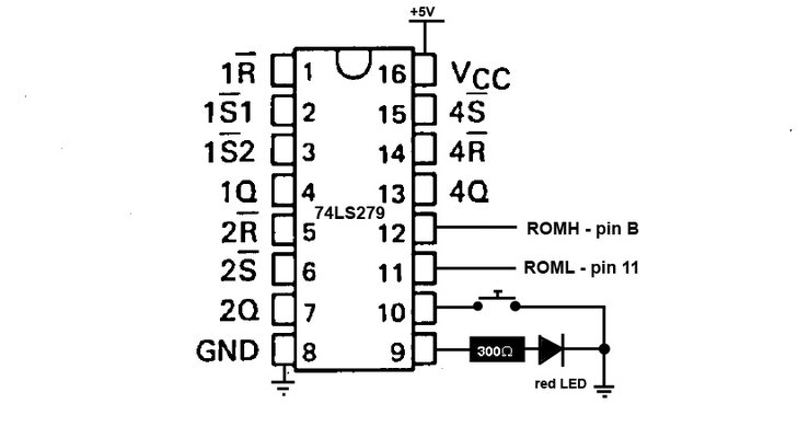

If you don't have Super Zaxxon, FastLoad may be a form of test and I suggested this circuit to Ray Carlsen:
The button is supposed to turn off the LED - if you have a problematic PLA, it will always switch back on.
