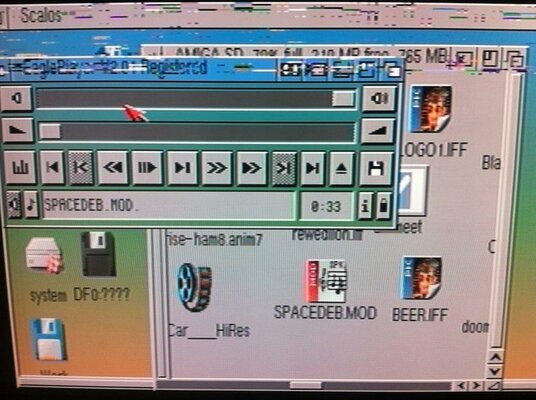

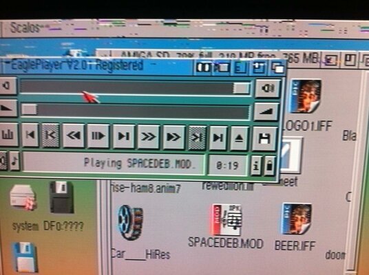

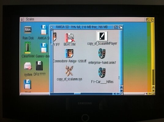

I have a 1d1 motherboard that has graphic issues when playing sound. It works perfectly until sound is accessed , mods or whatever.
The screen gets horizontal lines that slowly work down the screen and then reboots or guru's.
The sound is played but so faint it can hardly be heard on full volume.
Caps were replaced a couple of months ago.
I have resoldered Paula and local ic's , I will replace the audio caps again.
Any other ideas?

do these artifacts disappear when you move a window past the area where they appear? (of course they will appear again shortly then)..
Just a wild guess but it's probably some bad chip ram since both paula and lisa use this RAM.
Oh, all the girls that's in the Amigas i don't need my lady anymore i have plenty right here :)
hello,
yes they disappear if you move over them but come back again.

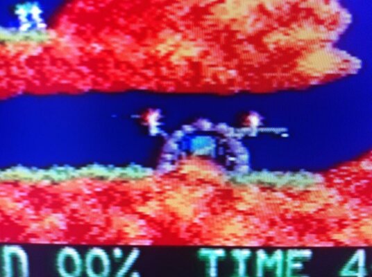

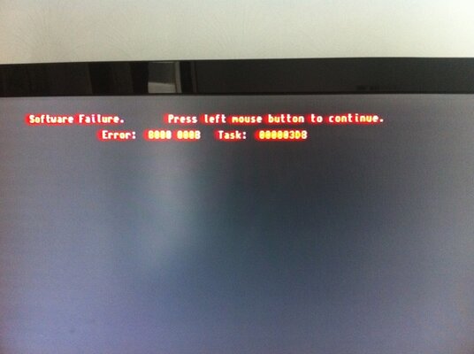

small update.
i have recapped the whole board again and resoldered all the large IC's on the board, cup, ram, paula,lisa,cia's etc
and I've changed the sound amp too.
now i have sound that is loud but very bass(y) and thick but at leasts its sound.
i will have to examine the whole sound circuit and replace bits as i go ...
i am still getting screen corruption but not as much and as i have sound now. I'm using polarised caps on the audio but this should not make any difference really. a short you tube vid showing the thick sound being produced.
sounds horrible but its a step up from having the volume on full on the TV and just being able to hear it.
test setup:
a1200 1D1
0 fast ram
2 mb chip
no accelerator
booting from floppy
test games : lemmings / turrican / cover disks
