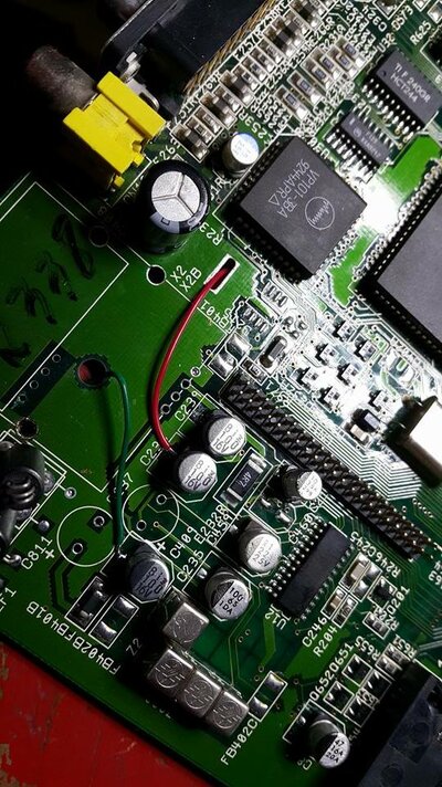

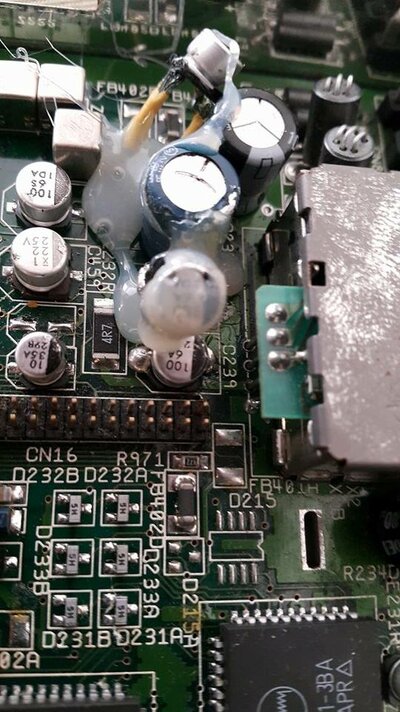

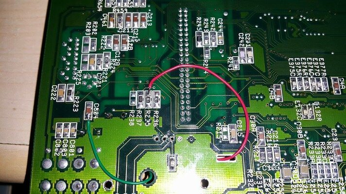

I lifted the top shield (it was shipped complete with top and bottom shield) and stepped back in shock and awe at the spider's nest under there... OMW! This is the worst cap job I've ever seen (I'm not an electrician - I'm talking about images on the web)
Here it is... please revel in its awesomeness:

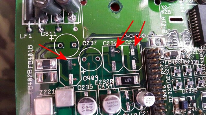

The cap on the yellow stalks is only soldered successfully(!) on one side. The other actually has melted plastic shielding holding it on, the wires brushing against the cap terminal.
Is there a record book for the worst 'fixes' ever? This one is surely up there, isn't it?
Anyway, I cleaned it off best I could. Underneath is perhaps the reason for the stalks... 2 1/2 solder pads were missing. In fact, there are gouge marks next to the pads and it looks like someone removed the old caps with a screwdriver, lifting them and the pads.
Unfortunately, it's the worst pads to go... there are no tracks ontop of the board I can bridge them to.

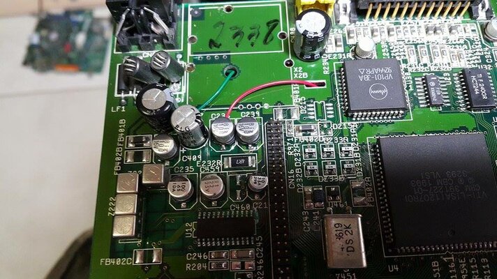

Best I could make out from the remaining via's, I've taken one terminal each of the two the caps to the back of the board as such:
C409 -ve terminal onto C804 (looks like ground side?)
C263 -ve terminal onto R235 (via comes out on the 3 of R235)
(I don't know if it was the right thing to do, but I epoxied those two smd's - on the padless ends - to the board)

Are my modifications Ok or did I gimp it?
I still don't have any video.
I've probed (with 22uF cap inline to telly input) pin 20, and the telly almost wants to show something (no signal goes away), but it's just blankness.
(If I do this on my old, audioless board, I get a picture)
Is it possible U12 is damaged?

As I remember If you fit C237 (470uF) you should have composite out too. These 100uF caps are not required if there is no modulator.
You are 100% right. Seems like only C237 is required for the composite (It is there - middle pic is before I put it back). I can remove all the 100uF's (C239 and C236 and C235).
I don't know what C409 is for... that's the other 100uF cap I 'patched' with the green wire.
Ok... found C409 on the video decoupling.
And I have it connected to the ground side of C804 which is drawn on the power input circuit. So that looks ok.

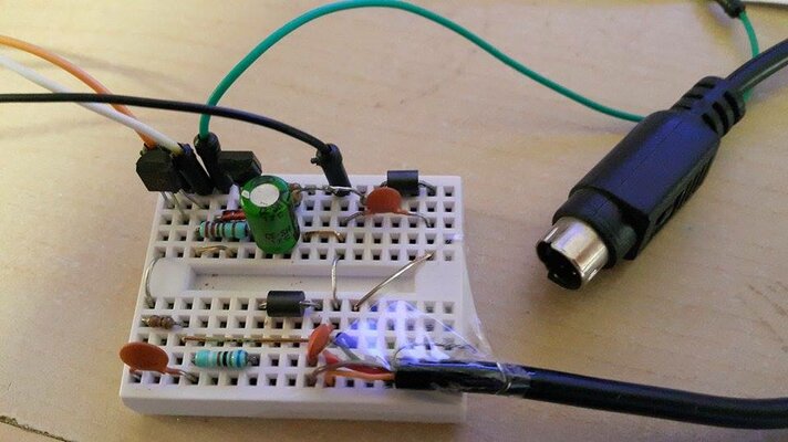

Hey guys, here's some feedback. The A520 is still about 2 weeks out, but I decided to give the s-video mod a stab.
It took me a few days to scavenge all the parts from old circuit boards (luckily I have quite a few). So, with zero cost, (except the project board) here's what I ended up with:
Which I soldered directly onto pins 15,16, 19 and 24 of U12.

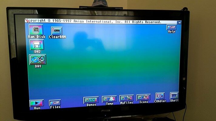

And that gave me this...
and plenty happiness.
So I think it's safe to say problem found... U12 is kaput. I'll be ordering a new CXA1145 as soon as I find one with delivery cost less than US$41 !!!

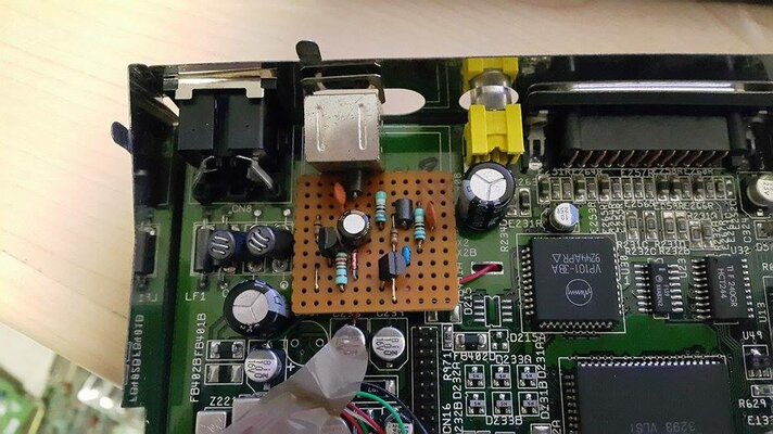

The picture is so much better than composite. I'll def be looking at soldering this circuit onto some veroboard and putting it permanently with a s-video out socket into where the rf modulator was.
PS... when I first switched on, I could not get signal. I checked and double-checked and was just about to tear everything apart and pack it in, when I had a brain fart to swap the wires on the s-video out. Bam! Picture. The pinouts on a socket are of course mirrored! Doh.

Here's where I am with the veroboard version. Not necessarily going in this spot - it's just for scale. I'll prolly remove those compos(h)ite video and rf capacitors (oops, composite one's already gone)... and I think this might well be a permanent fix that I'll leave.
The s-video jack is also not yet mounted. Just there for scale.
The veroboard is finished, but not yet tested... bedtime now. :)
