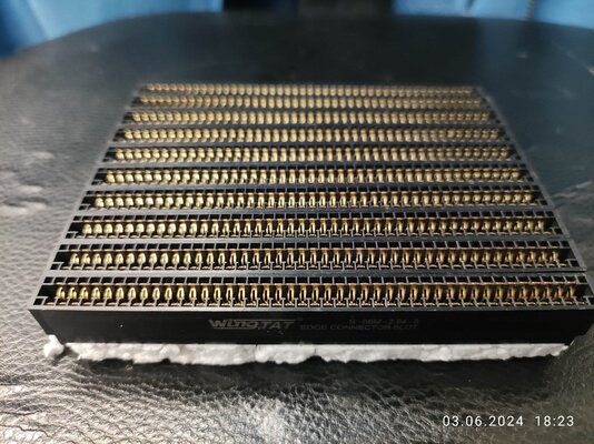

getting these from AliExpress - You can find really great quality connectors there
I found what I thought were the correct ones, ordered them, and they were delivered. They wound up being the exact same model.
WingTat S-86M-2.54-5 Edge Connector Slot
