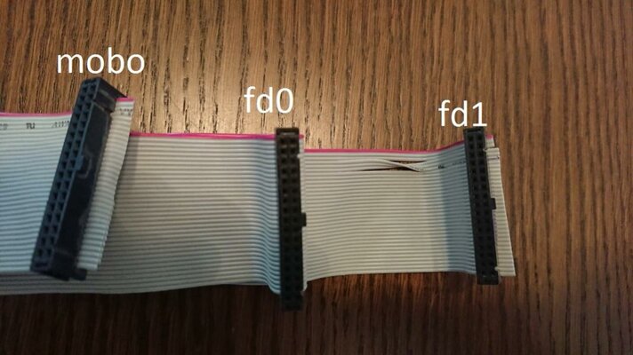

Guys I have a same problem. You see I'm putting a 2000 together. But I've lost the floppy ribbon cable ( Can't find it). Anyone have one that they don't need..
Oh, is it the same as a PC one??
Thanks..
I would only add:
direct connection is for the first drive
second drive can also be connected after twist. But there the twist is little different than on pc cable.
Hi,
I think pc ribbon would't dosen't work.
Below pic with ribbon which I made myself. Works :)
@dallyis - posting auctions is against Amibay rules, just wanted to let You know..
izi - yes, this is correct one
britlord - why don't You asked me - i'm able to crimp You a correct cable and sent it with Megachip...
