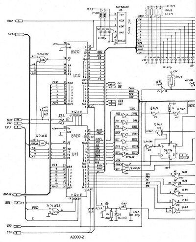

I want to install a bootselector on my A2000 (Rev 4) - but cannot figure out what is the odd 8520 CIA and the even 8520 CIA (the one I want to install the bootselector in). Based on the schematic below, I would say the EVEN CIA is the U11 - solely on the grounds that the U10 is connected to the Keyboard J3.
Can you guys help me out?
I include for reference Amiga Hardware Reference CIA details:
