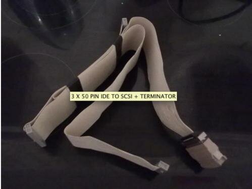

thats right , you need one with two or more connectors on it and away you go..
mine has 3 and a terminator on the last.

the terminator is part of the cable and cannot be removed on mine.
your external cd rom can be trial fitted in side your A2000 if you pop the case off the cd-rom box

yep in theory you probably just need the 50 pin cable as ya cd prob has a jumper for temination, but in practise its much better have a teminated cable as it alows you add other things and just worry about their scsi number
