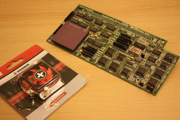

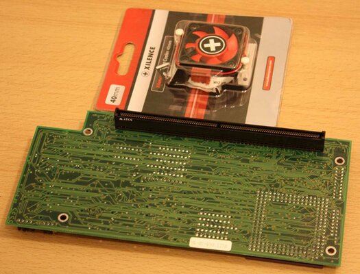

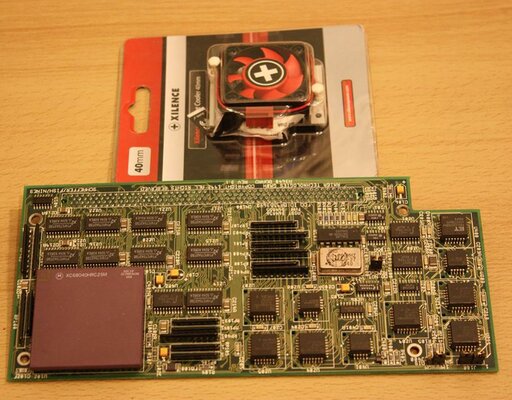

I have for sale a A3640 processor card for A3000-A4000.
It's in good shape and working order. Tested with A4000D, A3000D.
It has a full 68040 CPU with FPU and MMU.
For cooling I'll include a brand new cooler.
Photos about the test will follow ...
http://amiga.resource.cx/exp/a3640
Price is 100 € + Postage + Paypal Fees
