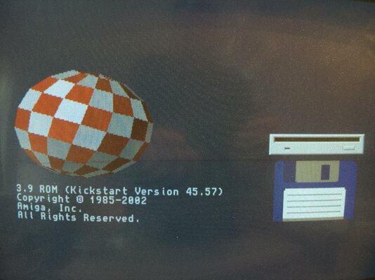

- I also got myself a Romy and created a 3.9 kickstart with a fixed exec lib. Again - no change but a black screen. This kick works fine, and shows the insert-disk image when I boot with the 040 installed without any disks.

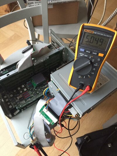

- I checked the 5v power rail of the PSU and it reads fine. I will chance the caps in the PSU but currently I do not think that's causing it...

5v rail:
Kickstart 3.9:

I changed all caps in my PSU as I noticed a 4.5 - 5.05v ripple on the powerline on my scope. However, the a4000 still does not boot with the 060 and adapter. It still boots fine with the 040. So, new caps in the PSU did not change the behaviour.

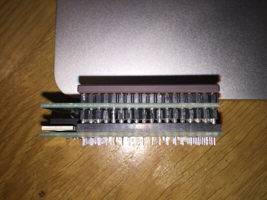

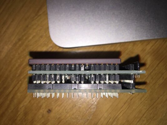

Unfortunately, these are not... they are made with pin strips and the other I have with single precision pins... see pictures below... :(

Maybe a good close picture of the sandwich could be useful....
Thanks for the help... I _think_ it is well inserted, at least it doesn't go any further. I took a picture from both sides.

There you go, as I thought, the usual bad job with the pin strips to save $10-15 not using real CPU sockets.. These are not designed to take/plug into CPU pins/sockets, so there could be a contact problem anywhere on the 3 x 206 pins (sans the NC pins). Perhaps contact the seller and sort it out?
