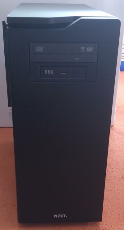

The case is a NZXT H630 Silent Ultra Enthusiast Tower case in Matte Black. In the front I have some generic IDE black DVD burner, I would like to replace this with a more "Black" unit at some point.
Below that I have a BitFenix 5 1/4 to 3 1/2" Drive bay adaptor in "SoftTouch" finish, it's a little flimsy putting it together but with the Black Gotek in it's solid enough when installed and matches the NZXT case pretty well!

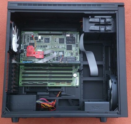

Quite a few mounting holes for the motherboard line up. Just need to drill and tap a few more.
As I don't have any of the modules for the motherboard I have installed an Indivision AGA MK2cr to get video output
and I have just ordered an X-Surf 100 as well as the USB addon so I can use a mouse as well.
I am going back computer shop tomorrow to buy an internal USB hub. Going to use an NZXT IU01 so I can use the two USB2 ports and the SD-Card reader on the case.
I still need to make up a latching circuit to power up and down the system from the case push button.
