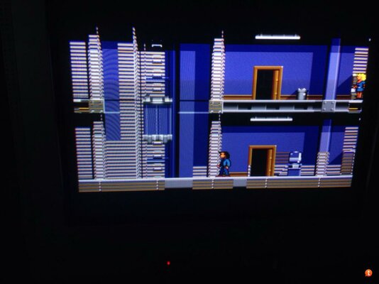

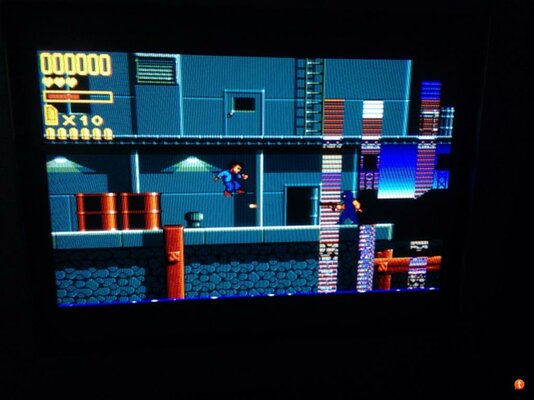

I noticed it in Lethal Weapon in Whdload mostly. Sometimes it can do it in Workbench too.
I also tried Lethal Weapon disk and same problem.
Disconnected 1MB ram expansion
Disconnected A590
Removed Indivision
Removed 68010 and put 68000
Replaced Denise with another one from another 500 Plus
Replaced Kickstart with another one
Replaced one of the CIA's (Left one)
Does not fix the problem.

The glitch seems to show up rarely in Workbench and almost always in Lethal Weapon and it isn't always exactly the same/as much
I would suggest loading this game from floppy as it might be a SLAVE issue.
Also ensure that NOCACH and other options are turned off - I would even suggest trying to load it without PRELOAD but I believe thats all default now.
If you are still having a problem then I would humbly suggest cleaning the Agnus socket and if that doesn't alleviate the issue it might be a good time to replace the capacitors - should that still not yield satisfactory results then its time to replace the CHIP RAM.
It's very clean and I had removed the battery at the very beginning of leak. Motherboard looks undamaged. I'll try cleaning the 8375 socket first as you said.
I had a similar problem with a late ECS A500, turned out to be a dodgy Agnus chip in the end.
I'd run a memory test to see if chip ram is good or not. Those glitches look like memory read errors which could happen either in the RAM chips, Agnus or other interface ICs.
Well I can try the Agnus from a damaged 500 plus I have and run a mem test using the A590 disk. Will post back
---------- Post added at 19:56 ---------- Previous post was at 19:48 ----------
Agnus!!! Thanks :)
