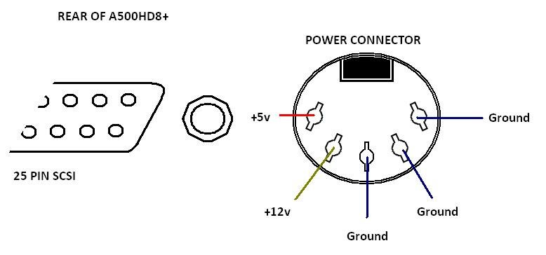

I thought I'd ask here if anybody is absolutely certain that this pinout for the A530 is correct.
http://amigahardware.mariomisic.de/cgi-bin/showhardware_en.cgi?HARDID=1194
Looking at the back of the unit:
===1=====3
====4===5
======2
1 Earth Ground
2 Signal Ground (5V ground)
3 +5V RED
4 WHITE (not connected)
5 +12V BROWN
The reason why I'm asking, is that I have won an A530 on Evilbay, I didn’t expect to win and I didn't at first, but I got an offer again after the first buyer failed to come trough I guess.
But this has a US power supply, which is of course 110 volt.
And as I am in Europe where it's 230 volts, I need to modify it with an ATX PSU I guess.
I'm also hearing that the HD8+ power supply is the same, is that also correct ?
Also reports of CD32/A590 power supplies, but if I look at these including the Amigakit convertor, it has 4 pins instead of 5 and 12 volt and ground are in opposites.
Best thing would be if someone had a european A530/HD8 power supply for sale, but I can't imagine someone would have this laying on the shelf.

I will have a look into this a bit later tongnight - to be honest this is quite a simple retro-fit/conversion - it just looks difficult
I have a HD8+ here that I beleive has exactly the same pintout - anyway for starters you can easily buzz-out the pins on the back from the 4pin molex to find +5 / +12 and Ground
There wont be a [-12v] or [Earth] connected in the above circuit - from what I could see from the PCB's on amiga.resurce.cx or amiga-hardware.com - these voltages are also not used in the HD8+ either.
I would suggest you power BOTH the GVP and A500 from the SAME power supply - its easy to modify an ATX psu for this and the connectors are available (either from Amiga Maniac or a 5 minute eBay search)
if you need any help or more info for ATX conversion just shout =)

I was told that the HD8 and A530 share the same powersupply yeah.
So if you could double check on the pinout than I will modify an ATX powersupply and yank off a power connector from an old and battered A500 power supply :D
If that works I'll drop my US version off to SkydivinGirl.

Just buzzed out the GVP A500HD8+
I believe that this is correct, but please always double check with another source.
(see attached)
(see attached)
That is quite different from the pinout that I had from that German site also saying that is HD8.
Hmm, I'm going to test the PSU with a 110V adapter to see what is on what cause I can see this going horribly wrong.

@BuzzFuzz
I dont blame you, and I encourage you to do your own investigation.
the above pinout is my A500 HD8+
I took the board out of the unit and used the traces to buzz out +5, +12 and Ground.
Its best I share the info that GROUND is run through the metal chassis via the mount points.

@BuzzFuzz
Well your drawing is correct if you view from the back of the A530 unit, it is indeed the first pin 5 volts and the second 12 volts.
So on the connector of the psu it's the first pin on the right and then the second anti clockwise.
The unit I got is 100-250 volts and 47-63 hz, so no problem.

Yes, and also a 1541 II PSU could do it.
The standard din connector is easy to get and like Heather said, you could also do a full ATX conversion.
But clear as day that Zetro's drawing is correct.
So start modding :D
The unit is working great, only thing is the loose power led, but that's an easy fix.
