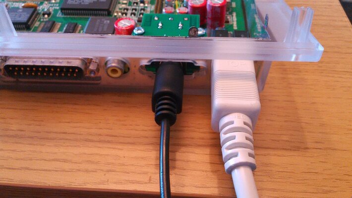

It fits in the space freed up by removing the RF modulator, and mounts on the board by screwing into mounting holes for the modulator, providing an S-Video socket at the rear of the case:

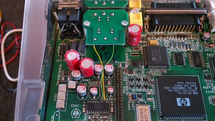

I have a few of these adaptors available in kit form. Fine soldering will be required, but if you've fitted the encoder upgrade kit, this won't be any problem. Three connections are needed as shown in the photo - Chroma to pin 15 of the encoder, Luma to pin 16, and Ground to any ground point (a handy one is the 4th pin of the PAL modulator connection, as shown in the photo). Unfortunately there's currently nowhere else to obtain the Chroma and Luma signals other than directly from the chip pins.
Please be aware that these adaptors will *not* work with the original CXA1145 video encoder - more elaborate circuits are required for that. This adaptor is intended ONLY for use with the CXA1645 video encoder chip, so there's no point in buying this kit unless you also do the encoder upgrade!

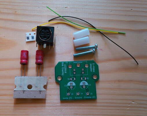

The kit contains the PCB, two capacitors, two SMT resistors, the socket, and the wires, screws and spacers needed to fit it. Note that the S-Video connector is a tight fit for the modulator opening in the new Kickstarter A1200 cases, but it does fit with a little persuasion (as seen in the photos). The original case's RF modulator opening has more clearance and so is an easier fit.
