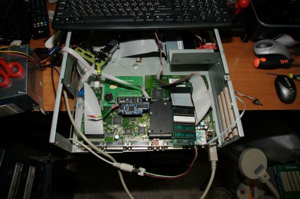

Well, finally I come back at home and decide to start one of my projects.
Time a go I'm planning to start my project with one Slim PC-Desktop case, but this case don't have room for all the peripheals I want to install.
So, I decide to use my spare A4000D case. Yes, is not slim :D but have room to install all I need :D
Components:
- A4000D case
- A600 mobo
- A603 2MB Chip/RTC
- ACA 630/25 32MB
- Indivision ECS
- Mikronik 3 ROM Switcher, 1.3 & 3.1
- Elbox PC-Key 600
- Mouse/Joystick => USB/PS2 Adapter
- Floppy 3.5 DD as DF0
- Buffered IDE splitter
- IDE-CF Adapter as HDD
- IDE DVD-RW
- Modified ATX PSU

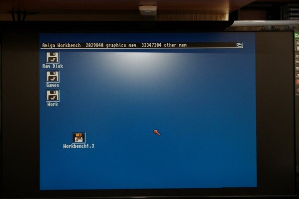

A few pics of this "monster" :D completely dismounted. Just to test if everything works.
Works! :thumbsup:
Now is time to start design & Dremel jobs.

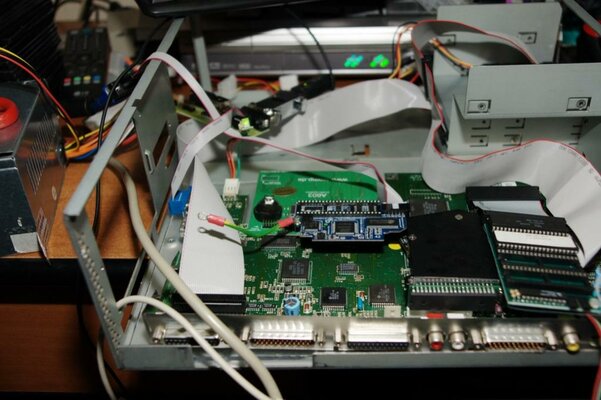

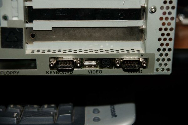

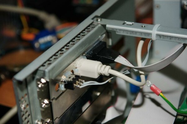

Hi again
A little update.... :)

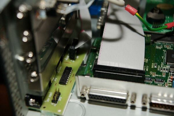

Time a go I bought a little but powerfull PCB to adapt the Amiga Mouse and Joystick ports. With this board I can use Standard/PS2/USB M&J. In my case I want to use a USB Mouse and Standard Joystick (Competition Pro).

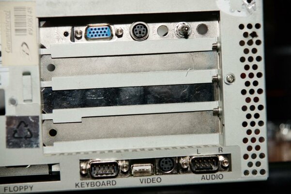

In the upper side I installed the outs (left to right) for VGA, PS2 Keyboard and ROM Switcher.

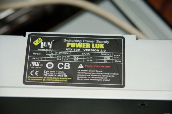

Looking on my Desk I found a little ATX PSU, also I have a power cable Amiga terminated. But I need help to know wich wires I need to cut & solder. Any help will be appreciated. :bowdown:
More pics soon :D
As I said.... Any help/idea will be very much appreciated :bowdown::bowdown:

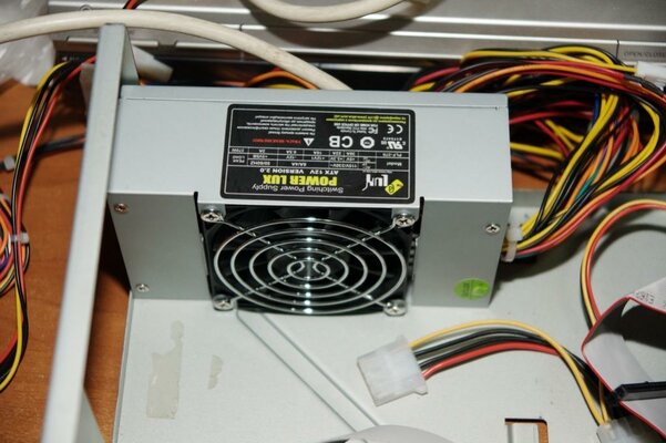

More updates..... :D
mATX PSU modded also with one off/on switch to put in the front pannel.
After installed in the case i will publish more pics.

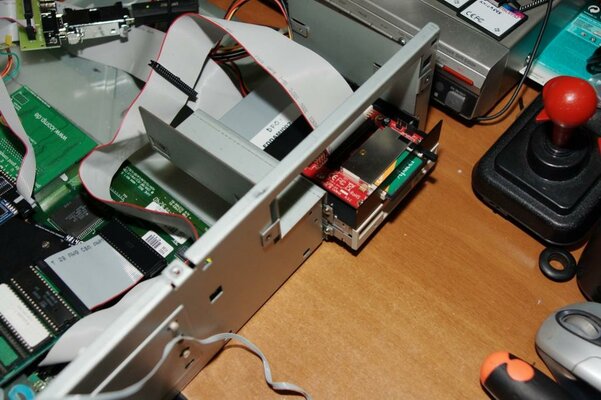

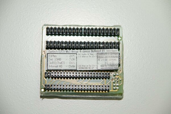

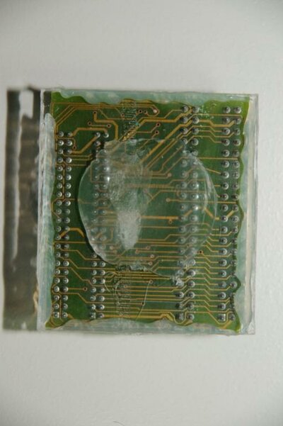

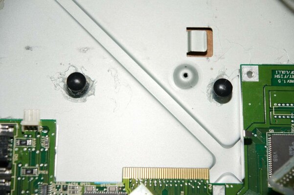

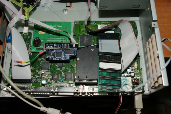

I made a better isolation for the IDE Buffered interface and installed in the case, also notice the way of the power cable:

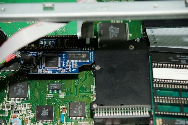

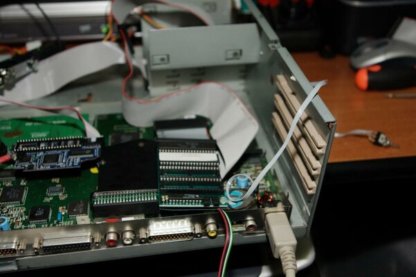

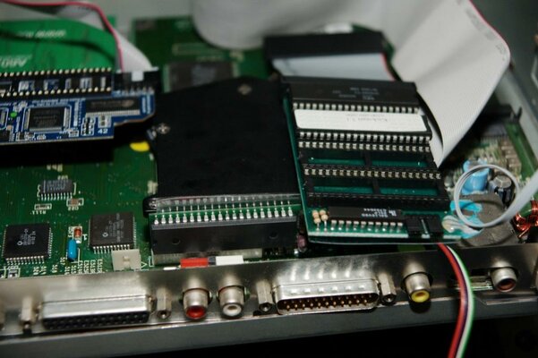

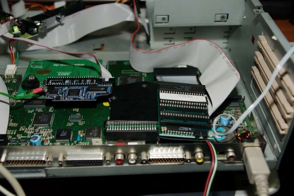

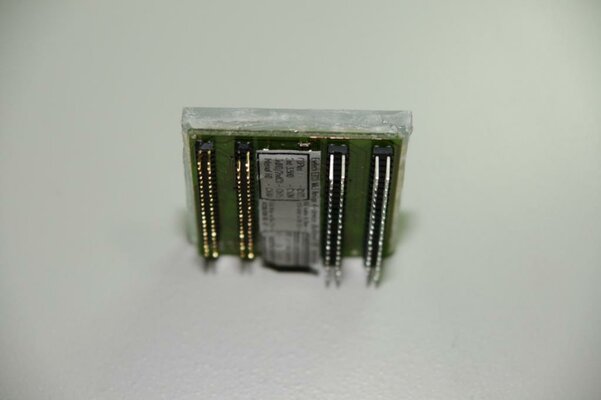

For IndivisionECS I used two sockets. No ACA630 & IndiECS fits fine:

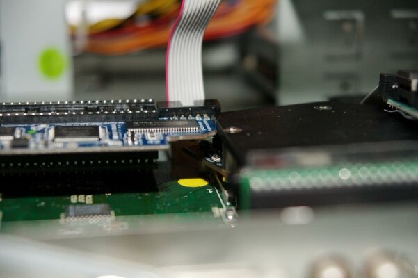

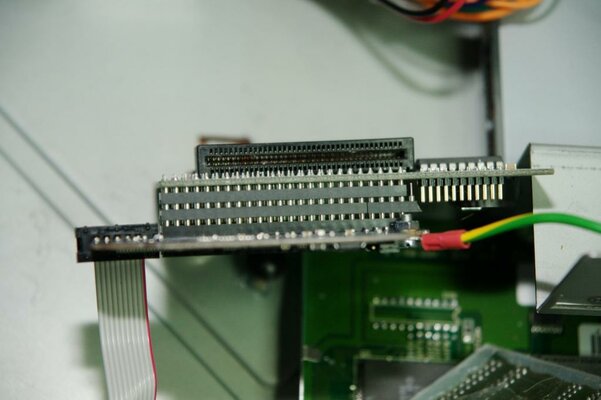

Mikronik ROM Switcher... I needed to made to spacers to separate from ACA630 (I read about heat of this board):

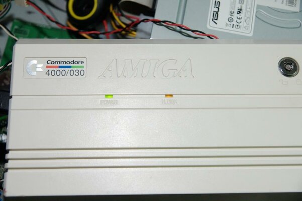

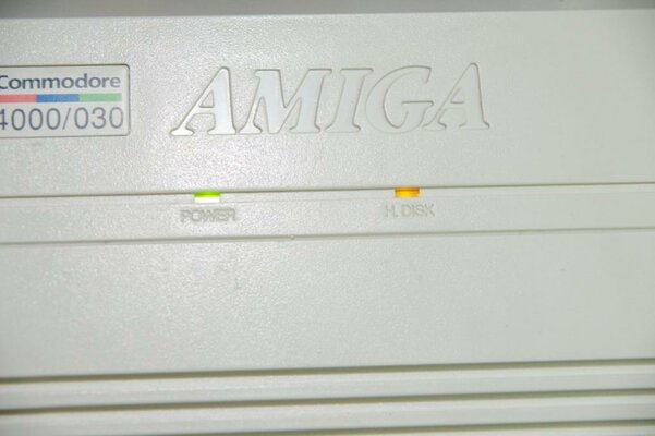

More....... :D

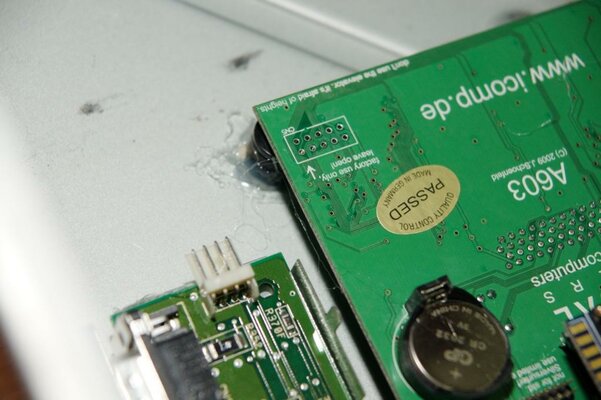

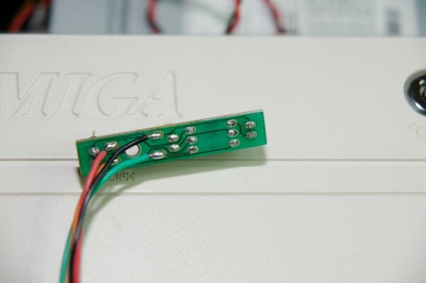

The leds.... a "big" problem...... with a simple solution:
The ACA603 is dancing a bit. So, more spacers to fix....
