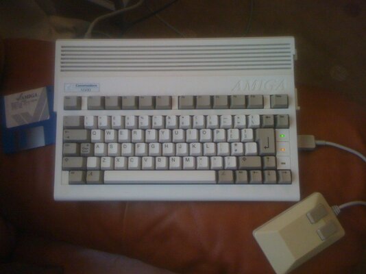

A600 (A300 Board from Taj) (A600 case from Pinkstabbyone)
The A300 (june bug)

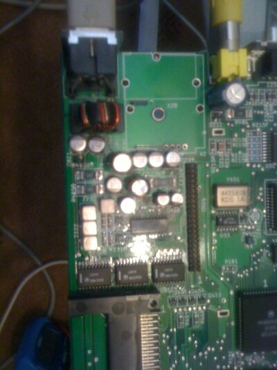

Faults - Leaking SMD caps / Grey screen for 2 to 3 mins / slow floppy read / slow machine speed.
Fault finding..
Well the caps were leaking, some not bad but some had leaked in a 20mm area from the cap..so replace the caps with a miniature hot air (butane) torch - kind of like a pencil sized torch thingy.
So heat the caps one by one - all the same size and type first , just so i didnt get mixed up
After this i cleaned the pads and re fluxed adn soldered a little to shine the pad up and make it look pretty. Too much heat will lift a pad so be quick!.
Okay after 20 mins or so all caps are changed except 2 (Audio) buggers to get at - i may do them later.

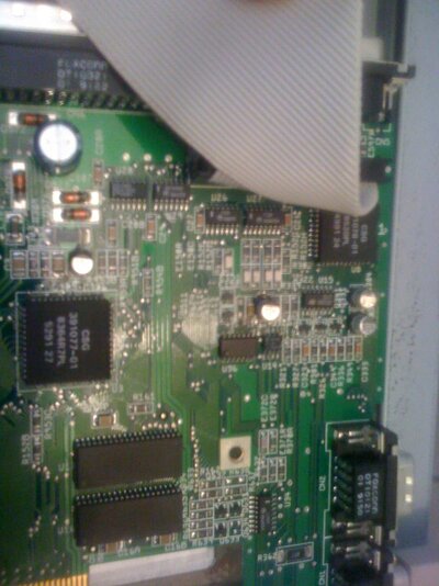

okay further examination reveals that the CIA IC's can cause problems..so lets take a peek - no damage , no solder breaks?
Lets re solder the CIA soldered legs anyway ..a tiny drop of flux and a tiny bit of solder on each leg...10 mins later

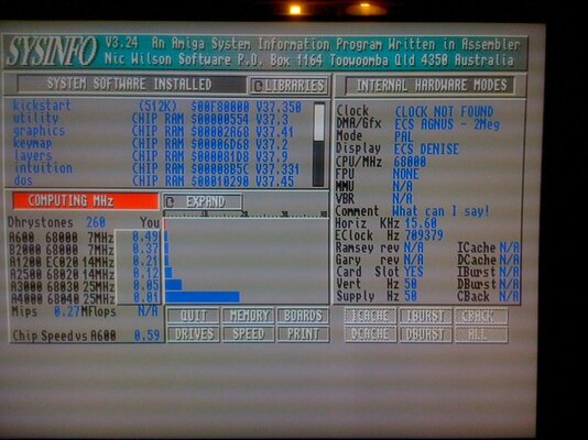

TEST TIME 2 ...power on!
mmm grey screen but only for 20 secs or so then the ROM and floppy logo appear ...so we are getting better but the animation is slow and jerky.

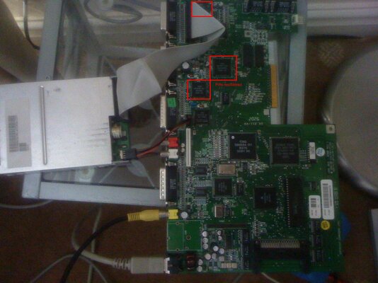

So i re soldered the pins on some more IC's , washed the board in warm soapy water to remove any flux or solder drops etc..
leave to dry , blow dry with compressor and i placed it in a warm (not hot) oven for half an hour.

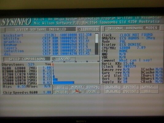

test time - sysinfo shows full speed !! and my A1000 demo disk shows the Amiga logo spinning without hesitation unlike yesterday!
So all in all a job well done.
