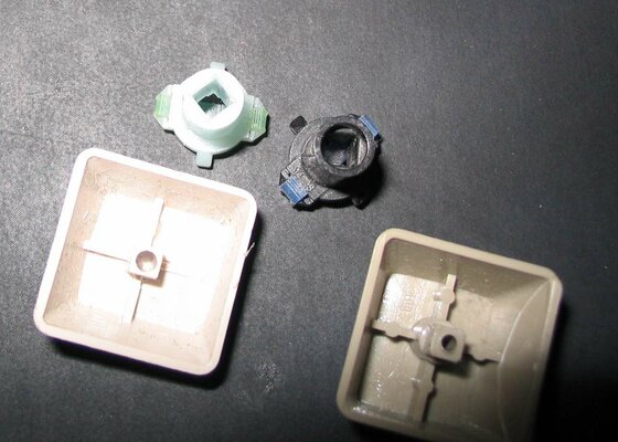

@Craig
Pretty much what rkauer said in case it's a Mitsumi, just beware of the two different Mitsumi designs (photo).
Keys from big box Amiga keyboards are typically like the leftmost design (lighter colours) and have a single square shape for the sleeve + stem.
Keys from other Amigas are typically like the rightmost design (darker colours) with half of the sleeve/stem in round form and the other half in square.
So in short your best bet is an A1200 keyboard.
