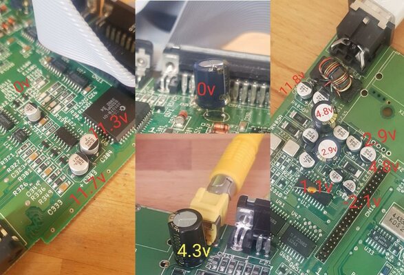

Has anyone every come across this before? Got this A600 about a month ago, tried it few days ago with RF and got purple tint to the image. Bought a RGB scart adapter then noticed i can't use it with TV (no scart), so then tried composite and got same purple image but slightly better than RF.
So i've spent the last day recapping this Amiga and i've plugged in composite leads, attached floppy drive and powered it on. Nothing but a white screen. No clicking from the floppy drive just white screen.
Since it was working before the recap has anyone come across this before and can point me in the right direction? I'd rather attempt to sort it myself before sending it off to someone to look at.
Cheers

Thanks for that info. Before i recapped it, it was just booting normal into KS screen with purple tint (prob dying cap) and playing games fine.
So i'm suspecting something has gone wrong with my soldering. I did use hot air to remove most of the caps and solder wick then eventually hot air for the through hole caps. I covered everything with capton tape so happy i didn't knock anyother SMD off its place.
Just wondering if there is a way to test how well each cap is soldered onto the board, with a multimeter or similar. Also which caps or group of caps would affect the CPU, possibly on right hand side closest to the floppy drive?

Pictures of the board (close up ideally) could help identify the issue

You should be able to measure the 5V / 12V rails across the pins of the capacitors you just changed. Also check that you didn't accidentally install any of the caps the wrong way around.

So i whacked the meter on and got these readings, good sign is looks like some aren't making contact so hopefully just a resolder. The through hole cap top middle pic i couldn't get the old cap leg out so i snipped it, then soldered new cap to its leg but i'm not getting anything from that so will likely have to get hot air and long nose pliers to gentle pull out the old leg.
Some of the caps closest to the PSU input i couldn't get a reading on cos they were so close together. I'll give it another bash soon since i've just packed away all my soldering gear and wife needs a day or so with a tidy house lol
Is hot air an option to solder some of these caps on or is it best to use a thin tip iron?
Thanks for your input so far guys appreciate it!
Hot air isnt a good idea for soldering the caps in (if youre using standard electrolytic caps). They can overheat and explode (well they go pop really, not an impressive explosion)
Some of the caps need to be resoldered. take your time, make sure theyre all making a solid connection. Use plenty of flux and go slowly.
For the surface mount caps, just try moving them from side to side gently. If theyre not on properly they'll tilt right away. (Dont apply too much pressure, you could pull some pads if you do)
Managed to get it working, just had to resolder some caps. I taped needles to the end of each probe to get into the tight spaces to measure the voltage.
