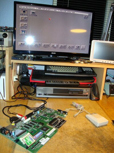

A600 Repaired
A600 Repaired

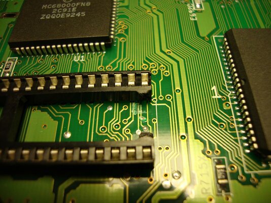

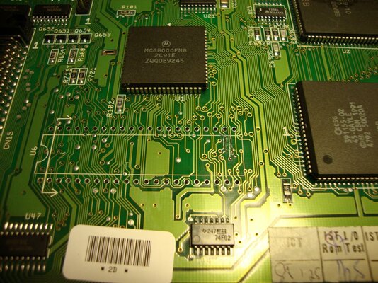

A Few photos of the work carried out to repair this A600, the broken tracks were hidden underneath the plastic strut of the IC socket but easily seen when cut away.
Unfortunately the tracks on the motherboard were broken during removal of the original kickstart as the screwdriver was inserted between board and socket and not socket and chip....easily done.
System works fine with A604 and workshop A608...
Tomorrow I will recap the board
Bas :)

Thanks Bas, you are a star. Entirely my fault then - good job I sent it to a professional!

All done - very high quality work and everything is working fine! Many thanks.
