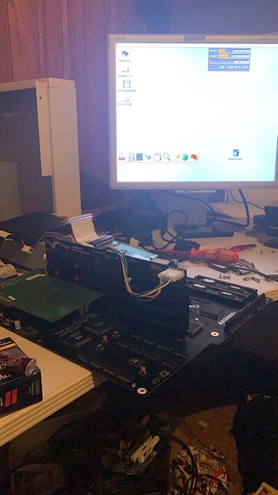

Great work! What a nice design!
As an owner of an "original" AA3000 I can give you some hints:
The blank-signal for the videoconnector is unconnected on the original AA3000-MoBo. Check the A4000 schematic to do the same "conversion" of the Blank-Signal to Lisa with the Videoport.
It seems that you integrated an upgraded version of the Multivision Flickerfixer. This Flickerfixer suffers from three issues: It can handle only PAL modes, it uses a discrete DAC to get RGB and the original schematic uses this ugly NE564-PLL loop, which needs tuning. I used the same flickerfixer as a starting point for my one . I fixed the PAL/NTSC-Mode issue by using a "modern" CPLD. The DAC issue was handled by using the same ADV7120 (or BT101) allready populated on the Mobo. Nice side effect: It makes the 74xxx574-buffers unneccessary (U478/479). I replaced the NE564 by a ICS570-frequency multiplier, which gives exelent clock signals.
Think about an internal SCSI-termination-option. An external one is ugly ;)
Have you done the Adress fix on the Prometheus-PCI? On the Prometheus PCI-schematics X302-A26 is connected to P-AD19 but should be connected to P-AD18. Same with X303-A26: P-AD20 should be P-AD19 !
I see that you used the Altera-Design. I would recomend the Xilinx-Design. The CPLDs are much better available.
A Point of load (POL) module for 3.3v conversion is better than this simple 3.3V regulator. If you connect the 3.3v rail to the PCI-Slots you will need a LOT of power!
I see you missed out the "slot" for this s-shaped fixation of the Daughterboard to the case. This is quite importaint to avoid damage due to inserting and removing cards.
Are you on signal ir irc for some dev-chat?
Best regards Matthias

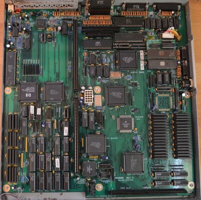

There will not be any A3000 board harvested, because there are not A3000 chips used in the AA3000+. The board is based on AGA chipset, you can buy them NOS, and some common (but old) chips: SCSI controller, RAM, 68030. Also SuperBuster is easy to get, because Commodore produced and sold a lot as an upgrade for A4000.

mattsoft said:
Curious about what case it fits in (3000?)
Yes, this is a drop-in replacement motherboard for the A3000.
Fook42 said:
- the original-mountings can not be used? i mean the small little plastic holders
- why was the power-connector placed on the right corner? .. the cables from the original powersupply are not that long
The two outermost mountings can be used. The middle one can't be used, it had to go.
You can use extension power cord to power the daughterboard. I can relocate the power connector elsewhere on a later revision.

MatthiasH said:
It seems that you integrated an upgraded version of the Multivision Flickerfixer. I used the same flickerfixer as a starting point for my one.
Yes, I'm aware of your flickerfixer. The AA3000+ schematics were finished on November 2018 after which I began routing the board. Your flickerfixer was published later, on May 2019? I may use your design on a later revision.
I'm aware of the Xilinx version but I'm waiting for someone to assemble such board and confirm that it works. And is the new Prometheus library available somewhere, because the new Xilinx version does not work with the original Prometheus library?
No fix needed. That address problem is with the new Prometheus design, the original one which this bases on, had no such problem.
I haven't missed it, that was a mandatory sacrifice. I wouldn't been able to fit the Altera chips on the board otherwise. When the Xilinx version has been confirmed working, I'll respin the daughterboard with the Xilinx chips and then there is room for the middle fixation block also.
