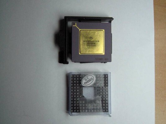

Kipper2k -Brian- member here, was my supplier of a new old stock never used MC030RC50B CPU, plus a new socket for it.
After 10 days I receive his parcel. I must admit that he made amazing packaging.
Thank you Brian.
Ok, lets see some pictures about the whole thing!

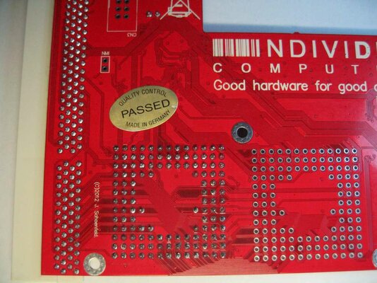

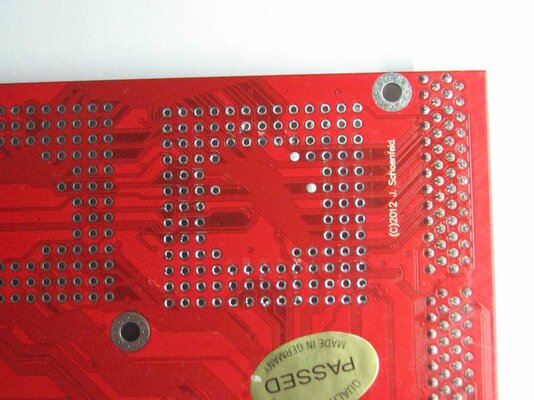

Goods received.
Old plastic CPU desolded from PCB, and gone away for ever.8)

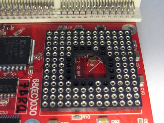

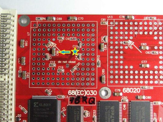

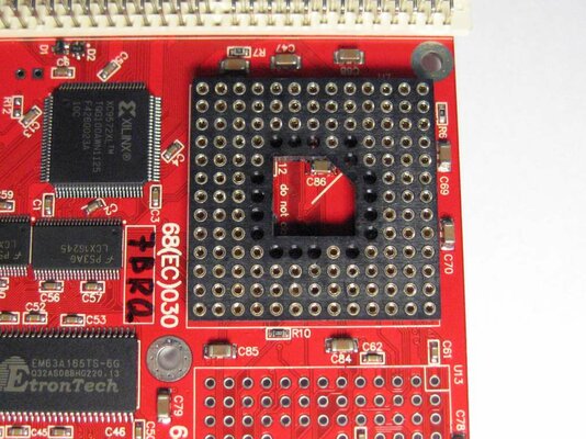

Hmm the first barrier has occurred. C86 marked capacitor, due to its height not let the socket to fit correctly on PCB.
One solution was to resold the cap a little diagonal, but due to the very fine traces around something could short circuit in the future, and after card goes for :soapbox:.

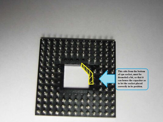

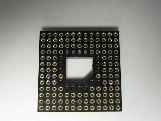

So I decide to dremel the socket a bit from the bottom as to fit perfect!
Here after fitting the socket in place, you can see the cap above in its tomb.
Then was time to solder again all that pins, and clean the residues.

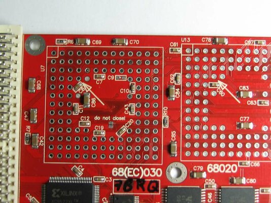

After place the new CPU on its socket and check the proper settings for this scheme.
The stock one has a jumper -0 Ohm resistor- on the R1.

According now to the on board scheme R1 must desold, and R2 + R4 must be closed. In my case I had not spare 0608 type smd 0 Ohm resistor, and sold kynar wire directly. If you follow the same, give attention the wire not take in contact with the rest of PCB on left - right or middle, except the two original proper solder points.
After that I make the same things as to check the operation of my little
accelerator card. All work perfect and faster than before. No isn't psychologically, is a reality!
