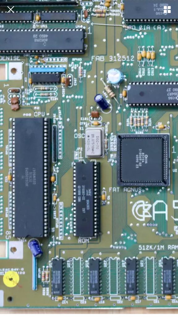

Here is a pic from the board. It should be a full PAL motherboard it was purchased from Germany.

Judging by the pic I posted can anyone verify if this is indeed an PAL motherboard?
From the picture I can see that both the Agnus chip and the oscillator are PAL versions

Thanks for the confirmation :)
